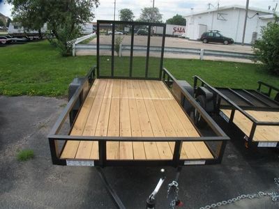

Now that I'm using rear attachments on my lawn tractor,I need a longer trailer.The tractor and heaviest attachment weighs around 1200#.The 10ft trailer I'm considering is 2000GAWR and the payload rating is 1320#.I like the idea of this lighter duty model compared to the 3500# A-frame trailers as it's lower to the ground w/13"tires for easier lower angle loading,and the lighter weight trailer would be better to pull around the property with the tractor for tree trimming jobs and so on.
OK-Not OK?

I ended up getting a heavier built trailer.The light duty trailer was a Carry-on brand and was really flimsy.I grabbed the front corner and shook it,and watched the opposite rear corner flap in the breeze.For 250 more I got a much better trailer that has a fold-in gate,powder coated,and the 2" flooring is No1 KD to 19.Nice welds,good quality.Brand is Sure-Trac,built here in my home state.
Thanks for all the good replies.

   / OK to use trailer at max payload limit? #9
That trailer looks like what I have except it not powder coated. Very nice trailer.
