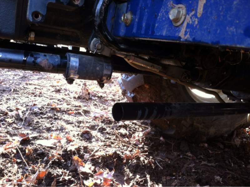

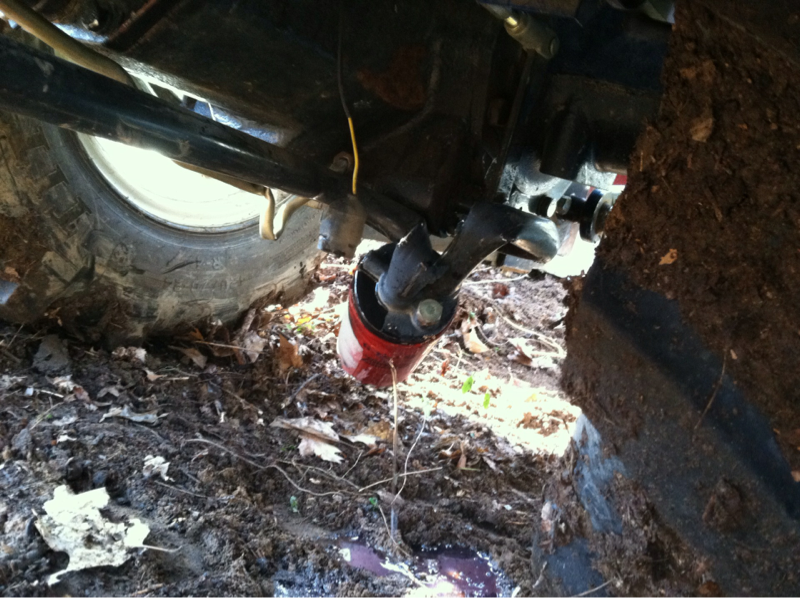

Ok...so I suppose I might have been a bit too aggressive while plowing down a tree and have managed to rip out part of my hydraulic system.
Can anyone tell me what these parts used to be and where I might best find their replacements?
This is a 360DTC by the way....
Thanks for your help! I love this forum.....

looks like fluid return pipe and hydro filter. Look online for parts. I have seen some links for ads on this site,

NAPA will have the filter - you should look for one for a FT 360DTC or a Montana 3840
You may also check with a dealer if you have an LS dealer in your area. LS made the 360DTC.
Have you checked to see if you can put the pipe back in place? It may not need replacing if it is only bent.

Agreed that it looks like fluid return pipe and filter. I got my hydro filter I think at Napa. I may have ordered it from Ebay. Can't remember. There is a thread on this site that some of us were posting the part numbers for these tractors. Search for either 360 or 390 filters. Napa can cross reference the #s, but a few folks had already done some cross referencing to Wix and some other brands.
With that pipe bent that bad, I bet it will need replaced. You'll probably have to tear it out of there and take it somewhere to have it remade. The only thing is I think on that one pipe there is a place the filter screws into, so that will be difficult to remake.

Ok......199.41 in damage for 3 parts......not to mention replacing the filter and fluid....
I used the partsforfarmtrac.com site.....I'll let you guys know how they treat me!!
