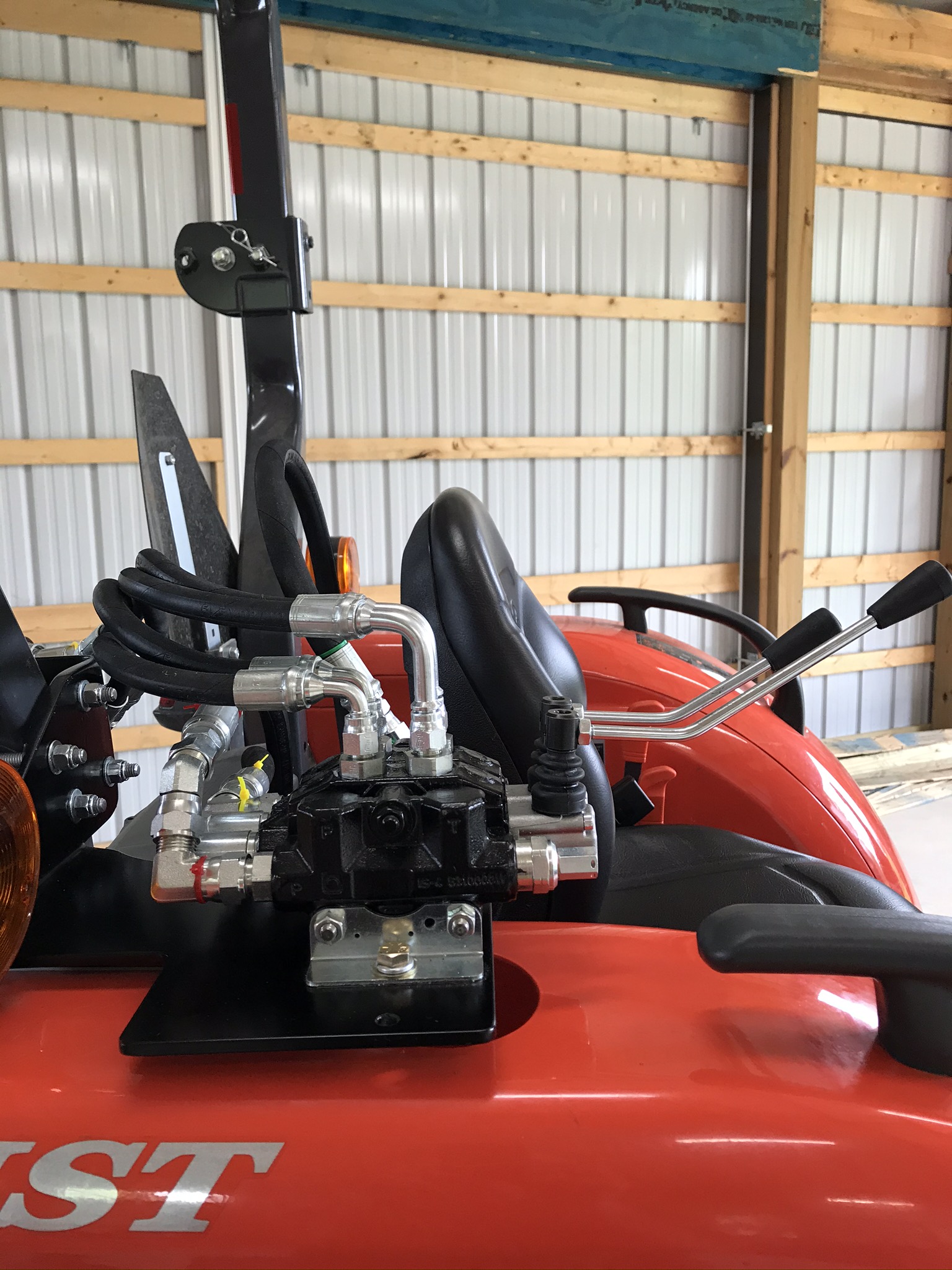

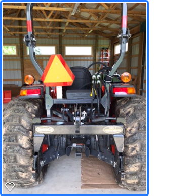

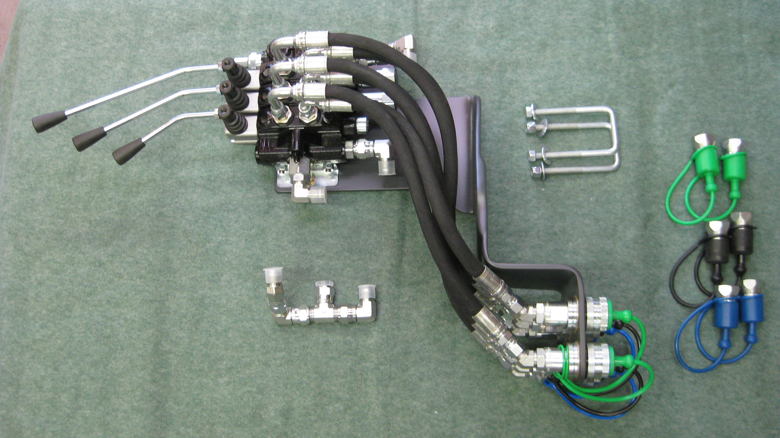

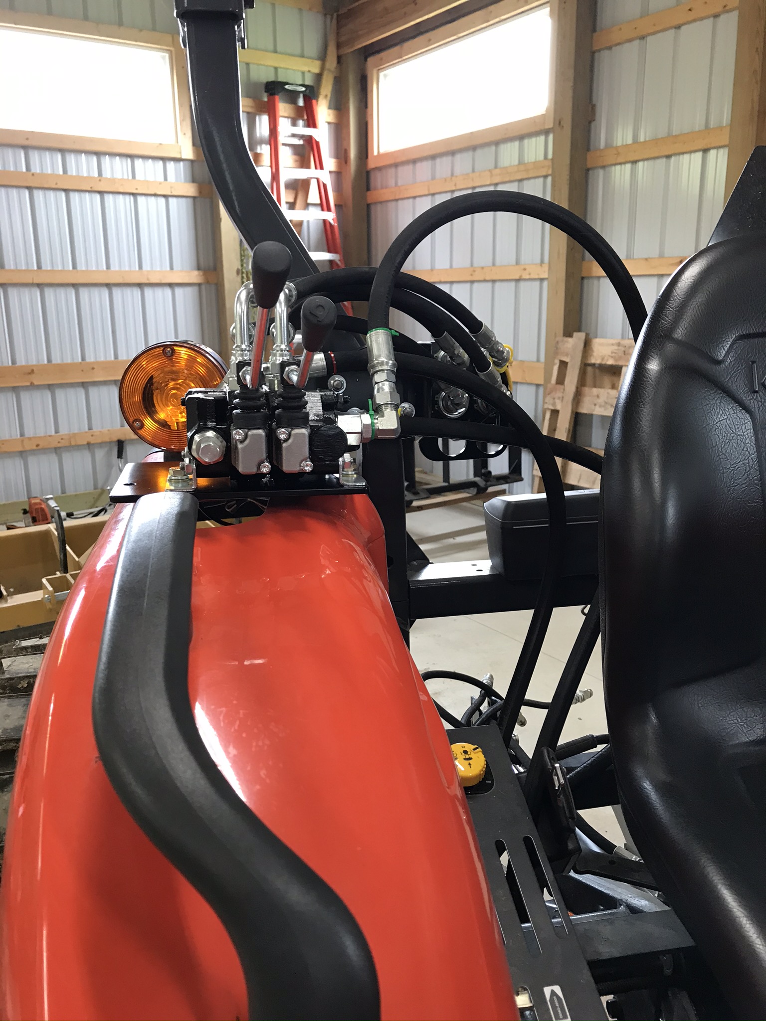

This is what I typically provide.
Bucher 12GPM stacking valves, (3 valves are most common, 2 w/float, 1 SRC)1 piece valve & coupler mount with 1/2" AG type breakaway couplers. Work port hoses. Customers typically have to source the 3 supply line hoses themselves once they have determined the routing they want and then measure for hose lengths. All of your fittings should be #8 JIC for connecting to the tractor.
The pictures are of an MX series and the customer just recently added a 3rd valve. :thumbsup:
Be careful about getting cheaper valves. There have been many people that have had internal leakage problems and you are on your own when that comes up. The valve manufacturers always seem to say that the amount of leakage is within specs. Best to get valves that are known to be a better quality valve IMO. ;)
I'm currently at about a 23 week lead time for the top & tilt sets, so if you are going to go with me, something to consider time wise. :scratchchin:

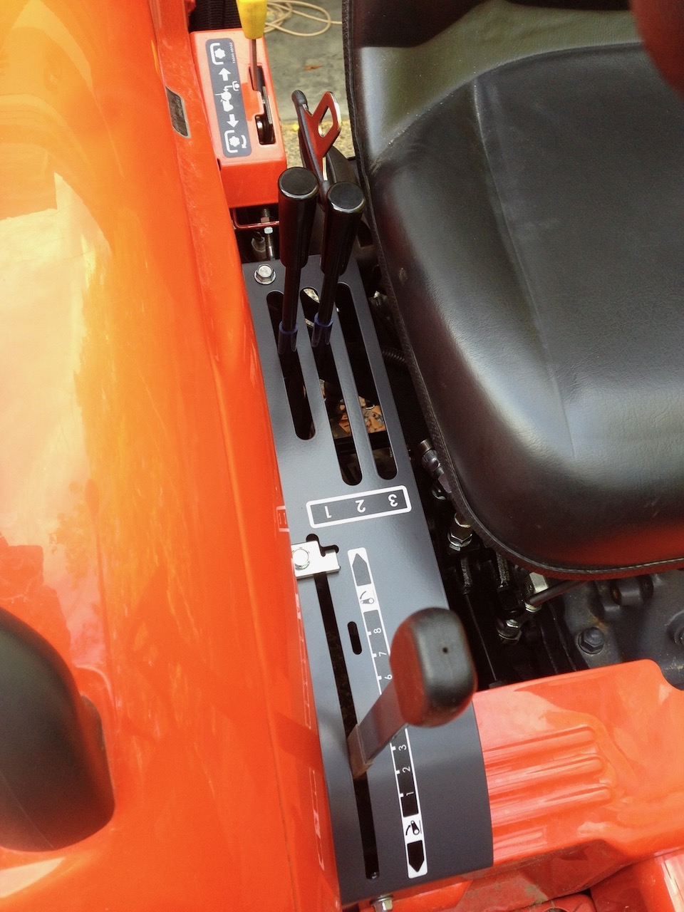

This is how the factory kit integrates the valve levers:
attachment.php

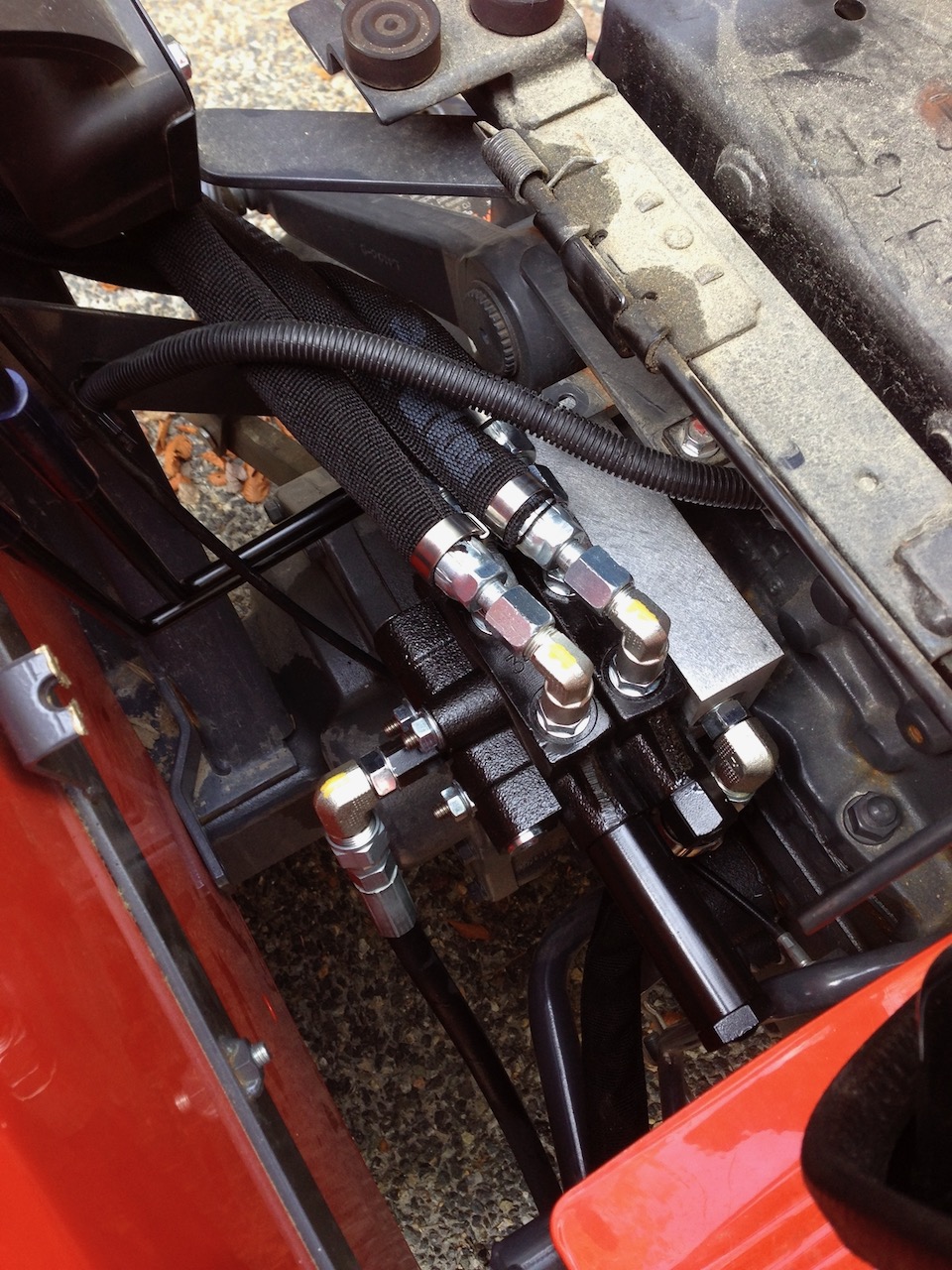

Valves go under the seat and mount to the side of the transmission case with a custom mounting block:
attachment.php
