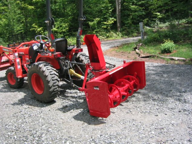

I just made the plunge after debating all the reasons you mentioned.
-Terry

If the snow is heavy and wet, no sub-CUT or small frame CUT is going to have either the power or the traction to PUSH very much snow. If you get considerable snows, FELs are very time consuming to use to remove snow. I find that a snow blower is the fastest easiest way to get the stuff off my driveway. My drive is short, but most of it is over 30' wide. I can blow it clear of 2' of snow in 30 minutes using a 3pt mounted 60" rear facing blower on a CUT, or I can do it in the same amount of time using a 54" front mounted blower on a Cub garden tractor. Front mount is easier to use, but typically costs 2 to 3 times the price of a rear mount blower. I think either tractor will power a 54" rear blower with ease, the front blower will be easier to use, but as you pointed out more expenisve. It might be worth getting a front blower if you have lots of regular snowfalls. I don't, so I didn't spend the money for the front mount on my CUT.
