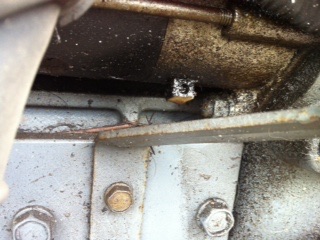

I have a kioti LK2552, today it started leaking a watery/oily fluid from the starter housing. It happens only when the engine is running. There is a small square protrusion from the bottom of the starter housing. There is a hole thru the protrusion. A steady drip of fluid comes from the hole in the protrusion. It is much lighter than the black engine oil.
Any thoughts???
   / Oily fluid from starter case #2
Input shaft into trans or the housing gasket holding the seal.

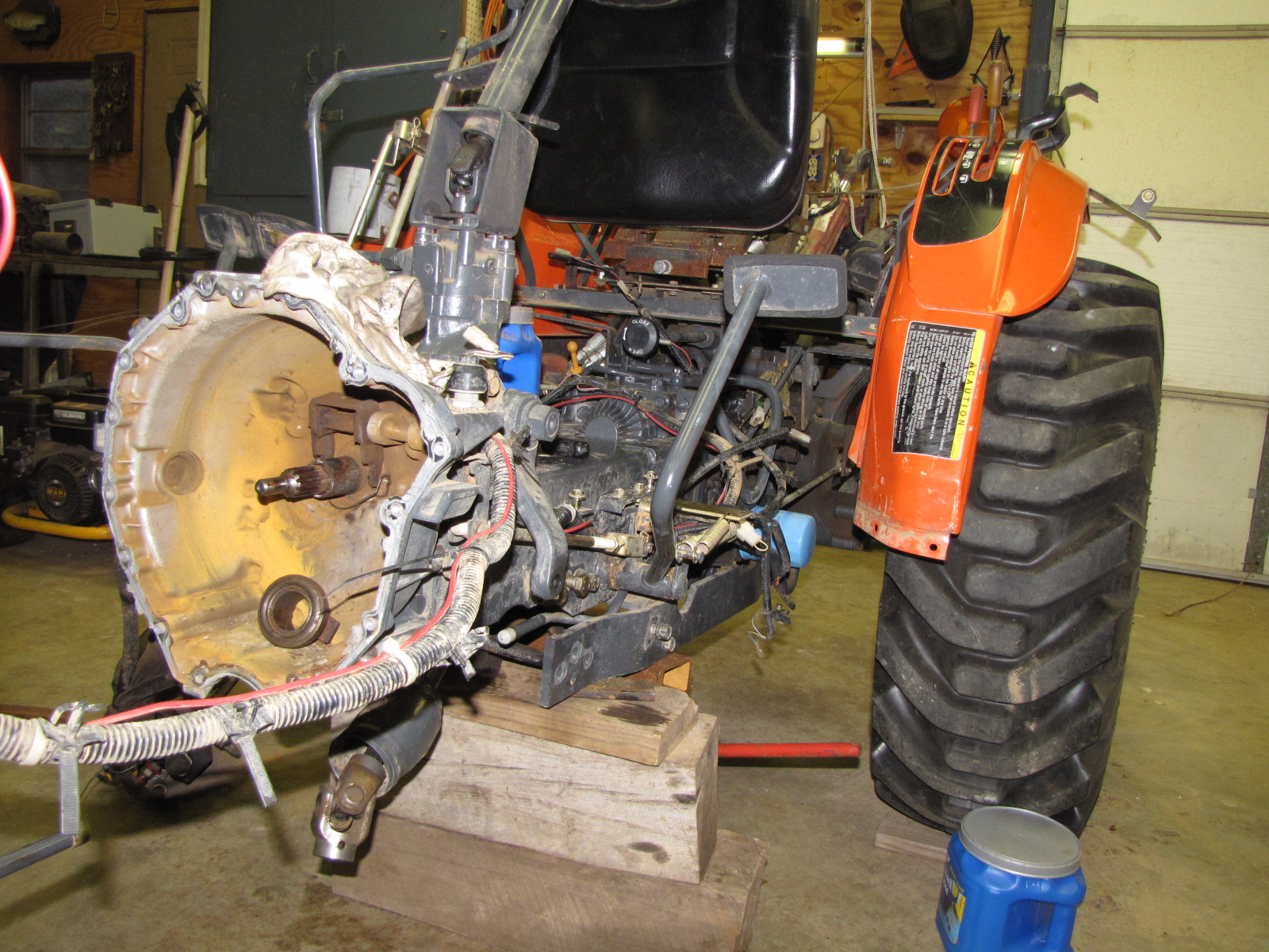

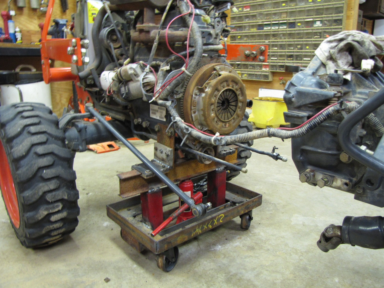

Tractor has to be split. Not a hard job if you have a way to hold the front and rear. It does cost a lot to split one. Here are 2 pictures of my B7800 apart.
