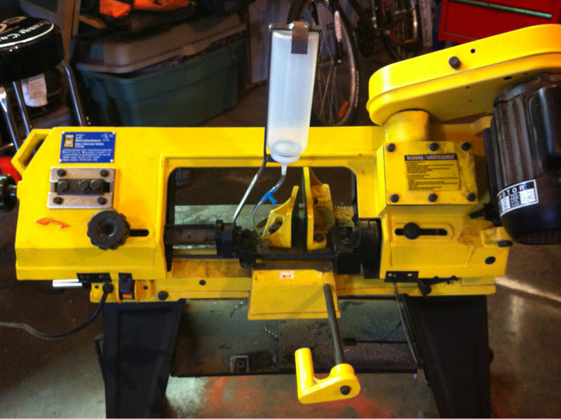

Here are a few pics of my modification
Still need to paint the bracket and test it out!
Not claiming I have invented the wheel just my version of this simple oiling system.
Tweaked the cut adjustments last night; looking good
Also notice the Lenox Diemaster II blade with 6/10 variable tooth count
Man this thing cuts good now

Looks Good..!!....Simple is great..!!
Just a thought, You don't need 100% oil for fluid......larger machines use 5% water-soluable oil mixed with 95% water.......it cools, lubes, cuts nice and 95% of the spills dry up leaving your machine not rusted

I'll see how it works; may need to add blade sweeps.
I was thinking of building a stand that would bring the saw up to a none back breaking height. May still do so!
Was planning on buying Lenox cutting fluid from Spectrum Supply online.
Thanks for the tip about the oil/water mix

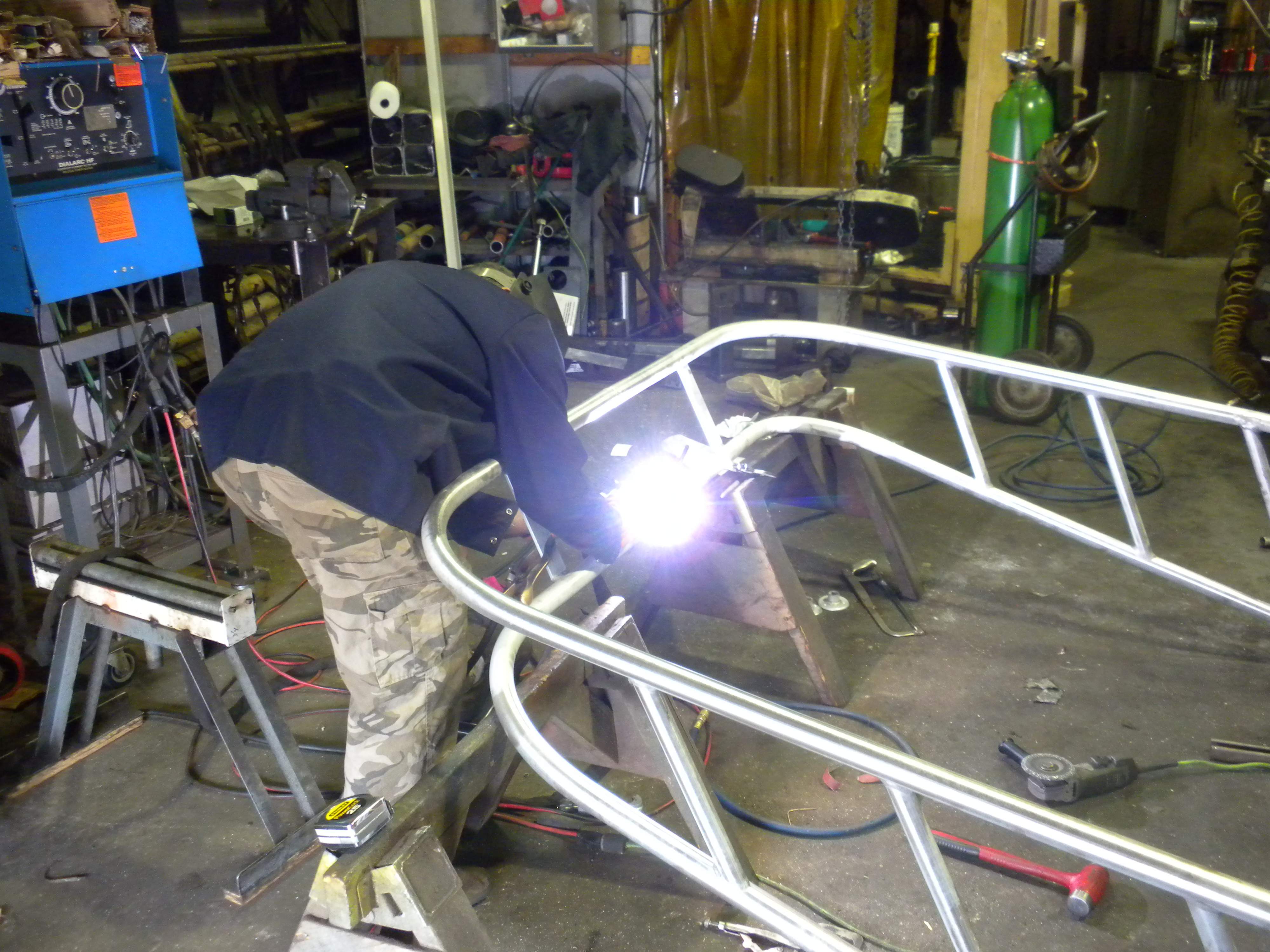

I don't know if it'll help you or not but I made a saw-horse type stand the same height as the saw table.......it has a set of rollers to allow long stock to roll while positioning for the cut.......We've had some serious weight on this stand and it is very handy......You can see the stand right behind me welding and the saw is just in front of the ox-acet tank inline with the stand....
That saw has a built-in coolant tank/pump005.jpg

Yeah I'm trying to plan/design for future upgrade and or needs.
Probably will make some type of coolant tank and a tubing system under that to put adjustable arms in to support work.
The saw horse roller type looks good for stationary cutting but I would like to wheel mine around when needed. My shop is only 28x28 so I leave most tools along the walls and wheel them out when needed.

Usually that roller stand is parked next to the saw for close cuts but is easily moved due to odd lengths of material.....wheels/casters is a great idea

Does the saw have a catch tray of some kind to keep the oil off the floor?

Not yet...
Just got some Lenox Band Aide fluid today (1gallon dilute 1:10 water) should last forever.
Was thinking of using a cookie pan or something similar till I decide if I want to add a pump and tank
   / Oiling system to a 4x6 bandsaw #10
I would, especially with diluted coolant. That stuff is designed to be used rather heavily in order to cool and lubricate. You really won't get the effectiveness if you just drip it on like you would oil.
