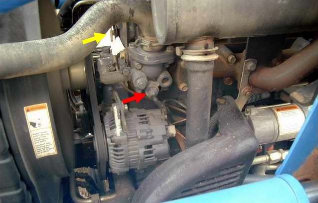

Vic, I was having trouble with my internet provider yesterday most of the day and did not see your post until this morning. Hopefully, you have found the problem by now. Anyhow, the oil pressure switch is on the top front of the engine. I think it's just above the water pump. The coolant temperature switch is on the left hand side above the alternator. I think if you look at the front of the engine you will see the oil pressure switch pigtail electrical wire that looks similar to the coolant temperature probe.
The oil pressure switch opens when the engine oil pressure is above 6 psi. With the engine off, you should be able to read zero ohms between the probe and ground because the switch is closed.

Checked battery terminals & the positive terminal had some corrosion on it. Cleaned up. Lots of power to headlights. When I try to start I see battery light, brake light & glow plug light. Just no oil light.
Tried to locate press switch but not totally sure if what I am looking at is indeed the press switch. You don't happen to have a schematic of the engine showing location do you. At any rate, even if the switch is the culprit I don't think that will get the tractor started.......agreed ?

Here is the photo. The yellow arrow points to the oil pressure switch and the red arrow to the engine temperature probe. Your TC35D will look slightly different. If you hook a jumper from the oil pressure switch to ground with the key on, the light should light on the dash.
When you try to start, are you hearing a click or anything else as you move the key to the start position? My starter sometimes does not make good contact in the solenoid. I tap on the starter with a crescent wrench, and it seems to start fine. I think my solenoid is slowly dying and that may be your problem too if you hear a click when you turn the key to start.

Many thanks for the photo. What-da-ya-know-about-that I was looking at the right location for that press switch. Exactly as you described. There is no discernable click what so ever......nada. I have moved the range selector including the other levers back & forth many times as I was trying to check the action of the safety switches. Noticed that about the range lever that there is no switch when I was expecting one.

Vic, the neutral sensing switch is on the left side of the transmission case under the operator's platform. There are two wires going to it. It's about 1" (2.5cm) in diameter. If you disconnect the wires you can test for continuity when the range lever is in neutral. Or if you are sure the range lever is in neutral, you
can just jumper between the two contacts and try the starter. That will eliminate that as the cause and you can continue looking.
I looked at my schematic this morning for the oil pressure switch. It is just a simple switch that provides a ground to the light circuit. If fuse #4 is not blown, I don't see how this switch could cause any starting problems. Fuse #4 is the instrument panel fuse and having other lights on there tells me that fuse #4 is still good.
I think I would check the ignition switch next and make sure it is working properly. You should be able to see 12VDC going to the starter solenoid when that switch is turned to Start. If not, then I think you need to remove the cowling and check the ignition switch.
