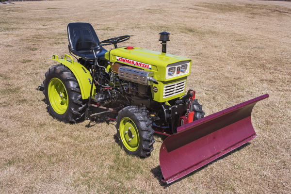

Yes it is low hours, tractor was not used much before I bought it. View attachment 492583
That looks to be a blade from a Gravely tractor made to work. Solid units and it fits nicely. Just a bit to stick in your memory bank if you ever need a wear edge or other items for it.
**Just saw you have had a 5650 Gravely .. no doubt you know what you have there then!**
