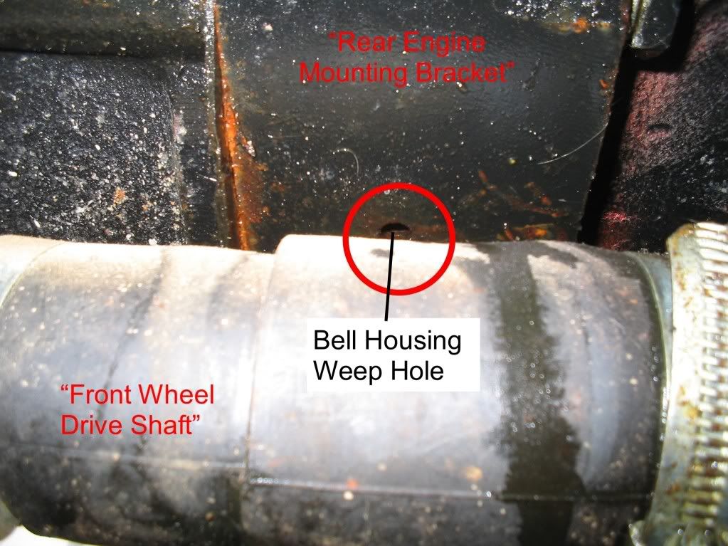

Here is the Weep Hole that RonMar mentioned.

Thanks for the picture been looking for that weep hole to make sure it was clean and just couldn't find it. Actually had to pull the drive shaft down a little so I could see it. Clean as a whistle -Ed

Then the oil isn't coming from inside the bellhousing. I suggest you look up. There should be a crankcase vent directly above the starter. Take off the top, fish out the mesh filtering element. Wash it with diesel fuel. Wipe the inside clean and reinsert the element. Power wash the side of the block and the starter motor housing.
This is one of those tedious little preventative maintenance items. Put it on your list.

Thanks Greg I wasn't having a problem with oil in the bellhousing but wanted to make sure that the drainage hole was open to allow moisture/condensation to escape. BTW how often should that crankcase vent be clean (hour interval)? -Ed

Sorry, I didn't realize that you weren't the original poster. It's there to let condensation drip out too. Since yours is clean/dry now - and it's the first time ever that you've checked it - one must assume it's not prone to plugging up. It's probably not worth the contortions required to inspect it daily. Perhaps when you check fluids, you might considser just runing your hand over the top of that drive shaft cover to see if anything has dripped outa the weep hole. If it comes away wet, no problem. If it comes away oily, find out why. Otherwise, I'd say make it an annual check to visually inspect that it's still open.

I have made it a part of my checklist whenever I change the transmission oil cause I am already under there with the drain plugs.
