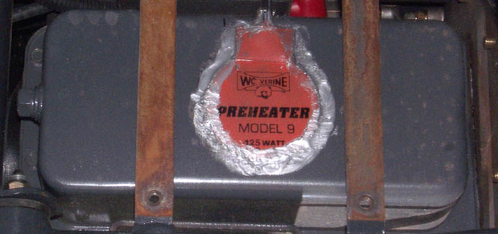

I installed an oil heater on my RTV900 yesterday - see attachment. I've already put these Wolverine stick on oil heaters on two of my cars over the last several years and they have definitely shorten the warm up times.
Even though it wasn't that cold this morning I plugged in the heater for about an hour and then felt the dip stick - nice and warm.
The heater was about $44 and shipping was around $8.00. Very easy to install.
http://www.janyce.com/wolver/heat.html
Edit - I'm thinking that the Model #16 would probably fit on the transmission and help get the Super UDT up to temperature faster.

A couple questions on this heater.
On the web page it says they're "peel and stick". Looking at yours, it appears there's extra application sealant around the perimeter. Did you apply something extra?
For the heater itself, how durable would you think it is?Strapped on to the bottom of the oil pan, it's going to take a LOT of abuse from scrapes, submersion, rocks, sticks...
How long is the wiring harness? Is it setup where I can pull up for easy access? (I'm thinking the plug should be somewhere around the top of the battery).
BTW - What is that flat steel stock going around your oil pan?
Thanks
Brian
   / Oil Heater for RTV900
Yes, it's peel and stick plus they include a tube of aluminum sealant to apply around the edge to seal out any chance of water getting in - not the prettiest but then again I went a little heavy on the application. These things don't come off. I've applied them on my cars two/three years ago and they haven't moved/lossened up at all.
It won't be subject to abrasion as the two metal strips (stock) you mentioned are the supports for a metal plate that you have to remove to install the heater. Once it's installed the metal plate goes back on with four bolts and it's pretty well protected.
To assure a solid attachment they give several recommendations on how to prepare the oil pan - just make sure it's clean and grease free. I placed the heater on by hand and then traced it's outline with a magic marker. Then I used a Dremel tool to remove the paint on the oil pan in that area and rough up the surface.
The cord is maybe two and a half/three feet long - I ran it up to just forward of the battery so I can reach down in there and pull out the plug to connect to an extension cord. They include a tie or two to secure it to the body along the way. They also include a a small squeegee to make sure the heater is firmly pressed in place.
Edit: It's hard to tell from the photo but there's at least an inch of space between the bottom skid plate and the oil pan. Plenty of room so the heater isn't touching the plate.

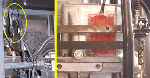

I did some more looking around and came upon another company that makes stick on heaters:
http://www.engineheaters.com/cgibin/store/agora.cgi?cart_id=8766536.26601*hi62y2%25%CArt_id%25%25&xm=on&p_id=154&ppinc=Engineheaters
They give a capacity for engine oil, hydraulics and water. It seems a heater will be adequate for a lot more hydraulic fluid than engine oil - maybe you don't want to heat the hydraulic fluid as much as engine oil - then again they're talking about tanks and not transmissions. Anyway it might be better to buy a smaller heater for the transmission than you would for the engine of the same fluid capacity. There's a smooth flat area on the transmission right next to the drain plug that's about 3"x 6". A 9.5 (Edit-9.1, not 9.5) Wolverine or a similar sized ProHeat (125W) would fit very well in that space. The 250W Wolverine or ProHeat are just a little too wide (3 3 /4") to fit entirely in the flat area and would have to curve somewhat for that extra 3/4" to fit.

Sorry - I've been on a business trip to sunny Miami since last Saturday. Just got back today and the ProHeat 512 was in the mail. I'll probably try to install it tomorrow. I'll give you an update when I'm done.
I went with the ProHeat 512 because it's a quarter inch narrower than the Wolverine.

I installed the ProHeat 512 on my transmission today (see attachment) and it fit almost perfectly. It was a little hard to prepare the transmission surface as the support bars for the skid plates are in the way. I ran the plug up to the same spot I used for the engine heater. An advantage to using the Wolverine for the engine and the ProHeat for the transmission is that they have different style plugs/cords so I can tell which one is which.
If you order a ProHeat you may want to call the order in as their web site is not secure.
