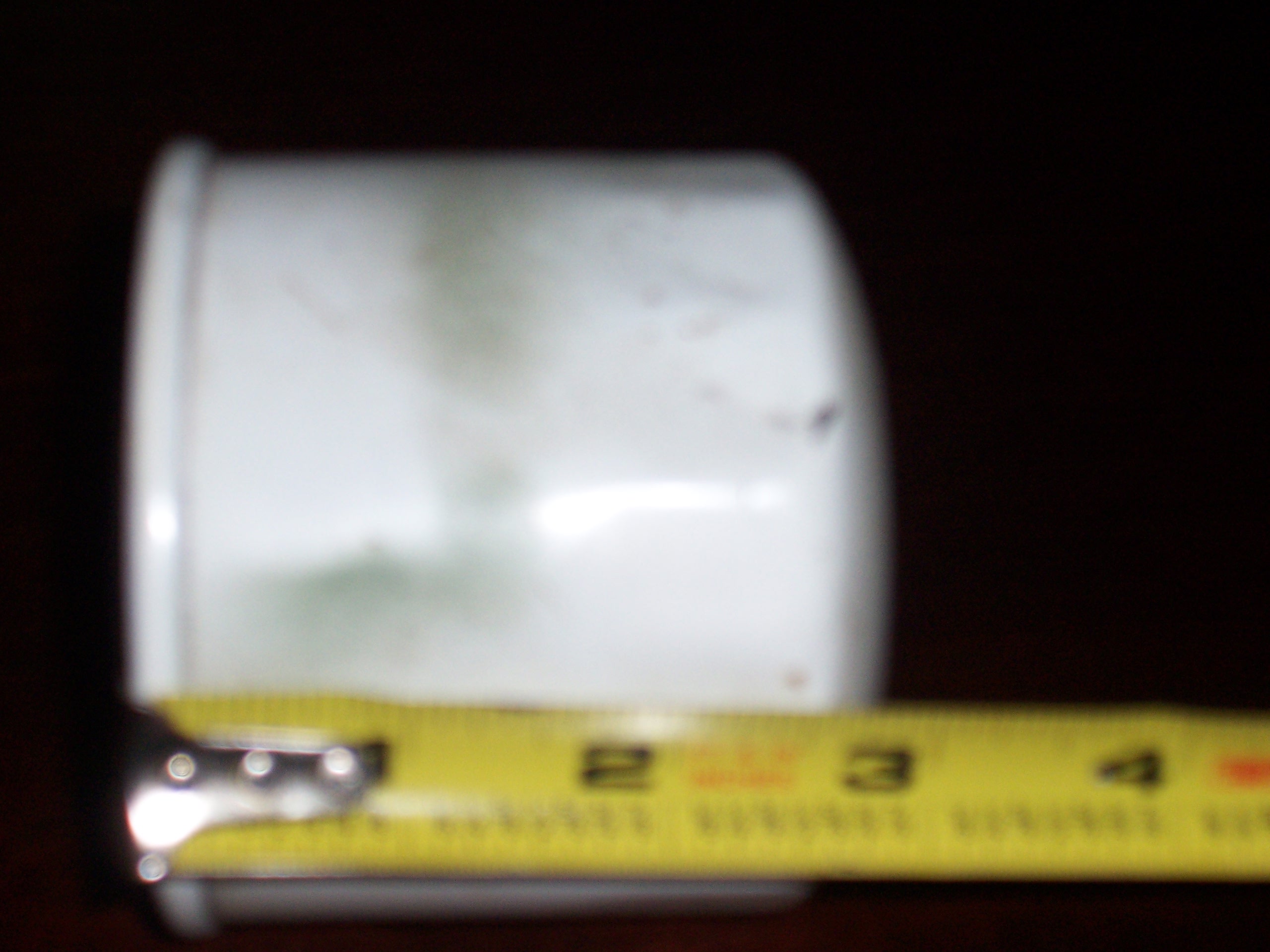

anyone ever use Fram PH3593A ? A friend on mine gave me a few oil filters he was throwing out . Several had this part # I changed the oil in the tractor and thought I would give it a try. It fit ,so this is what I will use until I run out of them

I suspected that Fram filter is the one listed for nearly all Subarus since forever so I googled on 'Subaru Fram PH3593A'. Yep that's the one. 70's and 80's Yanmars and maybe newer use that same Subaru/Toyota/Nissan/Mazda filter. It's near universal for typical generic small Japanese engines. If I were you I would use them.
I think '31____PS 2600 RPM' translates to '31 horsepower @ 2,600 RPM'. PS is German for literally horse power so I assume it means SAE hp same as American engine ratings. However Japanese Yanmars rate their hp at the PTO output, so the tractor's raw engine hp will be about 5 more.

Thanks. I plan to use them up. I just have never seen this oil filter # posted B-4.
I have assumed it meant 31 hp at 2600 RPM. I just never knew what PS meant. Thanks

Just uninformed opinion here for what its worth -
I've seen these filters discussed in Subaru groups and I'll summarize what I've taken away from all the talk: There are full-length, Hoye-size, and short versions that will all screw on to this industry-standard mount and will filter ok. Short ones come up to full oil pressure faster, and should be changed at more frequent intervals due to less filtering surface. (Most engine wear occurs in the moment before oil pressure comes up so a small filter that fills quickly is better in this aspect).
Longer filters cool the oil better and contain more oil as well as have more filter surface area, so are better suited to equipment that will be run hard.
Quality of the drainback check valve inside the filter should be irrelevant for the Yanmar operator who always cranks with compression released until the oil light goes out.
And finally the pressure relief spec relates to a plugged filter that bypasses. I hope nobody here lets their oil get that saturated with crud! Most of us don't put a lot of hours on per year so we aren't likely to see plugged filters if we change at reasonable intervals.
So - my opinion is: the quality of the filter is relevant, but any quality filter made for that common family of Subaru/Toyota/Nissan/Mazda applications and is made to modern quality specs, will be fine.

California that was an impressive post! When I uploaded my post it was to see about the pressure check valve and such. You answered all my questions and more. The filer size was interesting. I have been running the long filters because I wanted the increased surface area and increased oil capacity. Just curious though, does that Fram 3593 come in a long version? Anyways thanks California.

I don't think this filter # has a longer version. It may in a different #.
It appears there are many filters that fit these tractors. I have a list in my garage but this filter # wasn't on there.
I had no idea hoye sold a longer version. The only filter I found that was longer and larger was a NAPA/Wix filter 1568. (about $8.00 ea)
Since I was given these,(about 4-5) I will use them up.
