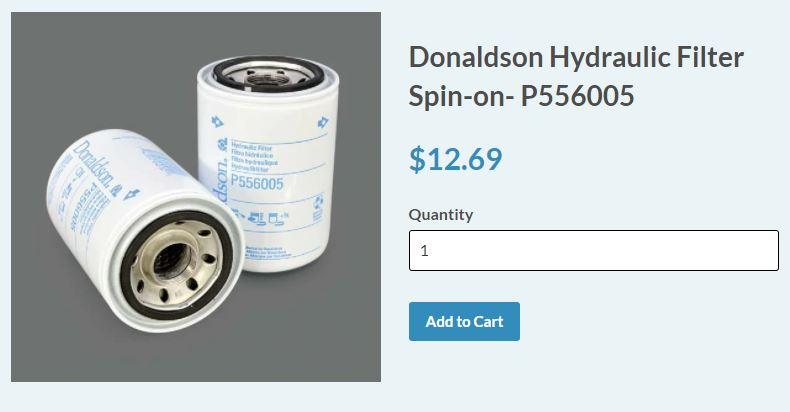

Oil Filter - Donaldson P556005 - is it a good one or is there a better alternate?

of the quality, prob so, but i don't have any experience with that manufacturer. the importance is to do the homework on cross referencing the manu specs, namely micron size, etc. very critical in hydraulic systems. one of my mowers calls for 5 mic, my other zero turn 25 mic i believe. once that's established, would have no hesitation using that hyd filter. you might check reviews if you bought online...
so in addition to finding a compatable cross reference filter #, double check that the micron specs on the filter are the same as manu. recommends.
i use Stern hyd filters from Jacks Small Engine, regards

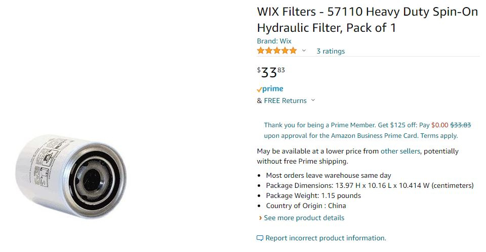

I didn't realize the Napa branded filter were simply Wix filters with the Napa paint/logo added.
MASSEY-FERGUSON 3703386M1
CARQUEST 84110
NAPA 7110
Wix 557110
Wix 57110
Went with the Wix 57110 from Amazon, $33.83 with free shipping, supposed to arrive Friday. :)

Donaldson makes Motorcraft oil filters. Good quality.
