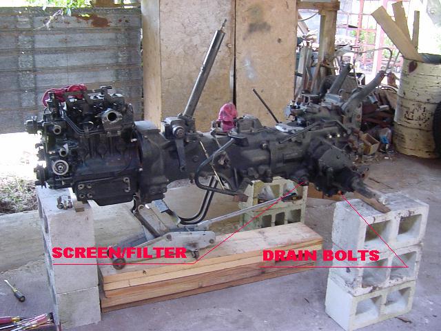

Thanks for the replys but I think this may change the problem. I looked at this oil and come to find out it isnt engine oil like I thought. It is the hyraulic/trans oil that only starts to drip out of the starter after a couple hours of use. I checked my hydraulic fluid level that is located at the shifter and it is way to full. I have never added or changed that fluid and I think it needs to be changed since the color just doesnt look right to me. Any of yall know where I drain that fluid out at??

Danny:
See pic
Just bellow the rear axel's on both sides you will fine one bolt each side that a little bigger than the others, thats your drain.
One more thing.....theres a screen (filter) that should be cleaned while you have it drained, left side just infront of the rear tire...three bolts in a triangle pattern with a big drain bolt in the middle.
Sidebar, the two bolts I mention first are a better spot to drain.....there lower on the tractor. Anywho, thats how I do it on mine and I think the gray markets are the same...maybe someone will chim in here and correct me if I have lead you astray.
