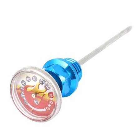

I have a 3016 shuttle shift and to check the oil I have to remove one side of the engine cowling. Has anyone attempted to build or install some sort of extension for the dipstick tube so you can easily check the oil without removing the cowling?

It can't be that hard. Anyone have any pictures of the area and dimensions of the tube? Does the original use a flat or round rod? Many of the long oil/trans rods use a stiff wire with a scale added to the end. Some use a flexible flat rod but these are harder to use if there's more than one turn or angle in the guide tube. I wouldn't try to add extensions. Just replace the entire tube and rod. It's called non-destructive conversion. You can always go back to the original if necessary. And you may need it to index the new rod.
Start by determining how the tube enters the crankcase. Is it press fit or tabbed with a hold-down fastener? Most are just press fit. Next, determine where the handle will be. The rest goes in between. :)
   / oil dipstick extension
Thanks, I will check it when I get back home. Didn't know how much trouble it would be to physically replace the tube. The original is a flat "rod" that is only about 6-8 inches long. Figured whatever I replaced it with, I would have to cut and customize the dipstick.

It might be easier to modify a motorcycle oil level gauge with the proper grommet sizing. This way you'd know at a glance about your oil levels without having to touch a thing.

I don't doubt you could pull out the stick with some contortions, but how can you replace it down in that black hole it calls home?
