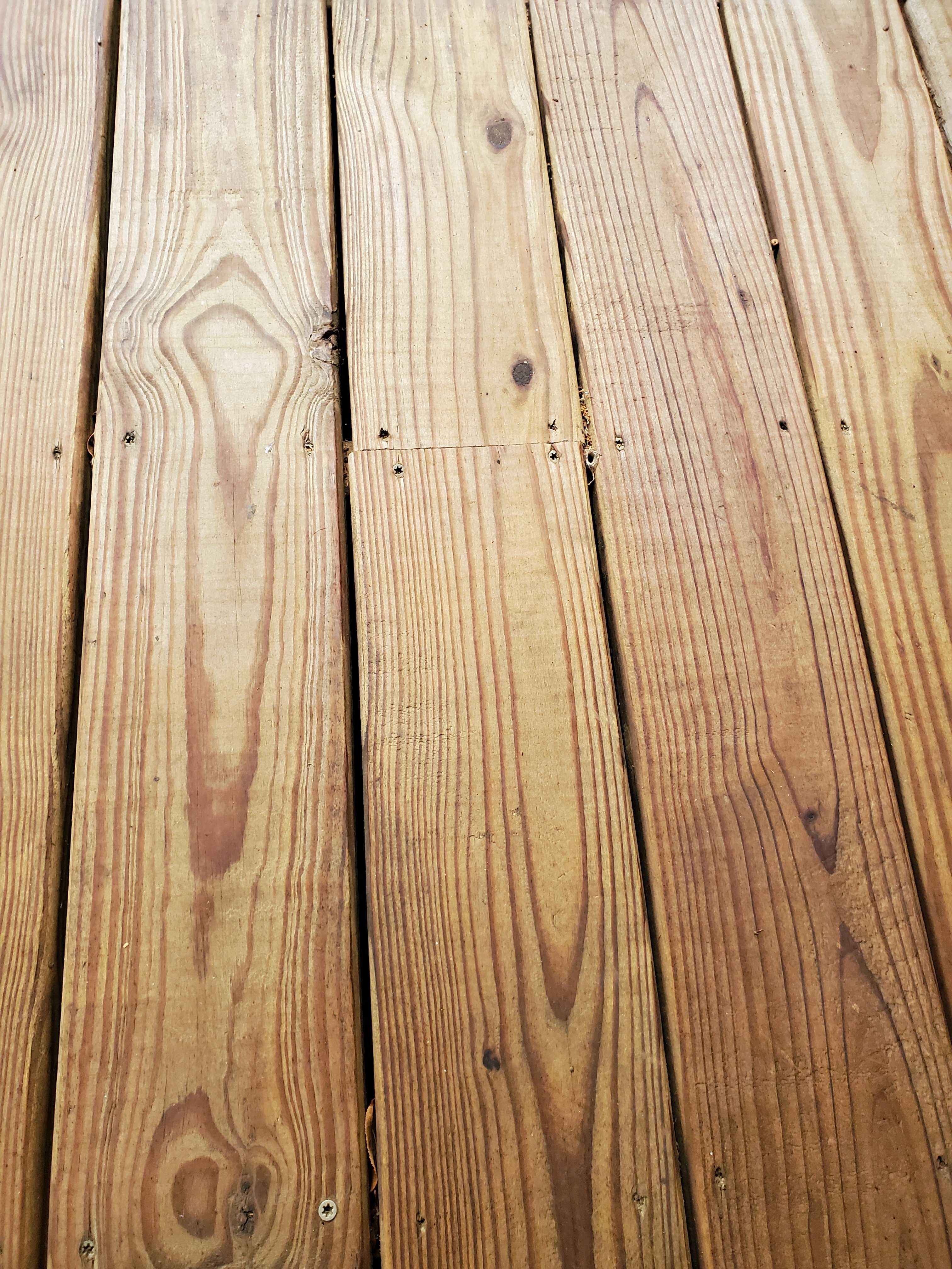

I have rather large wrap around deck on my house
Every year i pressure washer it and seal it with Thompson's® WaterSeal. It lasts about 6-8 month and then by the next spring the deck looks like crap and i need to do it again.
There are discussions about trailer decks treated with mix of motor oil and diesel, but could not find anything about the house decks.
Any PROS or CONS using used or new motor oil and diesel mix? Does anyone have experience doing it at his/her house?

Two years ago we built a new deck on the house. I waited a few months and then coated the entire thing with this:
It has a 3 year guarantee.
This year, 2 years in, I bought Thompson's Water Seal and just did the floor and tops of the hand rails only to give it a little more protection. The flat surfaces get blasted by the weather more.
Applying the Thompson's did not go as planned. I tried a new sprayer that I also got at Lowe's that was labeled as being for decks. It didn't work. I tried all the included nozzles. No dice. So then I tried to roll it on. That was not efficient and was going to use too much product. Thankfully I have an electric paint sprayer and so I tried that and it was perfect.
