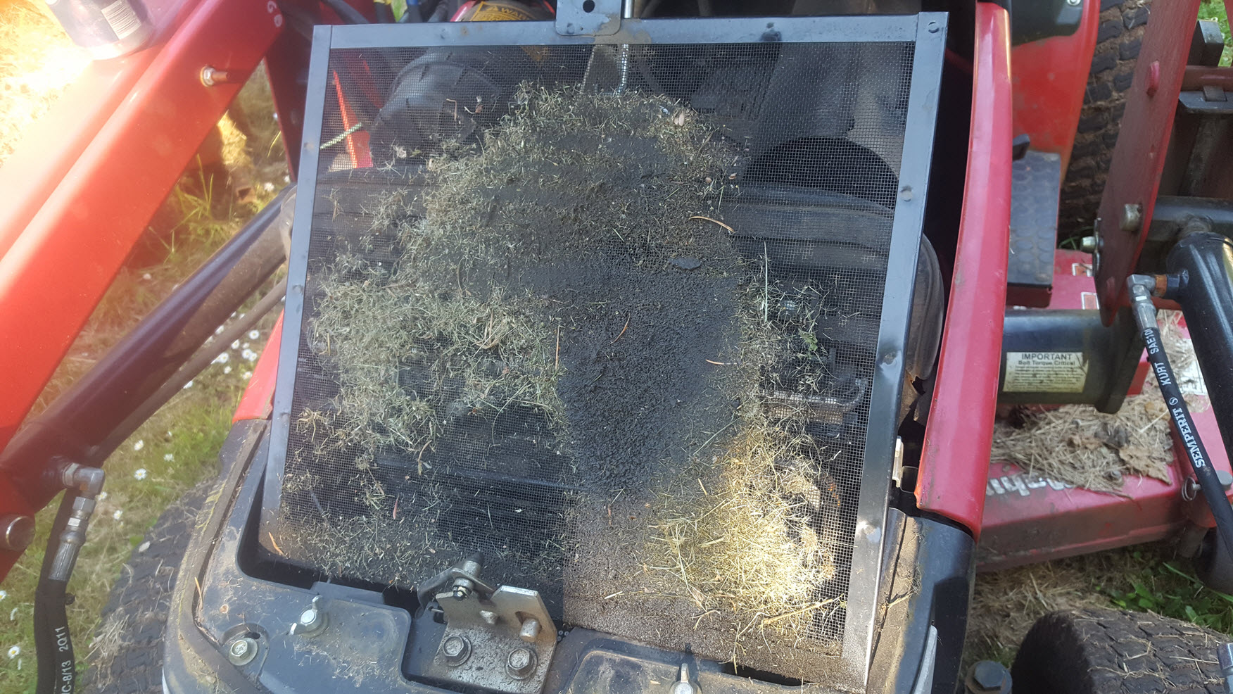

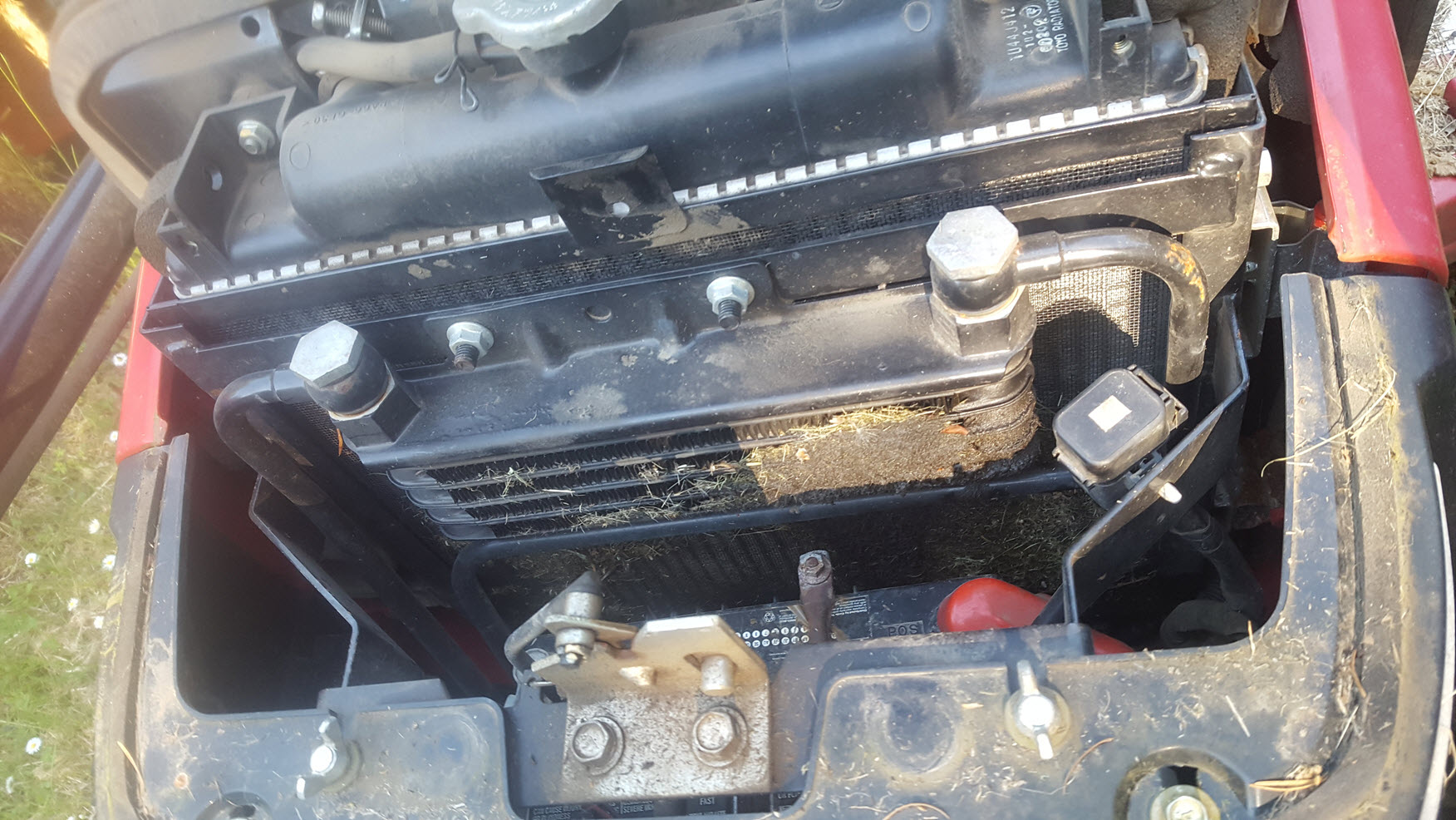

I have owned ol Max for 5 years now this month. While doing my preop before a mowing job I find this little surprise:

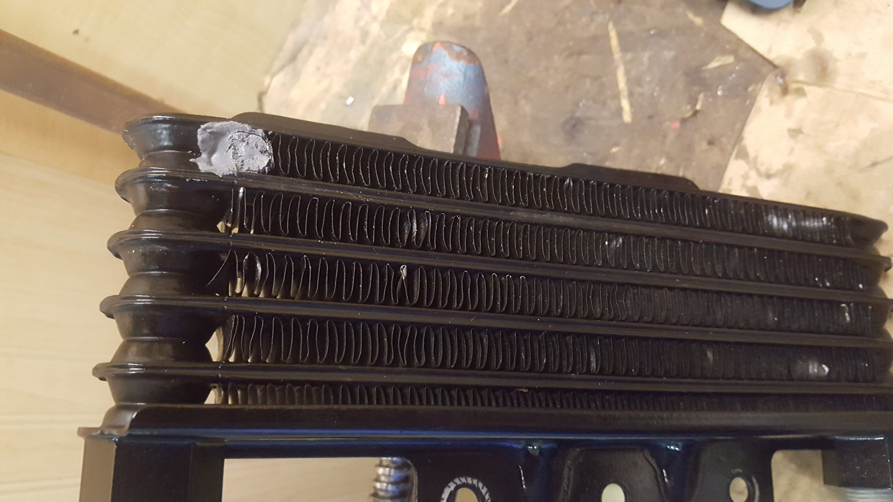

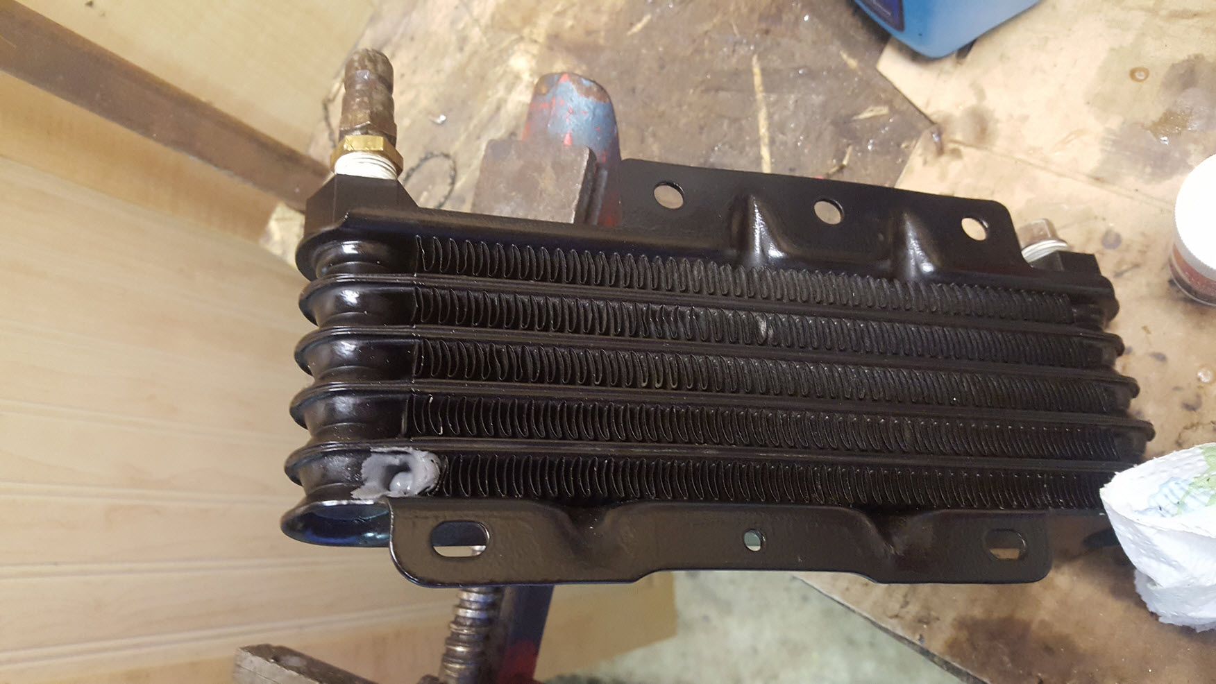

So 2 bolts and 2 banjo fittings and the cooler is off. I clean it, drain it and put a plug in one end and an air fitting in the other to pressurize it with air to find the leak in a bucket of water. Bingo! I hit it with a tiny carbide bur on a dremel tool to get to bare metal and lean the surface well with solvent. A dab of high temp JB Weld to the rescue. Bobs your Uncle! We shall see

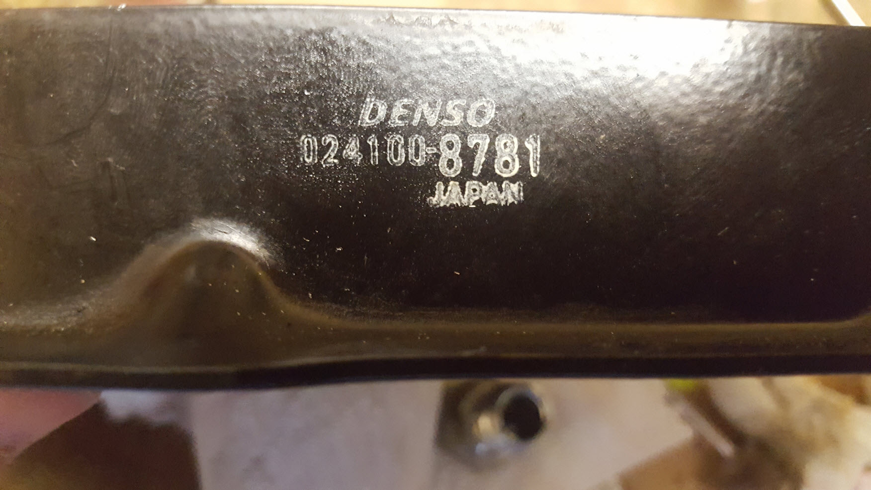

Now I知 not the smartest guy, but c知on $400+ for an oil cooler?!?!? I couldn稚 cross the Denso part number printed on it to anything else, but found several that should be suitable replacements if not better. There are tons of them out there OEM and aftermarket.

I would call Denso North America and see if they can get you the part based off of the 024100-8781 number. I was curious and Googled it but could not find it... If you have a really good NAPA store they might be able to get it from a supplier.

Already tried Napa. They were no good with their crossing of it or finding it in their Denso database. But I'm not done searching either. Its not easy finding a universal cooler with M16 ports. But I did find out its EXACTLY the same part number for the cooler for a 7000 series Cub Cadet: MA-19632556000. Its around $240. Much better!

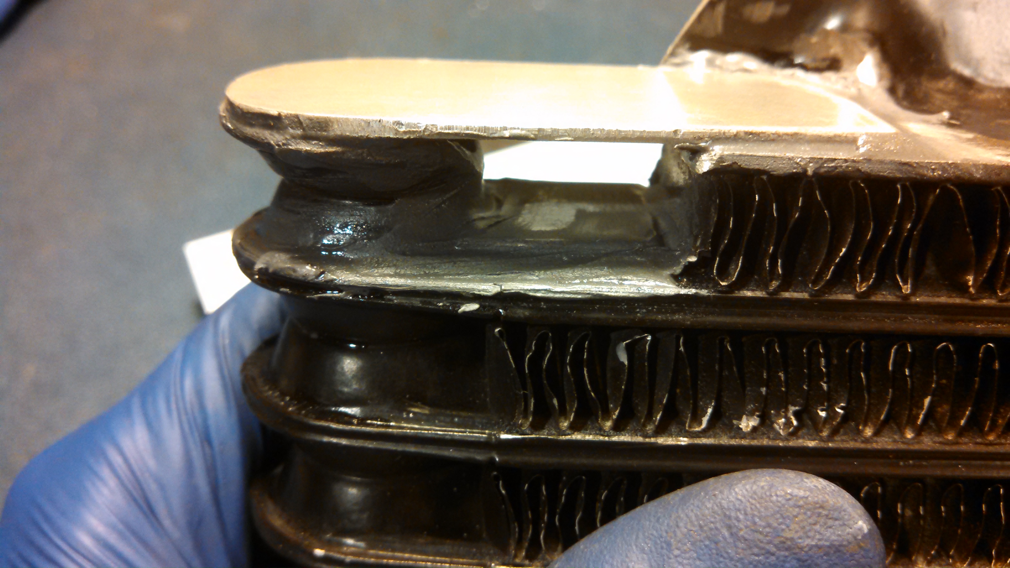

I found this post while looking for cross refs for this same oil cooler on a Max 25 HST.
I couldn't find any alternates either. $300 and a couple of weeks wait.
It's kind of crazy, since these type of heat exchangers can be had for $60-100, but those have different fittings or were slightly different in size.
I find it interesting that your oil cooler failed in the same spot that ours did. I wonder how common this is in these stamped-tube oil coolers.

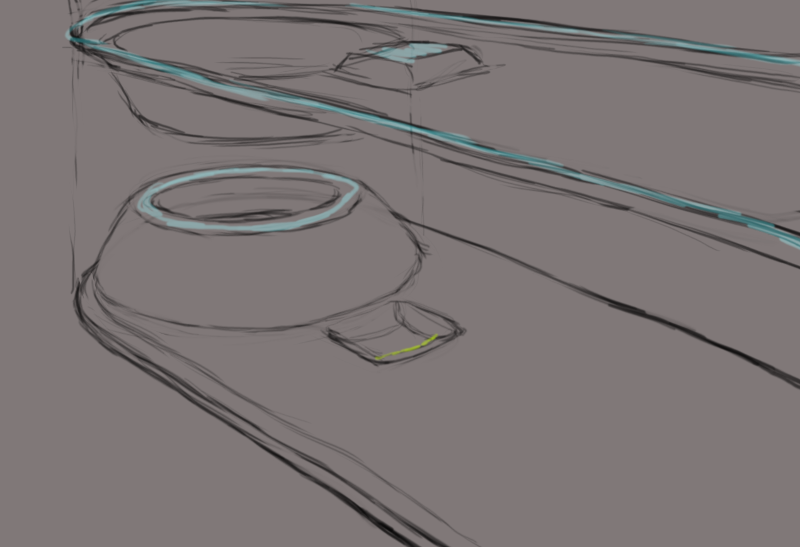

I didn't expect the cooler to be repairable, but after replacement, I was free to at least look for a cause of failure. I cut a section of the bottom bracket away and filed down the fin remnants so I could get a good look at it. With the bracket cut, I was able to actually get a 10x magnifier on the area to find the leak. I wish I had taken pictures of it when I had it cleaned up and marked out, but I didn't think of it until afterward. A illustration might help:
There was a hairline crack along the base of a depressed feature in the tube structure (yellow). Given the location, I find it hard to believe that the crack was the result of vibration fatigue (I'd expect cracks near the top instead). My guess is that it may be the result of thermal cycling and/or localized stresses remaining from the manufacturing process. It leaves me worried that the replacement might be susceptible to the same failure. Only time will tell.
Given that the defect was so small, I figured a repair was at least good enough for a spare. I simply used JB Weld and an aluminum patch to seal the defect, and I patched the bracket just to keep it from flexing under vibration and cracking fins out if it went back into service.
If the replacement ends up failing in a similar manner, I'm inclined to modify the hardlines and bracket and replace it with something else.
