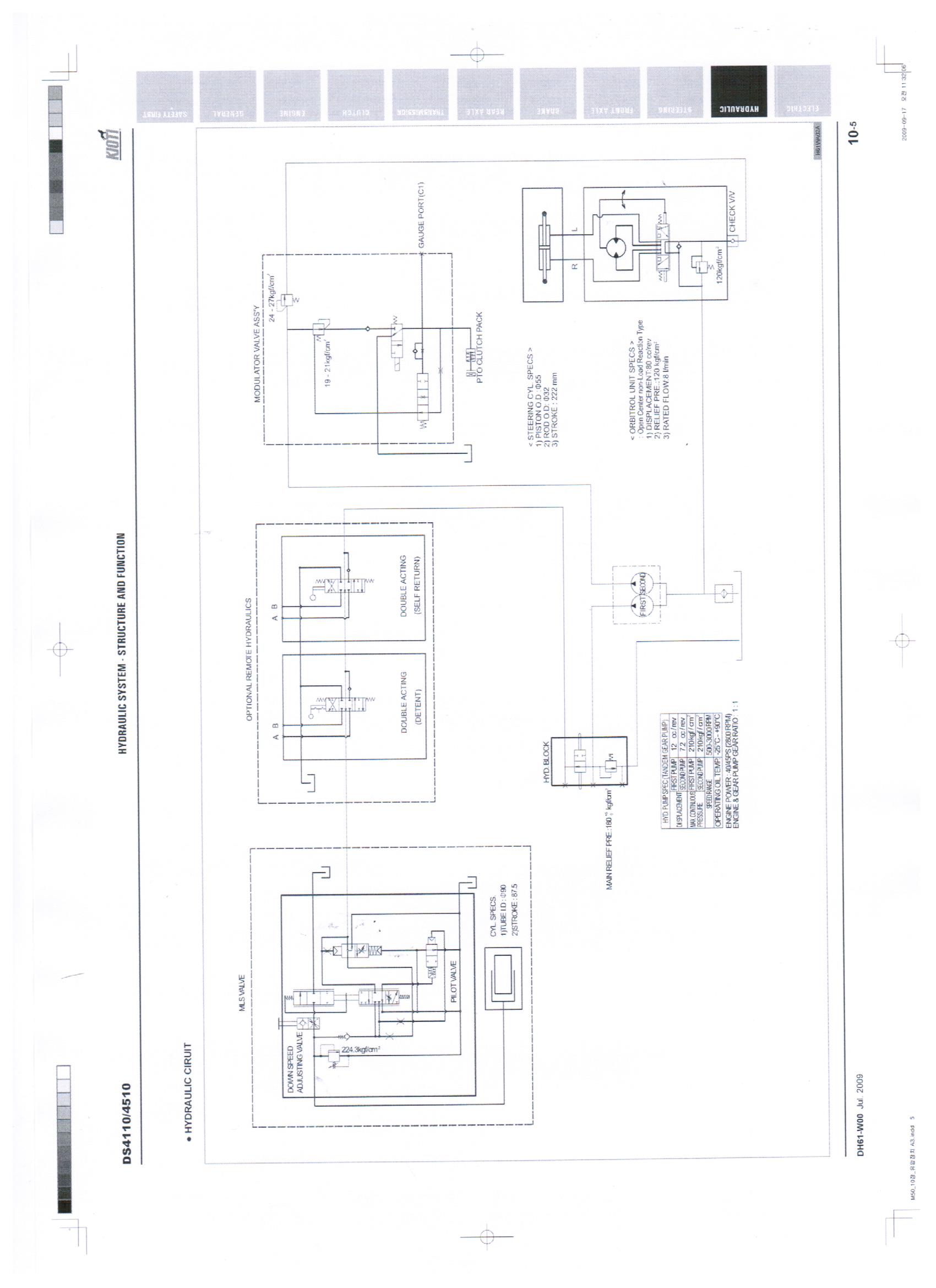

I want to add an oil cooler to my KIOTI DS4110 /DS 4510 which does not have one. What must be the choice of the points of entry and exit of the oil cooler in my oil circuit?

When I use the PTO for 1 hour in the summer, the temperature of the oil is over 90 ° C (200F). Result: oil smell + loss of mechanical speed (start of tightening ?!) back to normal after cooling. So I am looking for a cooling solution. (KIOTI DS4110: 200h walk without original hydraulic oil cooler)

Yes the tractor was bought new in 2015.The first years with original oil no problem, with same gyrobroyeur usited. The problem appeared in 2018 after the overhaul of the 130H.the dealer checked on his bench he says it's OK.However the hydraulic oil he changed is of characteristic : viscosity 88.75 / 40 ° C and 13.4 / 100 ° C so it is thicker I think the hydraulic oil KIOTI 57.5 and 9.35. My gyrobroyeur
1.50metre width rotary grinder requires a maximum power of 22kW - the PTO supplied a maximum power of 25.3kW / 540Tmn manufacturer. Maybe this oil would be too thick, would skate the PTO multi-plate clutch and raise the oil temperature?

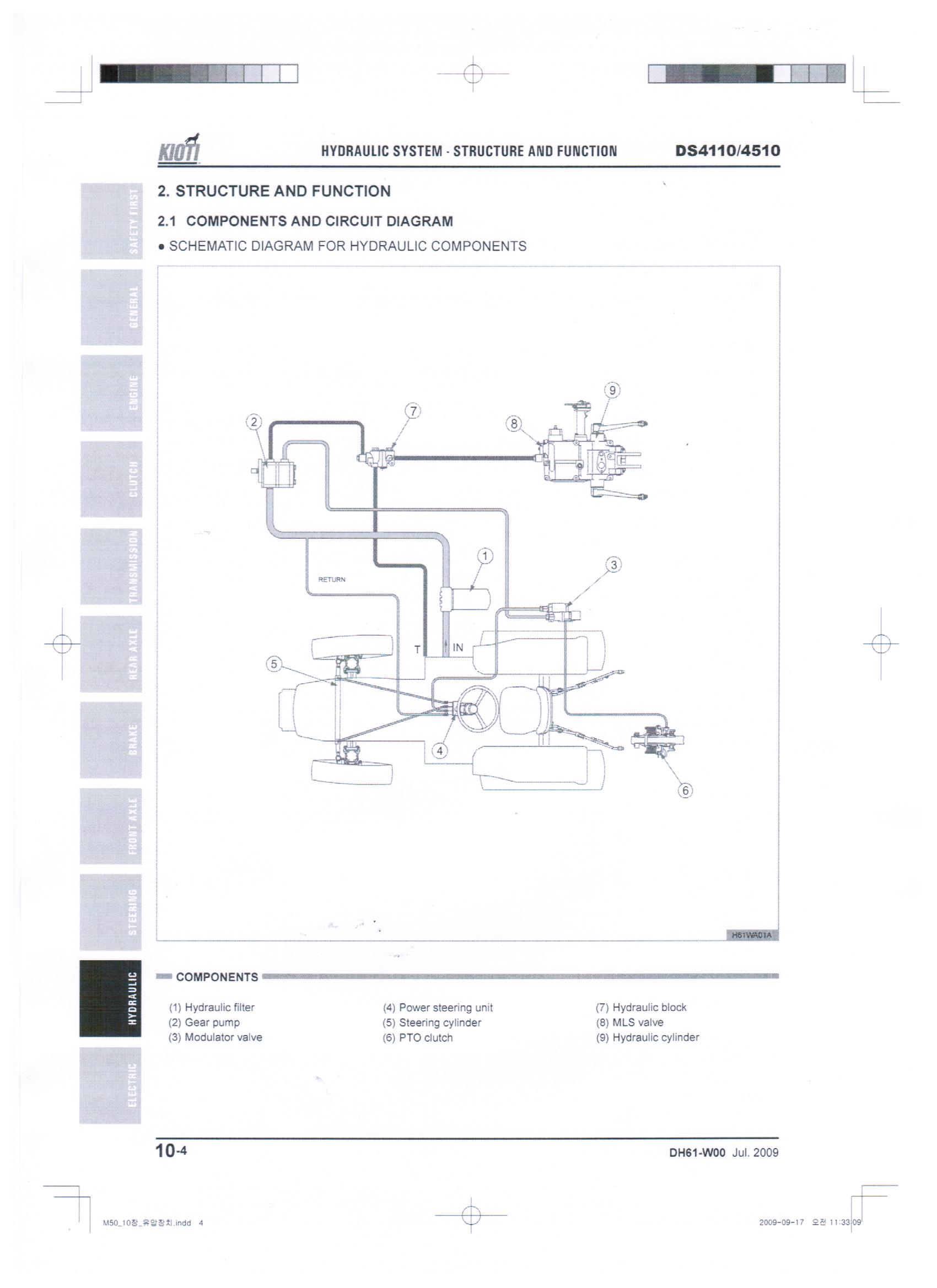

   / OIL COOLER KIOTI DS4110
I do not have a charger before.Seul rear lift.

   / OIL COOLER KIOTI DS4110 #10
Those Kioti tractors do have a hydraulic block would provide the flow for a loader if you had one. This block has a spool with a slot in it to be turned with a flat screwdriver.
If you turn it one way, the flow goes from the pump to the remotes and then 3 pt hitch. If you turn it the other way, it will go from the pump, to the loader valve and then to the remotes and 3 pt hitch. Since you don't have a loader installed, those ports are capped off.
I'm wondering if the spool on this block somehow moved and it's halfway from the position where it should be. Which would cause the restriction and heat since the flow is trying to go into a blocked way.
