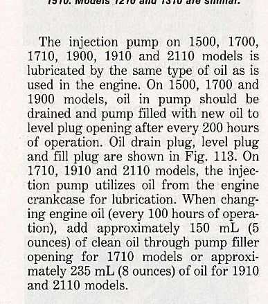

A thought on running rough and cutting out. Is your injector pump oil common with the crankcase? Over filling the injector pump will cause problems with running right.
   / Oil Capacity for Ford 1710
You're right, they do share oil. Any idea how to drain fuel pump or other fix?
Do you think I should worry about the dipstick reading vs published oil capacity?

Is there a way to drain the fuel pump? I'll check to see if there is a drain plug or bleed on the bottom.
Being shared / common oil, it should drain down as you lower the crankcase level.
There are several 1710 owners here, hopefully one of them can measure the distance from the oil Add/Fill line to the point where the dipstick seats in the dipstick tube / engine block and let you know what that dimension is. Not knowing for certain the level is right, especially since it's your injector pump (small resevior in relation to the crankcase capacity) lubrication as well, could be very costly.

I called the local New Holland dealer yesterday and spoke to their service department. He looked up the capacities and said the offset version of the 1710 takes 5.6 qt, the standard version (what I have) takes 5.3 qt. Bad info in the manual and apparently you are right about the 0.3 qt difference.
Regarding the fuel pump, they told me there is a drain screw on the side of the pump. Fill with oil from the top bleed plug until it drains out of the side drain screw and that is the proper oil level in the fuel pump.

Update: I drained a little more than a quart of oil to get it below the top end of the hatched fill area on the dipstick. Possibly still some old oil left in the crankcase? I noticed the new oil on the dipstick progressively get darker and darker until it looked used. I think I'll change again after a couple of weeks use and see what happens.
After starting, it still ran rough. Then adjusted the threaded stud on top of the fuel pump leftside by backing off a turn or two and it ran fine. Just took some adjusting.
Added some oil (5 oz) to the threaded bolt on top in the middle and called it a night.
Other than the mystery of the true oil capacity, I'll consider this episode closed. Thanks Square1, your knowledge and time are greatly appreciated. Stay tuned, I'm sure I'll be back with more questions.
