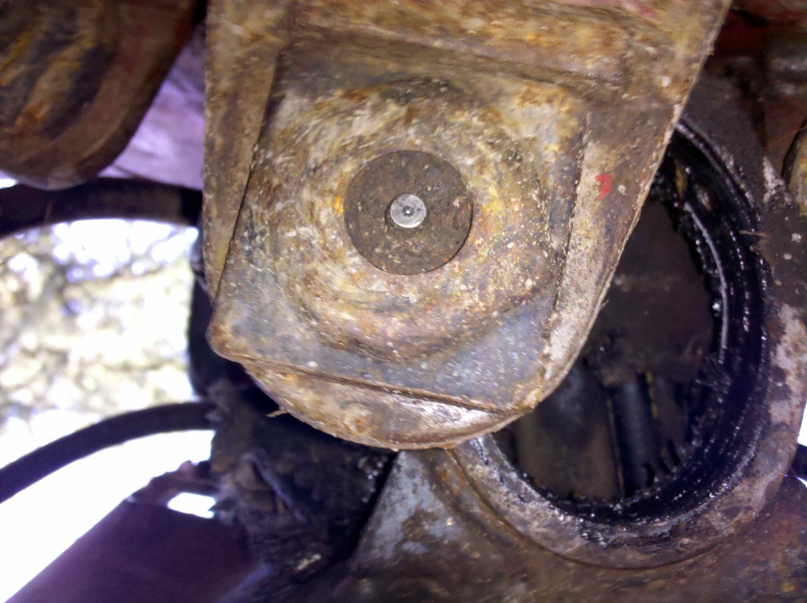

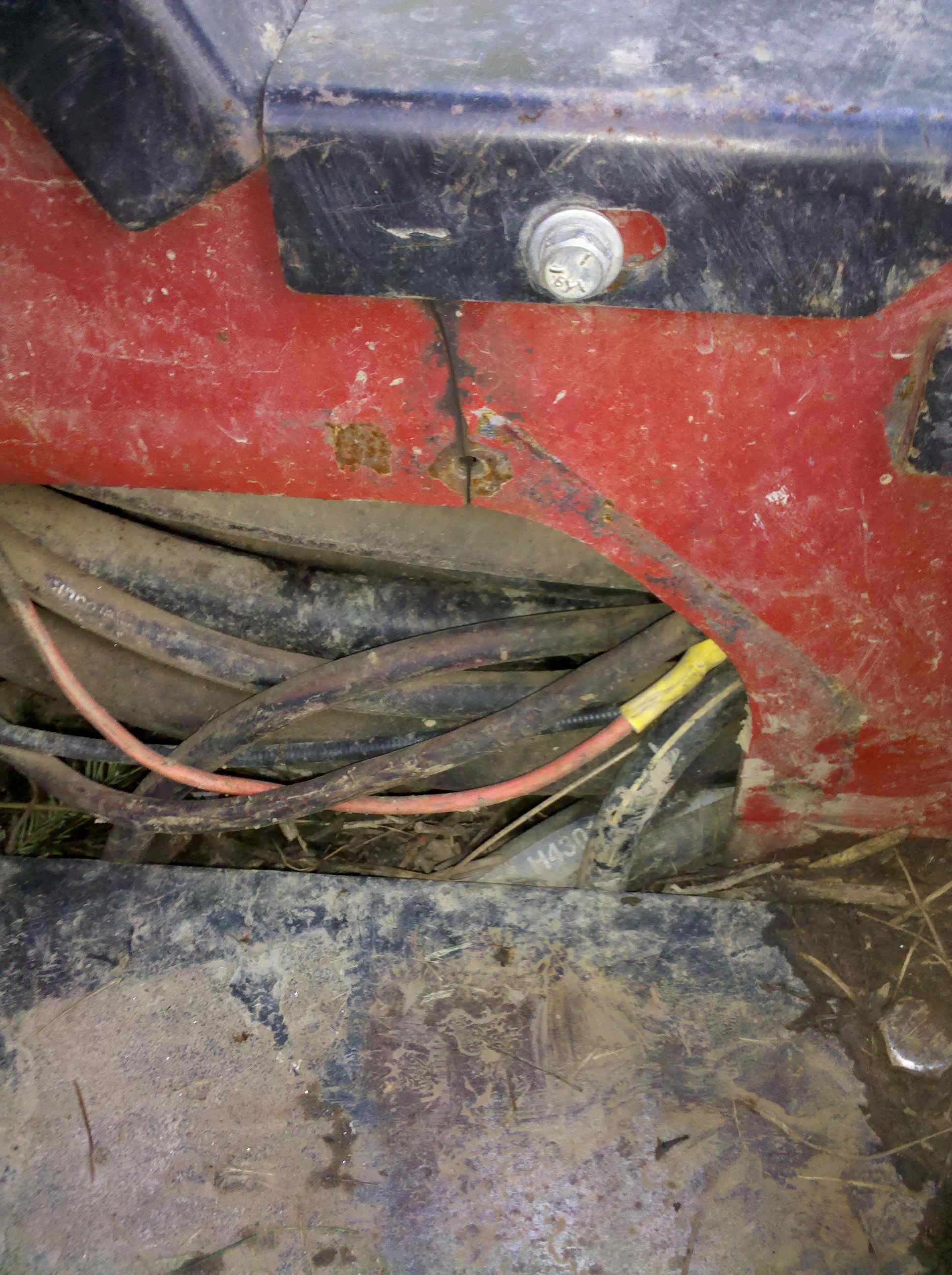

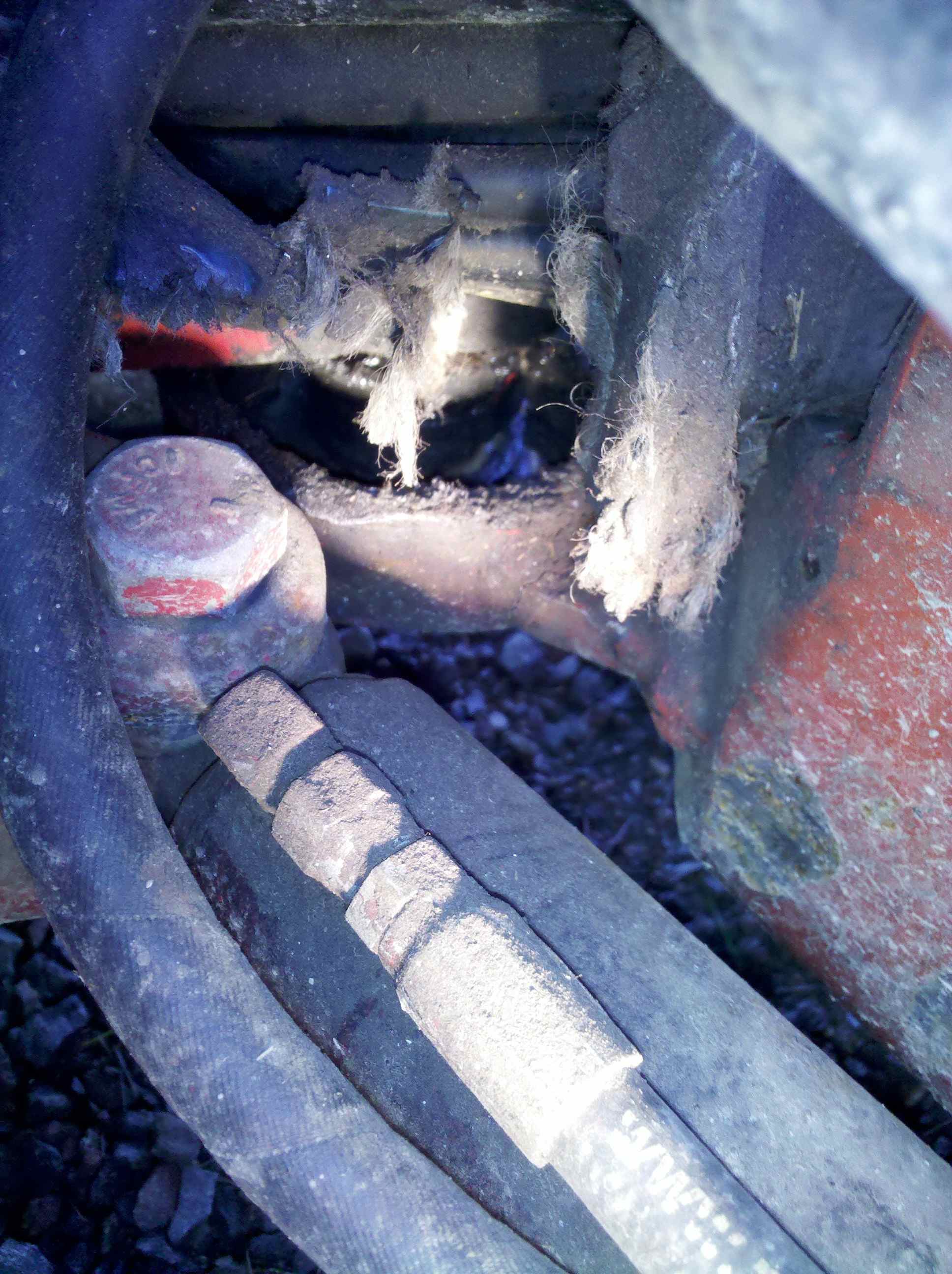

Well, pictures are worth a thousand words. The bottom knuckle let go today. The upside is I was not on the tractor, and the guy who was is a dozer mechanic, downside is, well, my tractor is broke in half. On initial inspection it appears that this piece may have been repaired in its previous life. It sucks. It is a tough weld but my neighbor who is a great mechanic wants to tackle it, and I will be glad to pay him.
But beyond this break is the break on the chasis. I am not sure how, what, when, why. The break looks old but I have to say I don't feel I have seen it before. Anyway.. Calling PT on monday to order a new knuckle. Will discuss all the issues with them then.
Any thoughts btw

I'm no PT expert, but that doesn't look good. I assume this is the pivot point? If you got it used, I would say there is a good chance it did this once before.

Did you not hear the two halves anything banging before it separated? I would have the welder insulate those hyd hoses before welding. If there is any hyd fluid in that area, it should be thoroughly degreased/cleaned. Make sure he has insurance.

Sorry to see that this happened. Some fraction of the knuckle is a bolt on part. I can't quite tell in the photo what broke.
The second break looks old, judgeing both from the crack and the wear on the bolt. The bigger question would be why it failed there. Unlike the knuckle, it is not an obvious stress point.

So, we are getting into the whole deal but here is the long and skinny
130 for all the parts (including new spacers). Terry says that is an uncommon situation, but not unheard of and they have fixed this many times. Simply grind off, weld on the new one.
It is a collar that failed. The feeling is that the tractor never had the jesus nut tightened by the previous owner. It was stretched out under his lack of maintenance and this was just inevitable. The broken front has to do with this piece failing. Terry thinks that it broke maybe a while ago and did not come completely apart. That the bar that holds the two haves together was over torquing and cracked the front.
Anyway, ordered the parts. Will let you all know how it goes.
