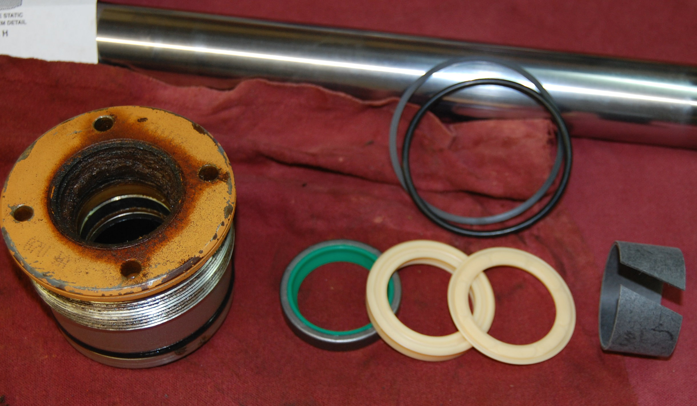

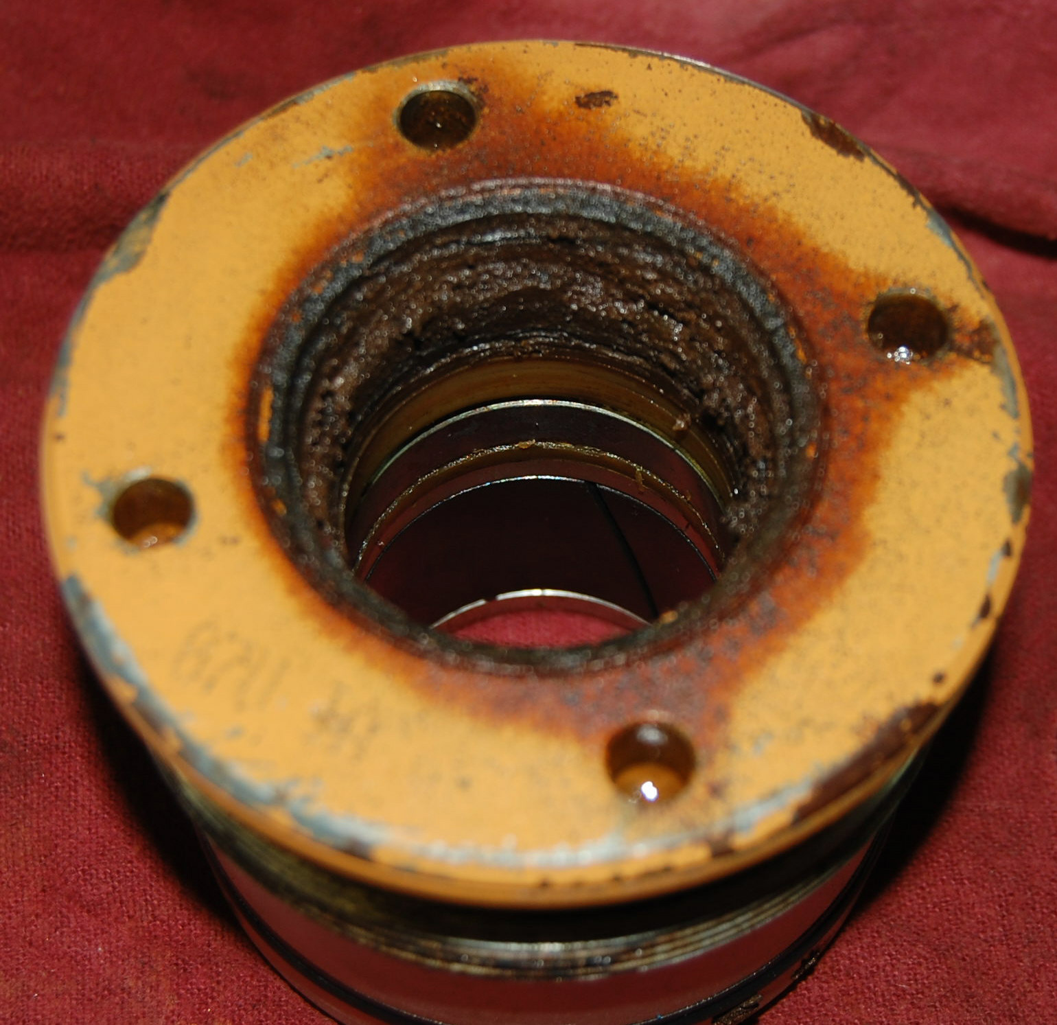

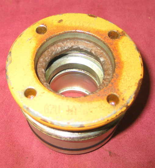

Now to the gland packing. Ive included some pictures of what came in the kit and whats down the hole.
The last picture shows corrosion has occured behind the rod wiper. This has also migrated to the backside of this steel. Should I be concerned and what to do about it?

Sarge,
Clean it up as best as you can. It looks like it should be okay. The corrosion is not on any of the sealing surfaces. Just pay close attention as to the direction the seals face. The instructions you posted have very good pics showing the direction. The buffer seal can be a booger, the rod seal too. If you place them both in a bowl of water and nuke them for about a minute, they will become softer and easier to install. What is the piston seal configuration?

Thanks Andy.
The piston seals were straightforward as the replacements looked just like the originals (except for color). Basically there were 3 parts. The seal with a rubber ring under it and a bearing.
Ill give the microwave a try. Your right about the buffer seal, very tight space. How do you steer the seal in there, double it, scrunch it, or just keep mashing?:D
