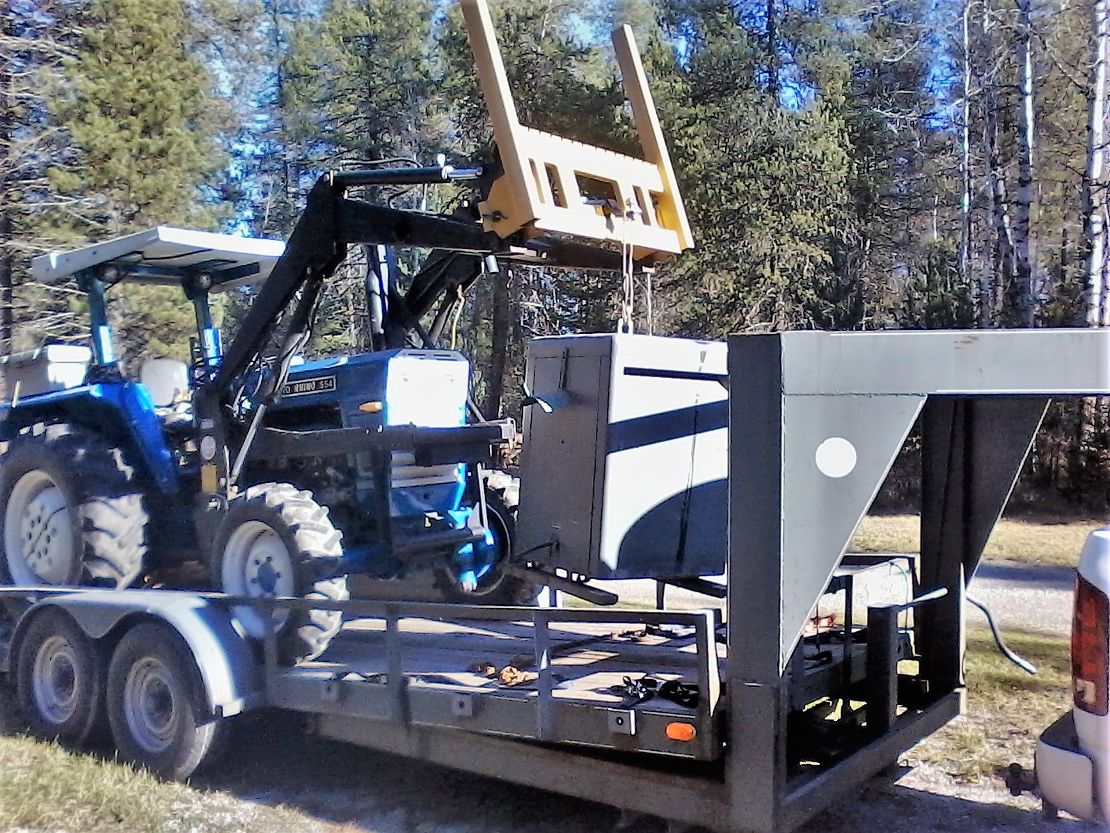

Drove over and checked out the trailer where the welder and feeder have been stored .
The feeder is now a non factor...
because a low life thieve(s) stole the wire feeder- and took the long welding leads that were on it, also cut the power cable to .:thumbdown:.
At least this is one case where not being a (portable) welder paid off- Thanks to being so heavy, they couldn't just walk away with it.
Anyway looks like the only way to remove the welder from this trailer (or to store it) was with a fork lift. They have one there but the ground is pretty saturated with water due to the record setting month of rain locally.
So going to load up the tractor on the fifth wheel trailer and use my newly converted pallet forks for the job, think the welder will just fit under the FEL for the trip back.
I got Lincolns code off the welder and found some trouble shooting info for the control boards already , so things may be looking up:thumbsup:, although it is a bit of a bummer that the wire feeder had been ripped off

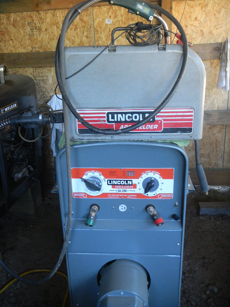

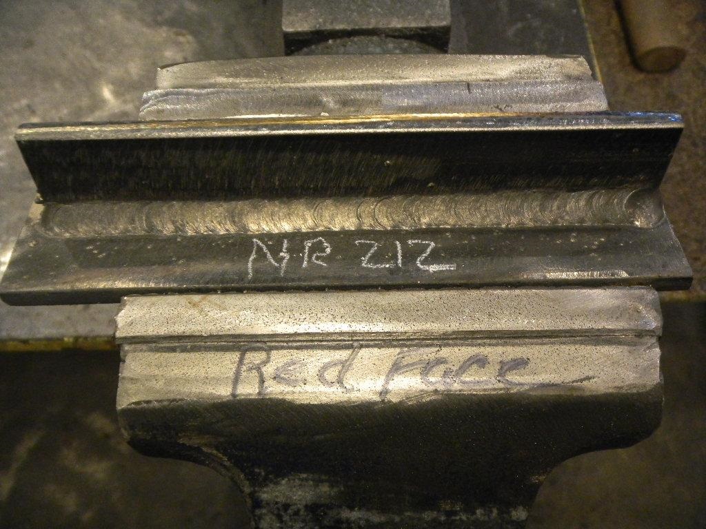

You could pick up a used LN-25 and run self shielded flux core wire. This weld was made with one of my LN-25s, and a 50-year old CC only engine drive welder.
   / Oh Boy- another IdealArc Tig 300 300 (to fix)
That is one nice weld!
you can sure lay down a SMOOTH wire feeder mig weld...

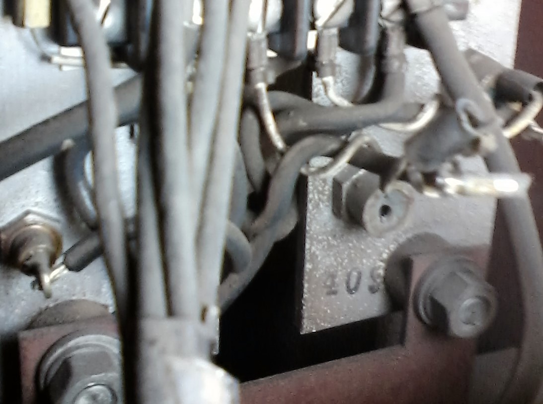

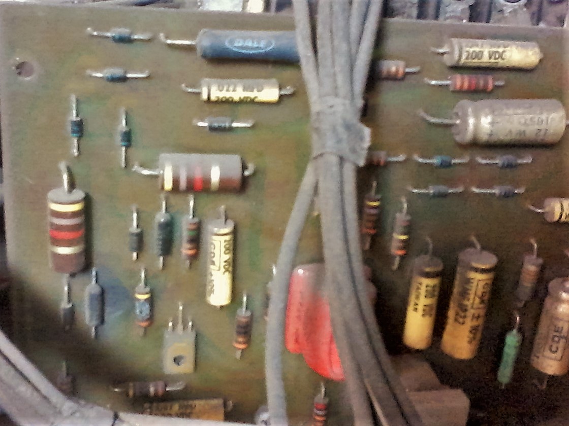

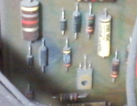

Shut the welder down and did a bit closer inspection of the control boardcontrol board.jpg
have at least a couple of burned components- a small resistor and possibly a diode.control board zoom.jpg
Now when that went it would have made some noise:D
time to do some research... but overall am happy the main parts of the welder seem Ok

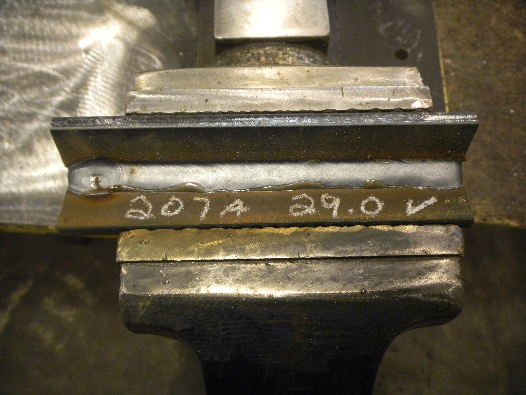

I played a little bit with spray. This is .035" Lincoln L-56 wire, with C-10 gas.

It's ALIVE
Had to replace both large SCRs a resistor and some zener diodes, other than that everything looked good.
Fired the stick mode up and the welder has full amp control again :cool2:
