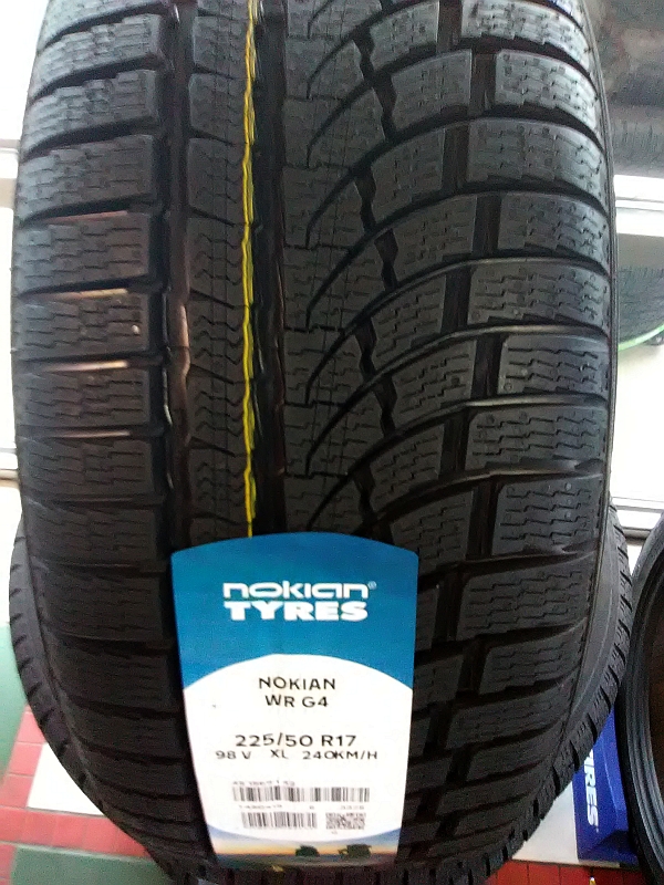

I was in a tire store recently getting new shoes on one of my cars. I noticed these. Can't say as I've ever seen this before. No, I didn't get this style.

Appears to be a directional tire, or at least one side of it does. That is, it appears the tire would be mounted so the "wide side" of the tread would be on the inner side of the vehicle....but why?

Interesting, the asymmetry looks a bit odd to the eye, but it makes sense when explained by the manufacturer.

An asymmetric tread pattern (and compound). Some of these tires are uni-rotation, too (Only supposed to turn in the indicated direction). The idea is to have a smooth good riding tire with low rolling resistance in play while driving straight ahead. As you corner or brake harder and need some extra force capability, the grip compound(s) come into play. That being said, this tire looks like it's intended to have some deep snow and ice capability, too.
Goodyear has a Triple-Tread design with 3 types of tread blocks and compounds. (Triple tread, get it ?) . There are several others.

Seems like a tire with a bipolar disorder.
You would have a hard time convincing me that tire tread design doesn't often have something to do with marketing (kool factor). Kind of like boot and Athletic shoe treads.

Also known as an asymmetric tire.
I had asymmetric tires on a 1984 Oldsmobile before 1990,, They were Goodyear,
The dual tread pattern was supposed to raise the mileage that the tires would wear,,,
