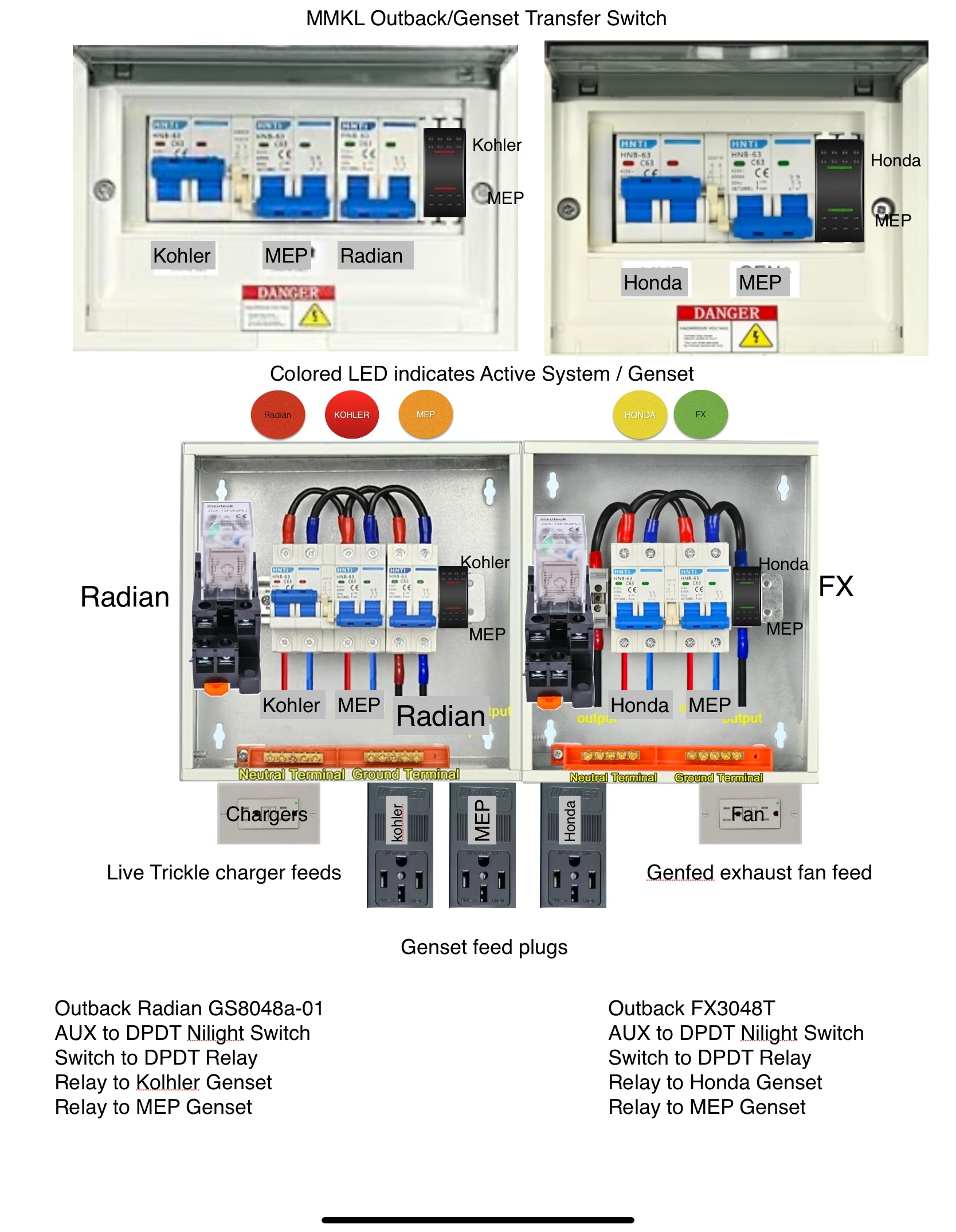

I have a starting design for my new transfer switch.
Goal is to run 1 or 2 gensets from either system.
Yes, I can do so now requires manual control and rewiring of autostart. Goal is the select via switches. Each system. Controls when it runs according to either battery voltage, State of Charge, or Manual -that won’t change other than possibly tweaking settings.
These items on order:
Above item are comparable but couldn’t decide so getting both.

Actually I do have 1 issued not resolved. Relays always puzzling to me. My current setup has each generator wired to it’s own relay and everything switched manually. I have a DPDT relay pictured, but not sure if that will work. Will be playing with configuration once I receive the switches.

Cool. I do believe it would be possible to link two generators, heck this is what my FIL spent his career on, as GM of a few power plants. It requires synchronization before switching them together, and probably careful management arrangement of which of the pair controls the system speed, as two governors with similar time constants on similarly-sized generators are almost sure to oscillate against each other.
Long story short, I think it's very do-able, but maybe not worth the time and complexity for any home-based system.
