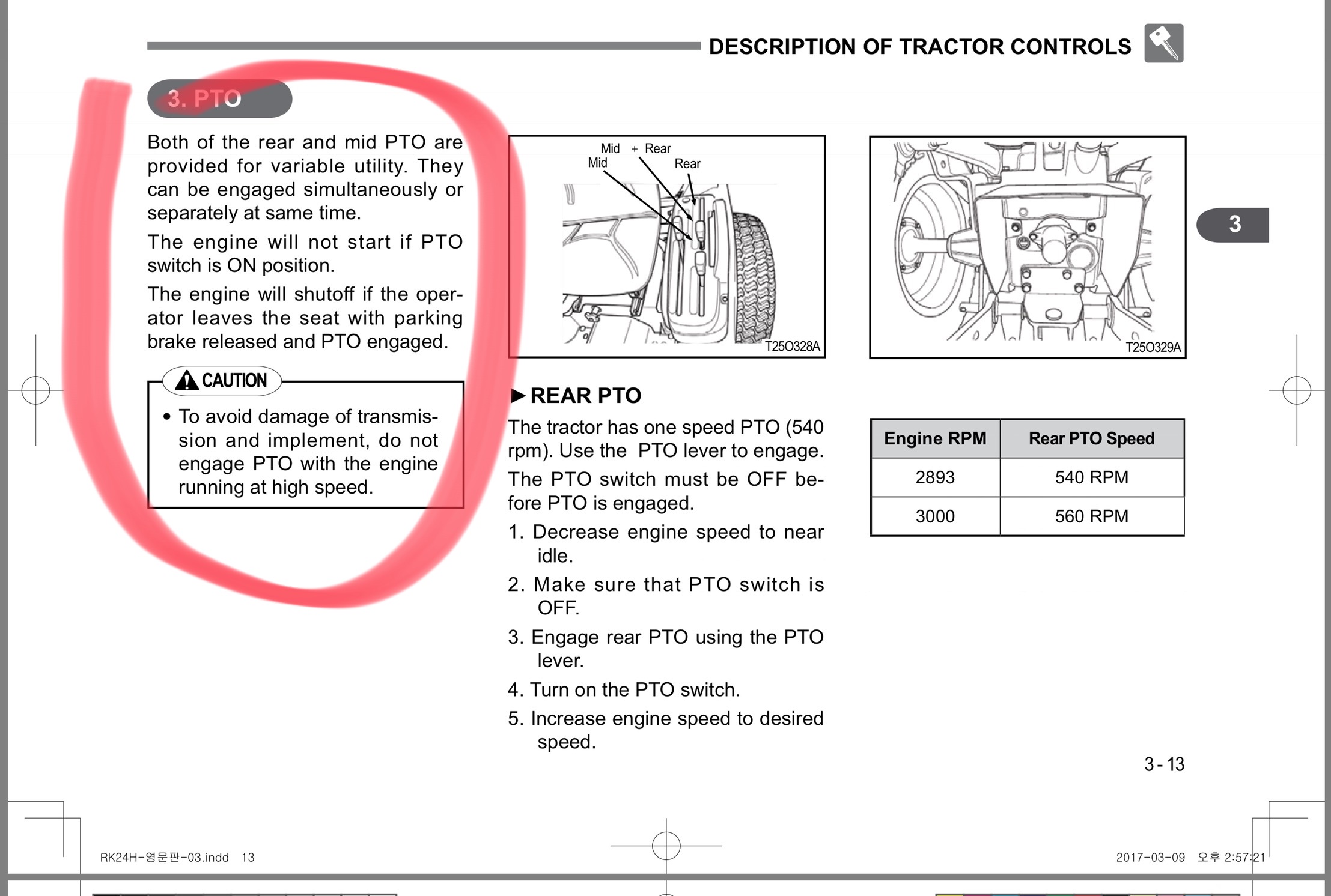

I just read the manual for the RK 55 Cab tractor. One thing I didn't see is how to use the PTO when one is off seat...such as using a chipper or PTO driven log splitter. Do these tractors have off seat PTO capability?
Did you see this?

The way it reads to me is you have to have the parking brake engaged to be able to operate the PTO off the seat.
Kind of ambiguous...
I'm surprised no RK owners have responded...
My Deere 4520 has a specific methodology for off seat PTO operation and is described in the manual. In fact, every Deere I've owned (I'm on my 4th) has had off seat PTO capability.
I'm following a YouTube channel "Outdoors With The Morgans"...pretty good, so check it out. Anyway, Mike Morgan is evaluating three RK tractors, one of which is the RK 55 cab...something I'm interested in. The YouTube channel is what got me looking at RK tractors
I have a RK55HC and run a PTO wood chipper while off the tractor. As long as the parking brake is set my tractor both starts and runs without me in the seat, and also can engage and run the PTO while not in the seat.
:thumbsup:
I also agree it isn't exactly explicit. (Probably the lawyers got involved) "We can tell you when it won't work, but can't tell you how to make it work." :confused2:
