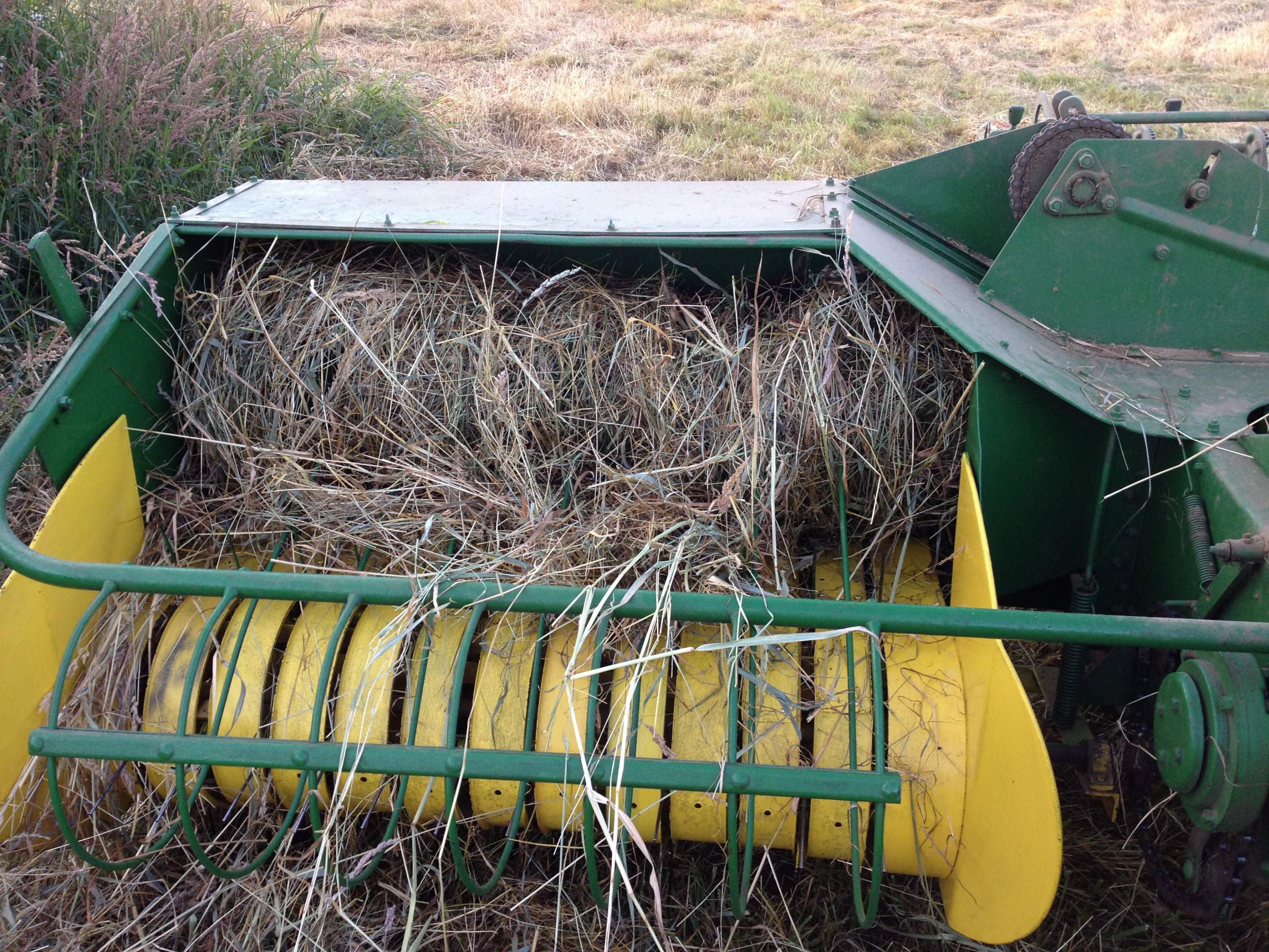

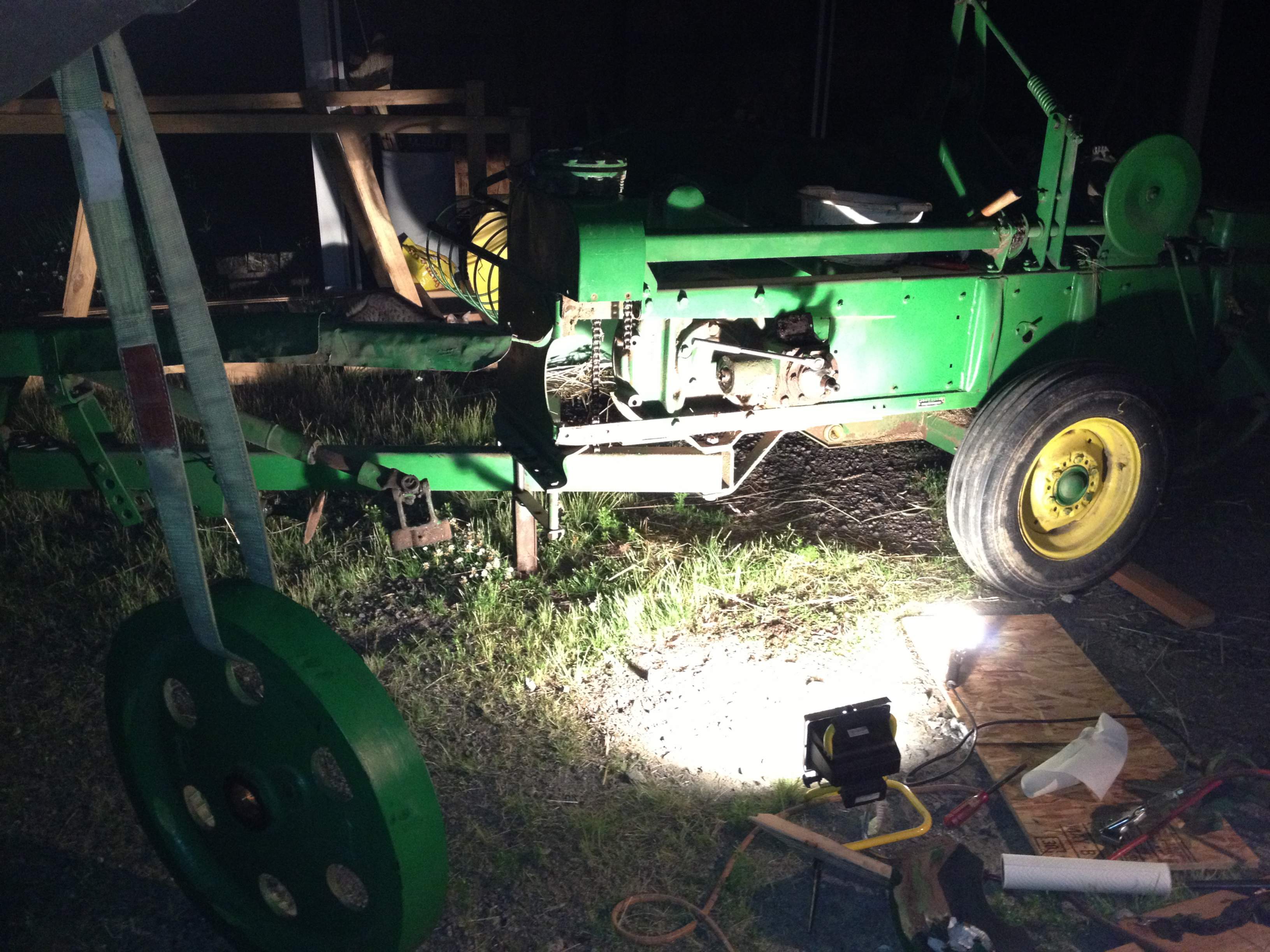

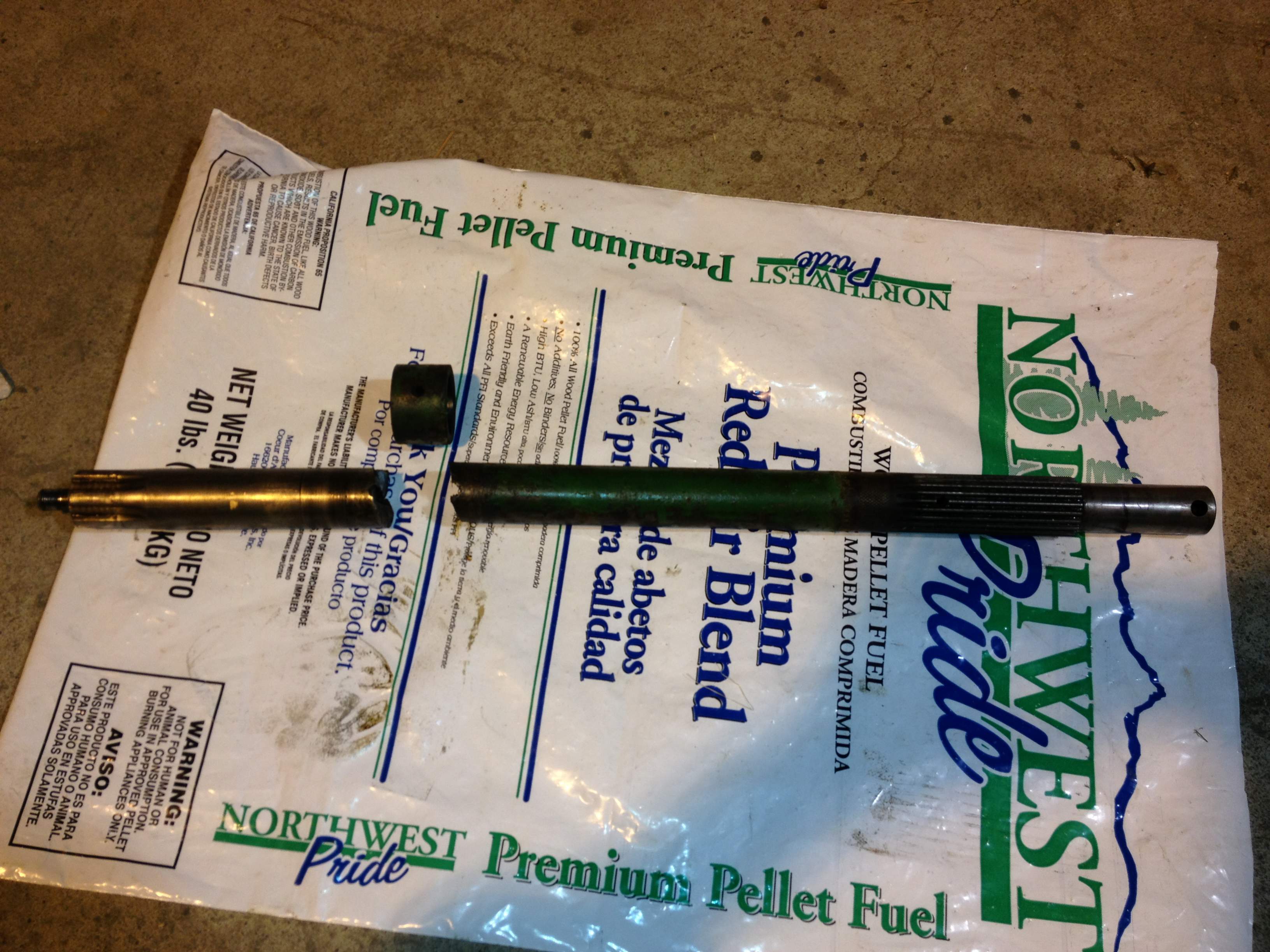

Less than 10 bales into it, something went BANG. The chain driving the feeder forks snapped at 4:50pm. The only parts/supply place withing 30 minute drive closes at 5pm!. I called and told them I'd be there in 8 minutes. They agreed to wait for me. Great! Bought 10ft of chain and a few master links, thanked them profusely and hurried home to try to get going for the folks that were on their way. After counting links and installing the new chain, I was turning it over my hand checking the timing and heard an odd click click click that hadn't been there before. Further inspection found the sprockets for the main drive chain out of alignment and the clicking was the chain riding up on the teeth... the input shaft into to the main gearbox had "grown" about 1/2" in length... what the heck? I figured a nut must have come loose in the bevel gearbox behind the flywheel, but it didn't look like that end of the shaft had moved, only the other end.. The folks showed up for their hay, and we told them they could take the 35 bales we had in the barn from May instead while I started taking things apart. To my dismay, I found the input shaft had snapped under a collar just outside the gearbox! It was now 6:30 and everything would be closed, so no hope of ordering parts until the next day... a web inventory search showed shaft wasn't in stock anywhere nearby, and it壇 cost $540! This was starting to seem a little less fun.... The folks buying the hay finished loading and came over to see how things were going. I showed them the shaft and said I知 pretty much hooped unless I could find a machine shop to weld it. Their son-in-law said çš„ could get that fixed for you, or make you a new oneè³* he worked at a refinery and had access to everything necessary, plus the know-how. He started work at 3:30am and said if I could have it out and on the porch by 3am he壇 pick it up. Whoo hoo! I went out and mowed another 5ac until 10pm, came home and set up work lights and pulled the gearbox apart, pressed the bearings off the shaft and had it on the porch by midnight. He called and texted a couple of times through the day to confirm a few things, and had the metallurgy tested, annealed, ground out, welded, straightened, re-heat treated, even painted John Deere yellow and back to me by 5pm!
I put it all back together, re-timed and headed for the field to start baling by 7pm. First bale tied fine, then both sides missed, and after re-stringing the knotters a couple times found a broken spring on the tucker fingers. Fortunately I had one in my 澱ox of old springs that I could cut down and make it work. I punched out 150 bales, and got them loaded them on the trailer just as it got dark at 10. The next 1200 bales went pretty smoothly with only minor mechanical hiccups, about a dozen ball-ups on the rake and running into some ponds and ditches (but no fences!). I壇 had trouble keeping ahead of the falling grass with the sickle bar mower, as some of it was leaning. I was running wide open in first gear high range which was a little too slow, but second gear ground speed was too fast for the cutting action, both causing cutter clog-ups and leaving tall grass pushed over. The 斗ive grass is mostly what caused the ball-ups on the rake, baler and broke the chain on the baler pickup. One time some wrapped on the PTO shaft on the rake and jacked the release on the rake end, causing the PTO shaft to drop, which instantly made a giant Q-Tip. Due to delays and wet areas I left about 6 acres standing since I had to go back to work, then off to help at our church highschool youth camp through the next weekend.

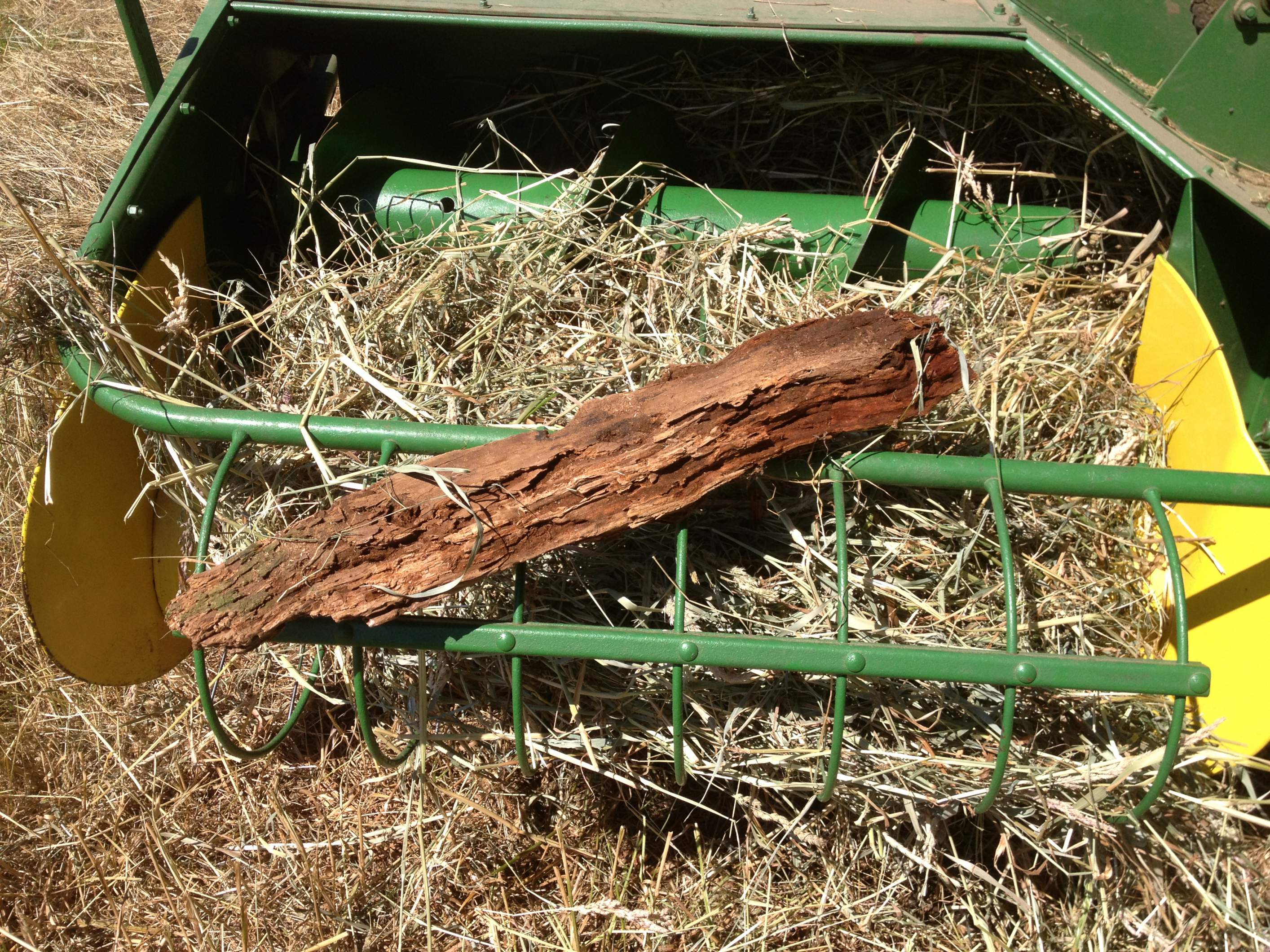

1400 bales at about 4 per minute. Only one missed tie (once I got the knotters working). One flywheel shear bolt in the first 1350 bales, and 3 more to finish the last 50 bales around the edges of the field. 2 broken chains (master links both times), the broken input shaft (the crack had been progressing for a long time), and about 20 gallons of diesel burned in the tractor.

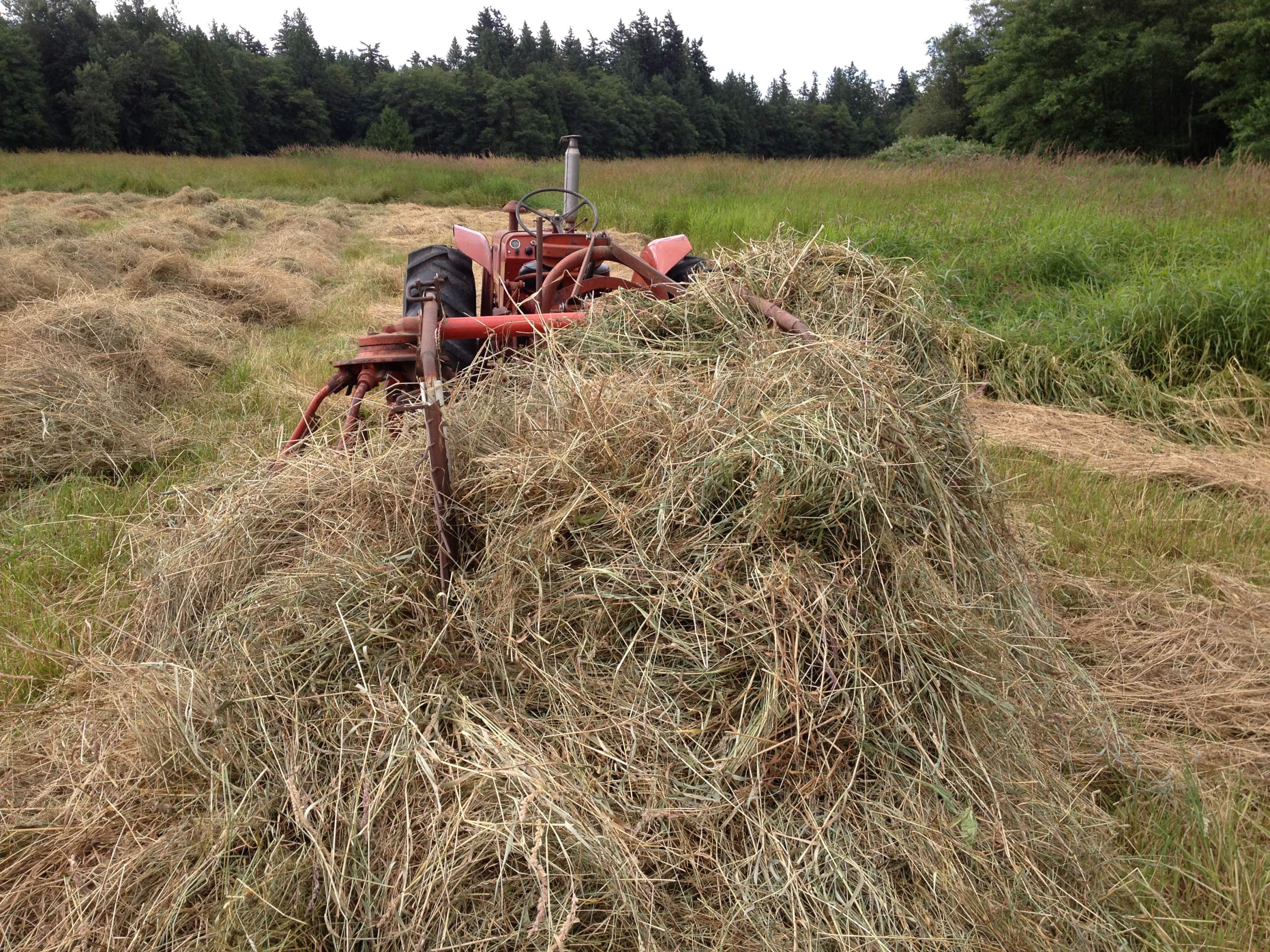

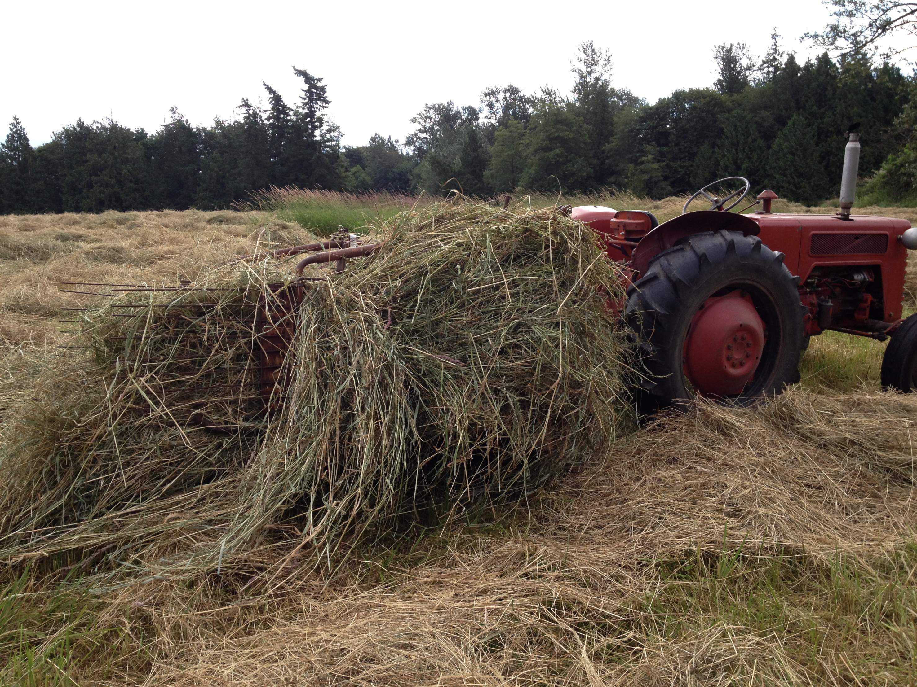

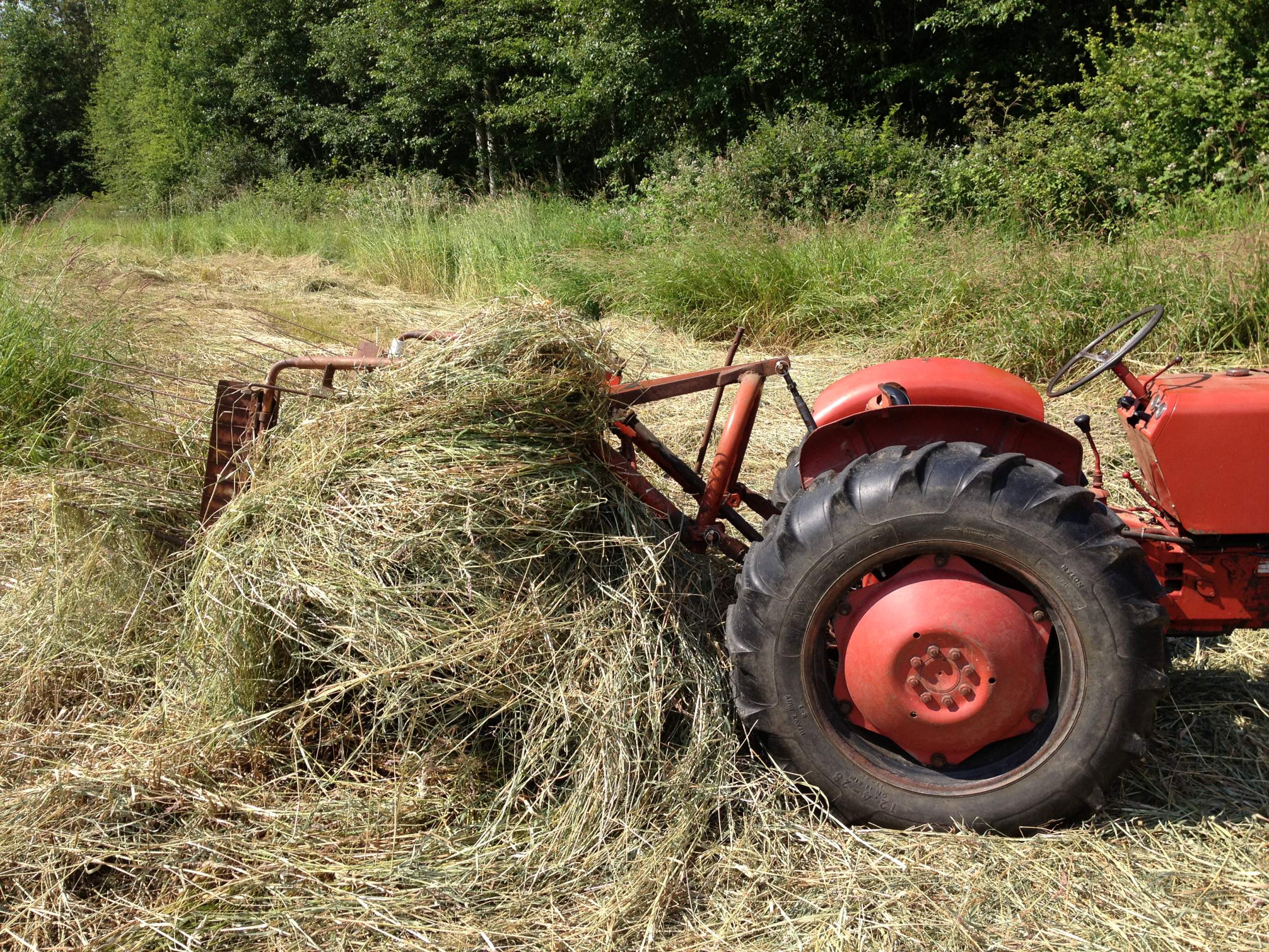

The guide fingers supports for the rotary rake were dragging on the ground. Once grass wrapped around the front of them and started dragging along more grass quickly joined it, blocking the ç™»utput? which quickly backed up into the whirling baskets and balled up. I welded some pads on the bottom of the support arms to lift them off the ground 2 inches and the ball-upç—´ nearly stopped happeningl.

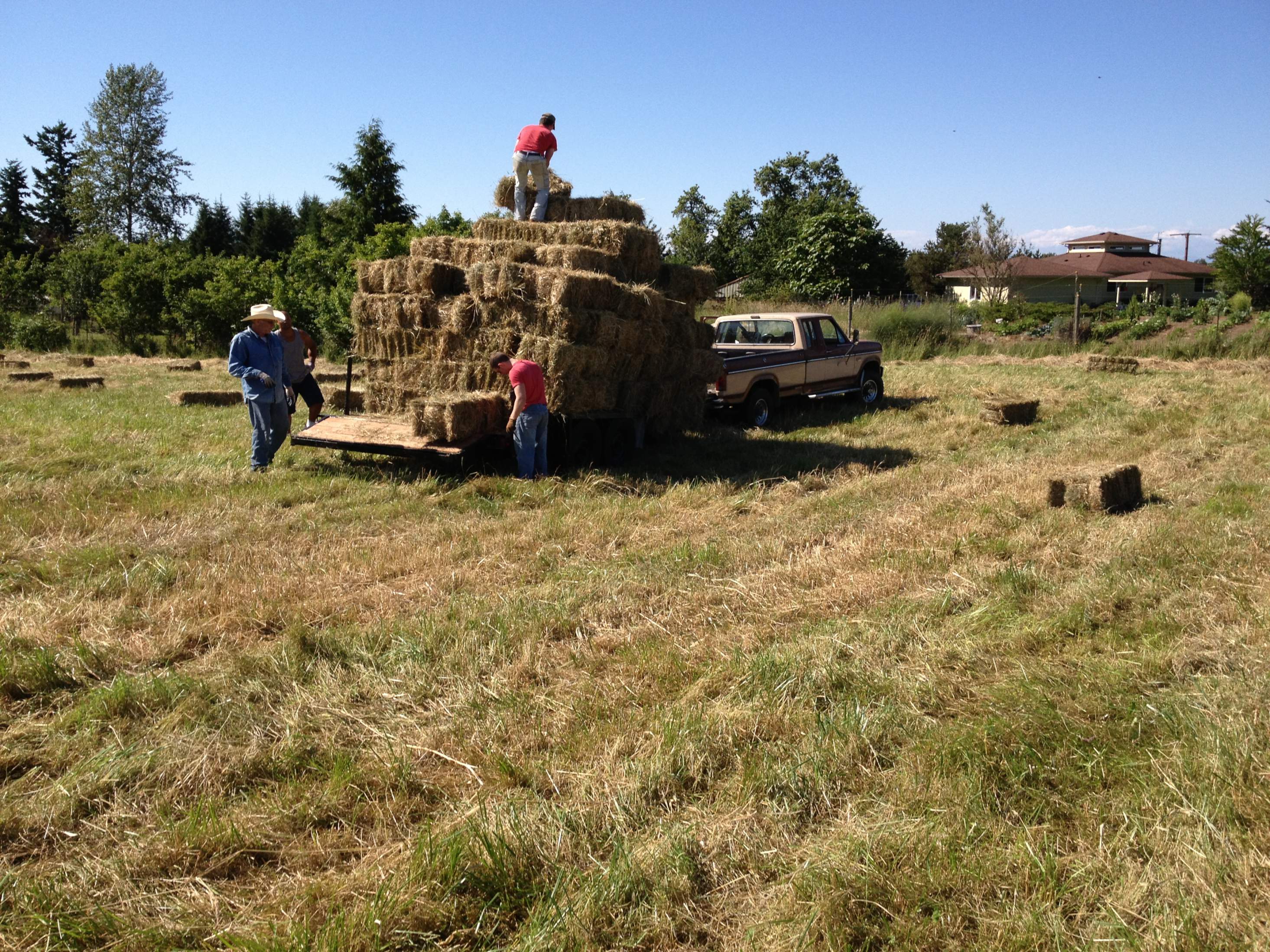

Good help is invaluable. Feed them well. My crew (co-workers at my day job, plus a 3 others that have horses and were working for hay) was fantastic. One guy had bucked hay for 7 years as a youth, the other 2 co-workers were virgin buckers, but were incredibly strong (weightlifters). It was pretty funny to observe the difference between experience and strength, and how much energy the strong guys burned by not moving efficiently. A couple skinny 40-50 year olds ran them both into the ground! My wife and kids made big dinners both days and everyone had fun, and will hopefully be back next year!
