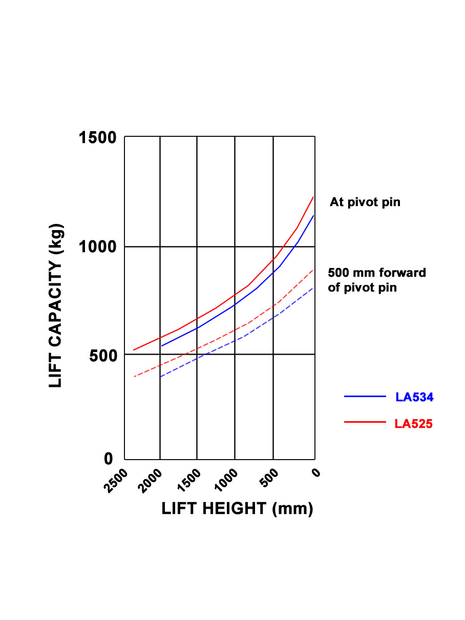

I have noticed some tractors mention lift capacity at maximum height and that would seem to be more telling than what LS mentions - For example LL4104 loader Lift Capacity(@ Pivot pin) (lbs.) 2,713. Since LS is known for having a lift height that is lower than most other brands (a foot lower in most cases), the LS could really be low on the totem pole when it comes to this specification. Has anyone found better information than what is listed on the LS site?

The lift capacity is to full height. The reason LS has comparatively low lift heights is because they have more capacity. It’s a trade off.
   / Odd that LS doesn't list lift capacity at maximum height? #3
Shorter loader arms = more capacity but also = less height.
   / Odd that LS doesn't list lift capacity at maximum height? #4
This is one of the oddities of tractor ratings, not all "full heights" are equal. I have found that in a lot of cases, Kubota goes 8-12" higher than other brands and so they end up with a lower weight rating. But if you look at the loader curves in the owner's manual and trace them down 8-12" lower, the weight rating is a heck of a lot better.
It's even true when comparing different Kubotas -- here's a comparison of loaders on the B2650 (blue) and L2501 (red). The L2501 loader has a lower weight rating on paper, but that's because it goes 8" higher. Compare the lift curves anywhere at the same height, and you can see the L2501 loader lifts more.

Some folks seem to be under the impression that you have to give up height/reach in order to get more capacity. But in most cases I have seen, the higher-reaching loaders will have the same or similar capacity as the lower-reaching loaders when compared at the lower height. So get the higher-reaching loader and just don't lift it all the way up if you want more load capacity.
You really need to have the lift curve to really make any conclusions. It's really basic geometry, but having single sets of load ratings at max height doesn't really tell the story.
