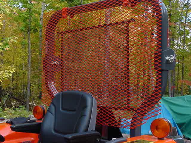

deerefan - I got nailed one time too many so made a simple screen from expanded metal. Does the job. Picture attached.

As penokee points out, anything is better than nothing.
