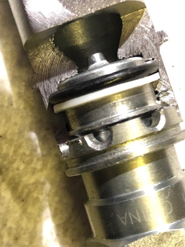

i've found that a -114 and a -115 size o-ring will work for this Type A 3/8" coupler. The -115 size, being slightly larger diameter is more difficult to install
My curiosity made me waste a coupler by machining it half away to get and actual measurement of the o-ring groove diameter as well as dropping both sizes of o-rings down into the groove to see the difference in fit.
It's now apparent, at least to me, that the smaller -114 is the proper size. Some may ask why I didn't just compare the original o-rings to get the size. Well, kind of a long story so will just leave it a that.

Does that connector have a backup ring along with the O-ring or just an O-ring? Just curious since it seems like some models do and some don’t. My old Parker O-ring handbook shows pressure vs diametrical clearance and going from memory I believe.002 inch was 1500 PSI.

OLDNSLO Here is a pic showing the o-ring and backup ring with the male coupler tip installed:
The small chamfered holes are where the retainer balls would normally be located and the chamfers show the quality of machining on these china eez parts. The frazzled cut edges show the quality of my cutaway machining and lack of deburring thereof. :)

Your cutaway machining is far superior to my hack saw. Getting the O-ring and back-up ring installed can be real challenge and keeping them in proper orientation even a bigger problem.
as a point of reference my Parker hand book shows the groove OD for the 114 to be .787 and the 115 to be .849.

I'm not sure that the coupling uses a standard size o-ring in imperial or metric. I found that the Parker version of this ISO7241A coupling has a specific part number just for the coupling o-ring. Normally this type of o-ring is also harder than the normal nitrile material. I can't be sure that the o-ring is the same in all ISO7241A couplings, but I don't see why one manufacturer would change it. The backup rings are also listed in the catalog.

Edit: I checked the o-ring groove diameter in the cutaway body and it measures about 0.830 which is in between what post #8 (oldnslo) shows for #114 and #115 o-ring groove diameters. So the Parker 50001-115-0010 is maybe the special o-ring size?
