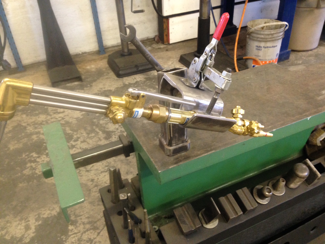

Ron, also do you have flashback arrestors? If they are on the torch end that may hinder flexibility. If they are, get the ones for the regulator end.
I have quick couplers on my torch handle which makes the entire apparatus stiffer, but that’s fine with me because I am only using the torch for cutting. IMG_7295.jpg
