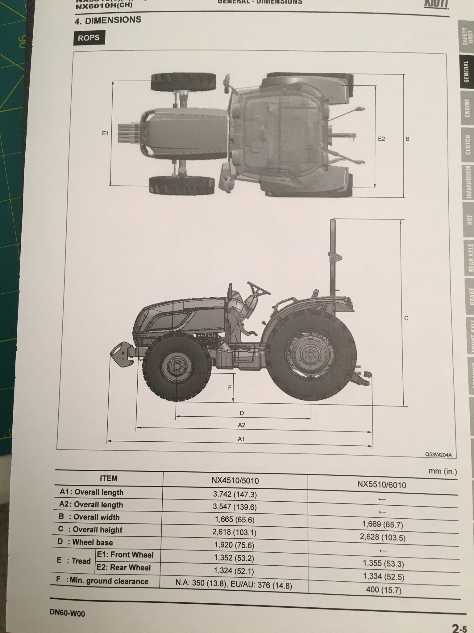

Hi I am wanting to buy a NX5510 With AG tires 16.9x24. Kiotis spec say the width is 65.7 inches. I would like to know what width you tractor is at the widest point (assume outside edge of rear tires). Please elaborate if the rear wheels are dished in or out and tire size.

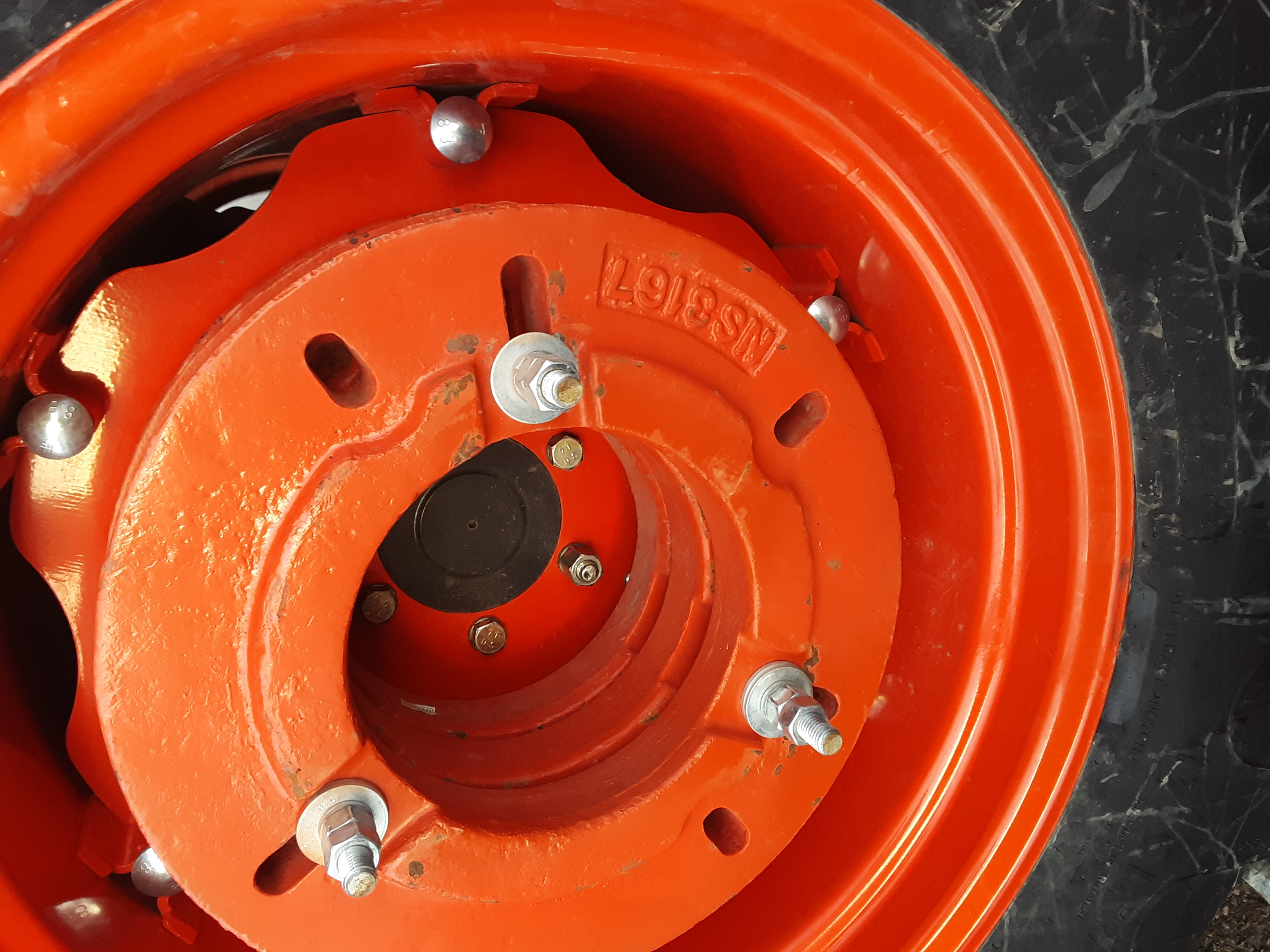

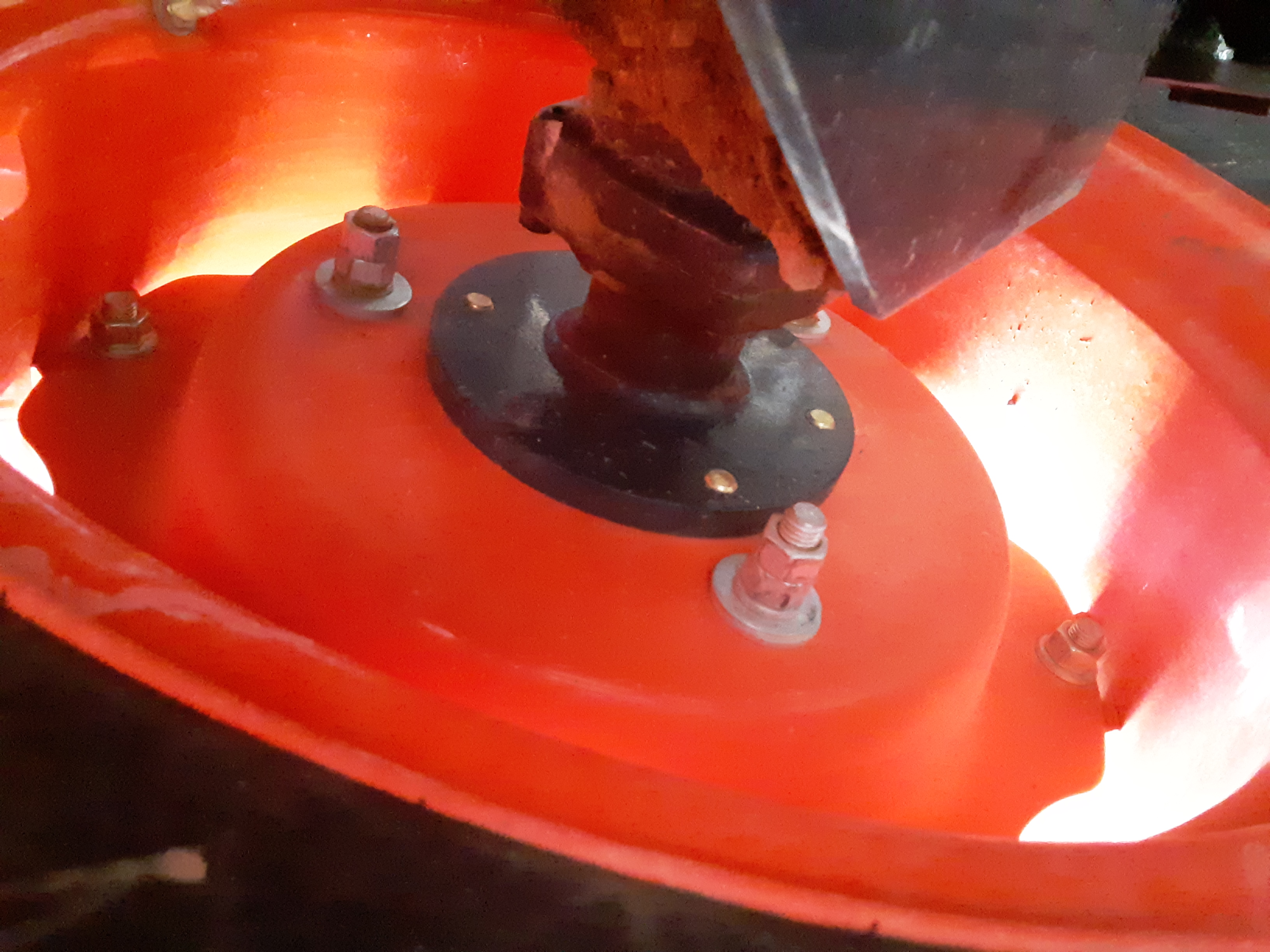

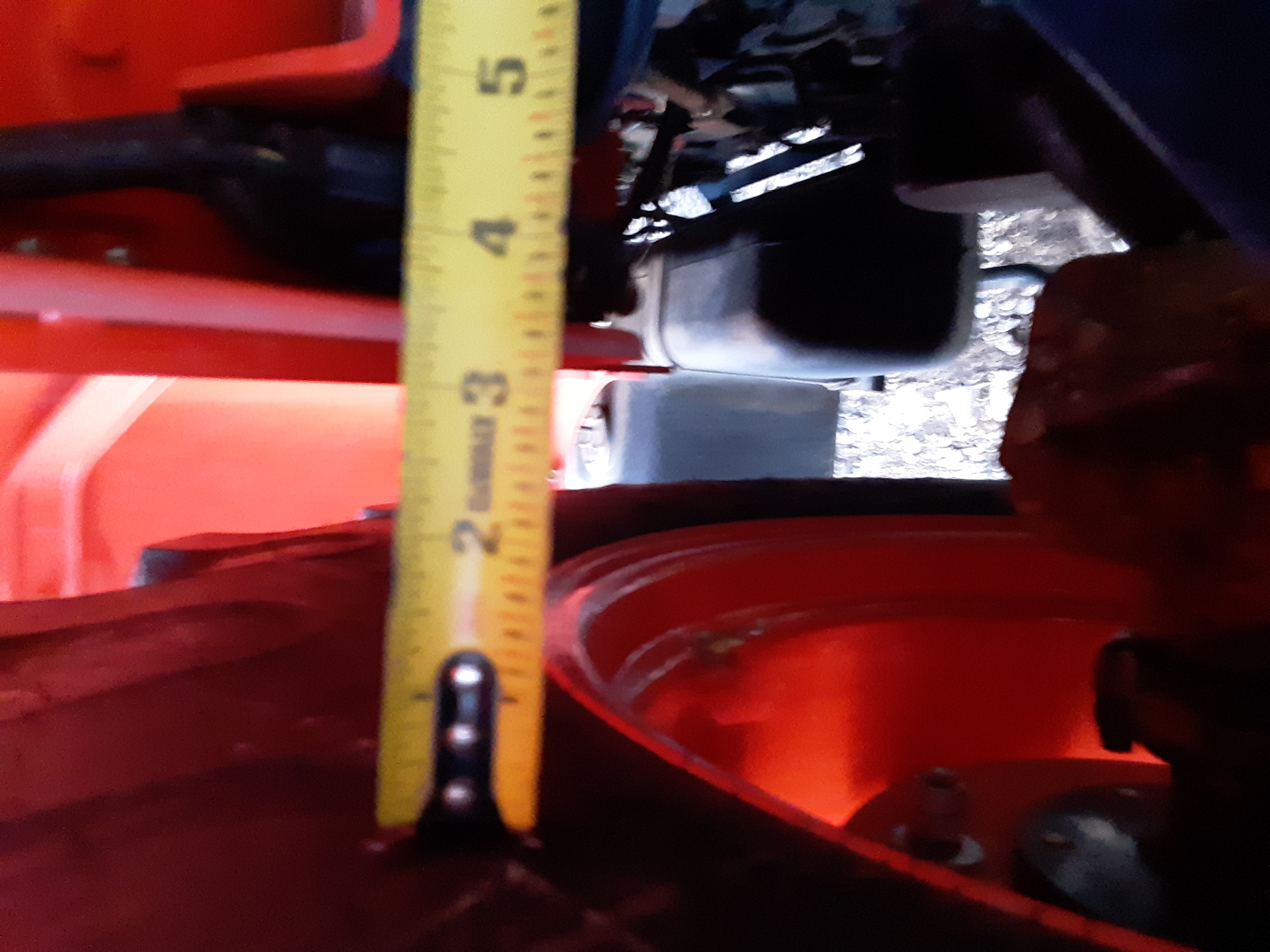

Forgive my fuzzy pictures. I have the 2 piece adjustable rims.
The wheel dish is mounted to the axle flange facing outwards:
The wheel's ring is mounted the outside of the dish:

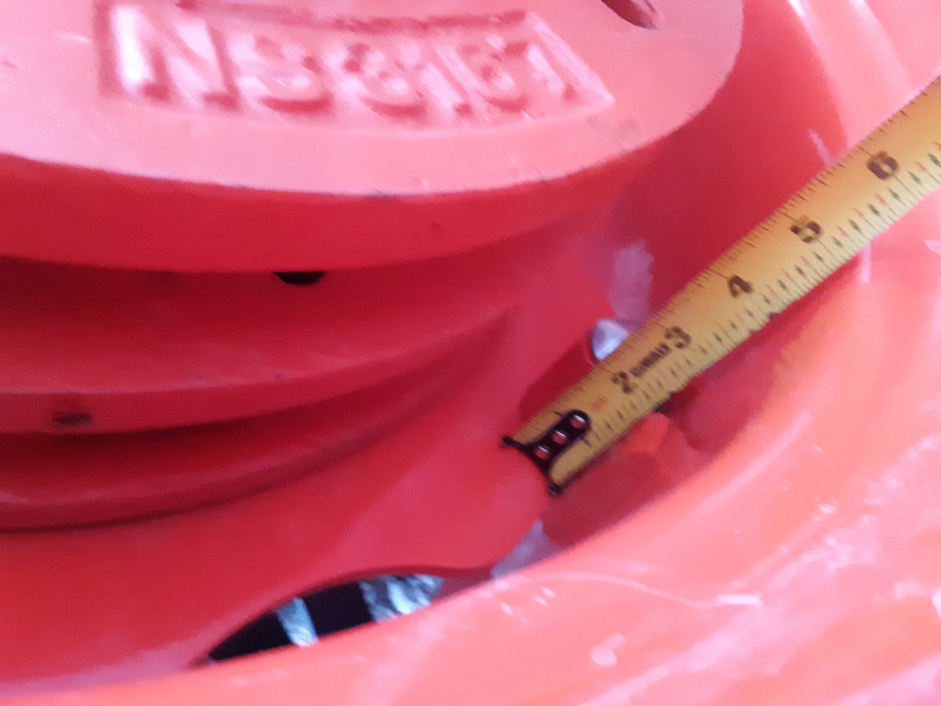

I could swap the ring to the inside of the dish to narrow the wheel in by 2 1/4" each (dish boss is 1 7/8" thick and the wheel dish is 3/8" thick:
The problem is there is only 3" of clearance between the inner fender and the tire sidewall:
Granted the R1 Ag wheel and tire combo is a little narrower than the R4 but not by a lot.

Thanks! Still don't have anyone confirming we can get it safely narrowed to that width of 65.7. If the tread width is 52.5 adding 1 tire of 16.9 width that's 69.4". Something is not adding up.
