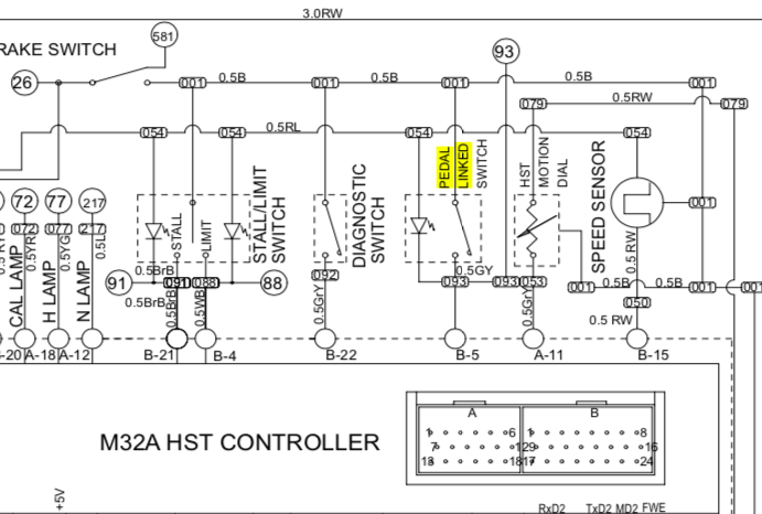

I have an NX5510HST Cab I purchased a few weeks ago. Its a strong running machine, however the linked pedal light on the dash along with the light on the toggle switch won't turn off. When I depress the pedal the RPMs don't increase, so it's not working as it should. Any ideas on what I could possibly troubleshoot?
   / NX5510 Linked Pedal Light doesnt go off
I'm not seeing a relay for it in the wiring diagram, I attached it below where it shows the link pedal. I did look at the relays in the fuse box but didn't see anything that related to it. Is there a particular relay I should look at?

My bad. I believe the diode is burned out at the switch itself allowing the light to stay on. Follow power at 93.

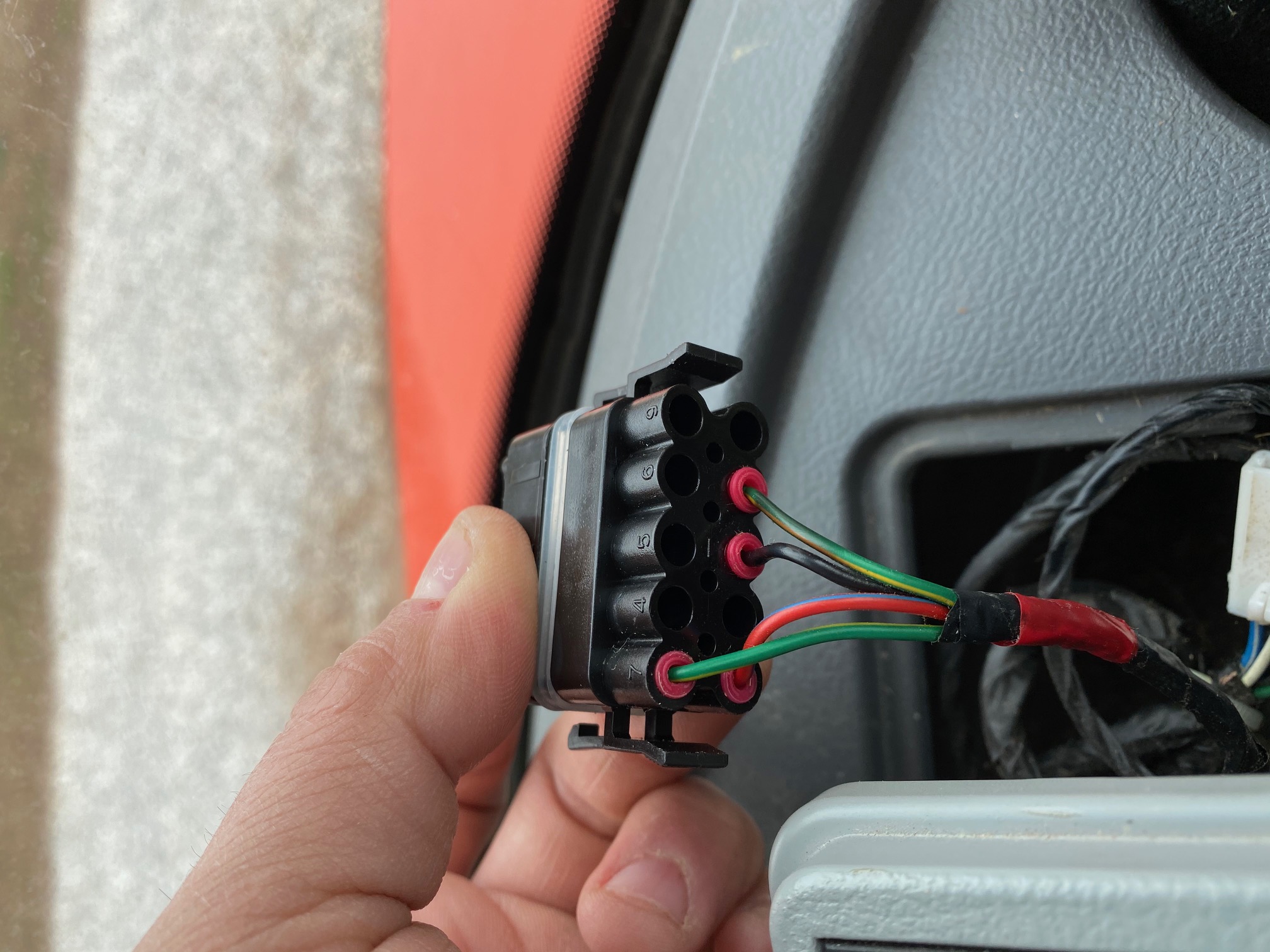

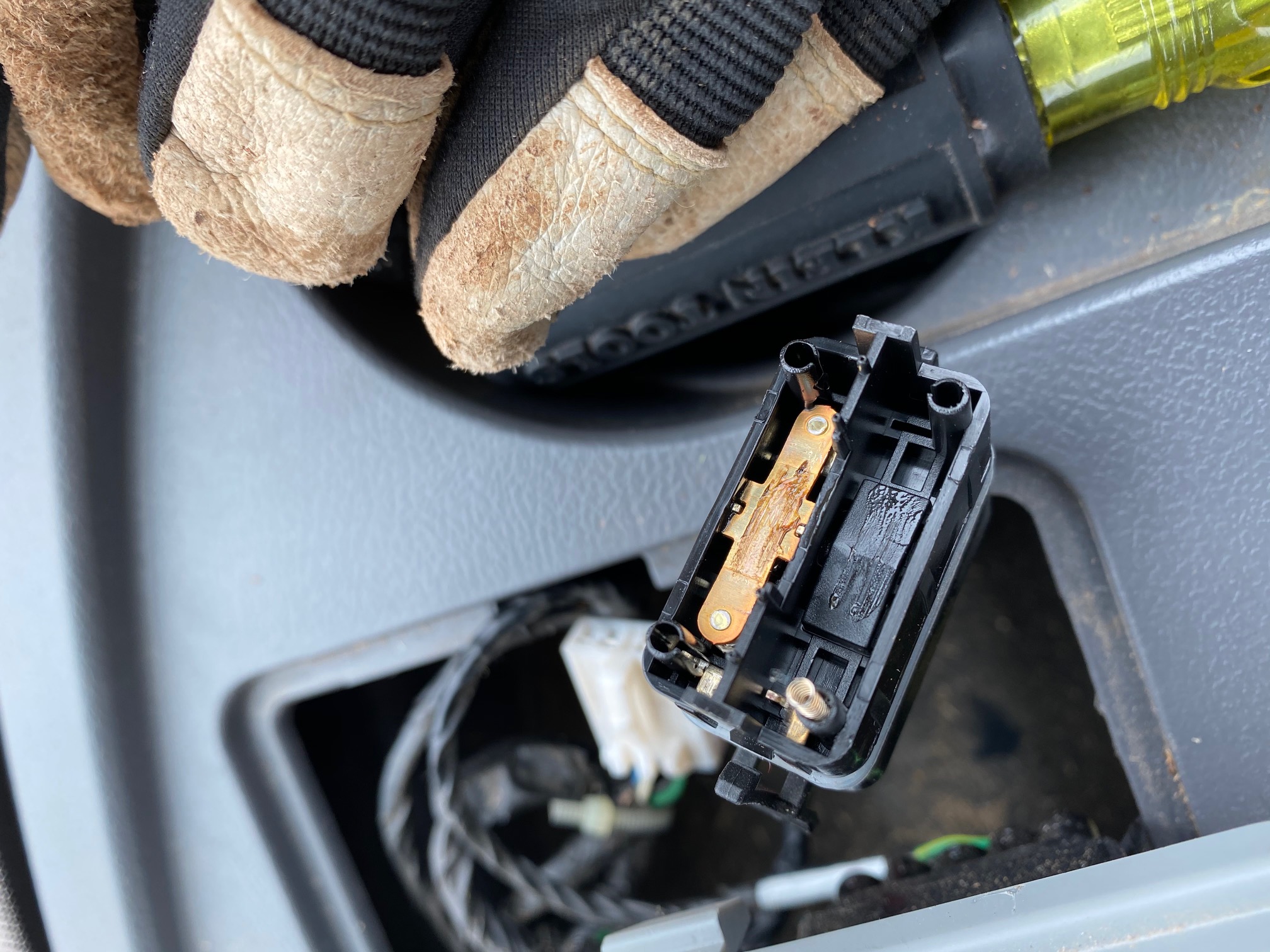

That maybe the best possible news! I did remove the switch this morning to examine it, here's the actual switch below. Let me ask you this; would that not allow for the foot throttle to work as well with that diode being burnt out?
   / NX5510 Linked Pedal Light doesnt go off #7
When you turn the switch on, do the engine RPMs increase when you push the forward/reverse pedals? That should tell you if the foot pedals are working to increase engine RPMs.

No, the switch works the linked pedal, the diode supplies power to the light. The diode has failed closed and apparently is in the switch according to the wiring diagram. Unplug the switch and the light should turn off.
