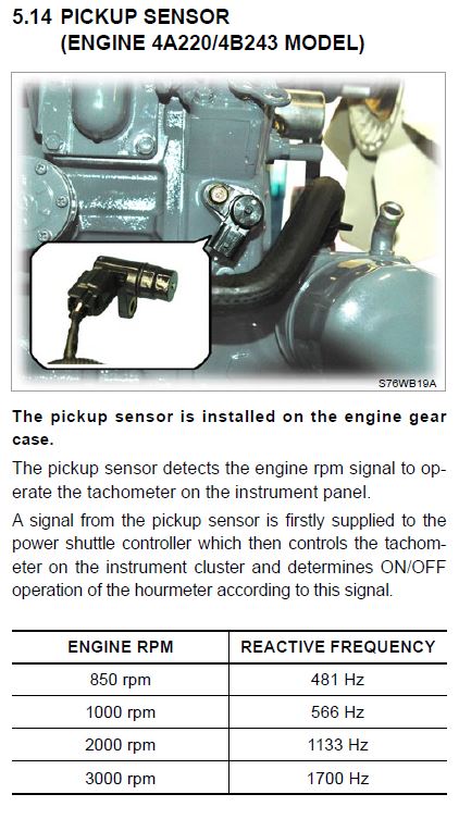

The frequency will be 481Hz at 850 rpm, 566Hz at 1000 rpm, 1133Hz at 2000 rpm and 1700Hz at 3000 rpm. A dvm without a frequency counter will not work but you might be able to measure the average DC voltage of around 6.5V
The pickup sensor might have come loose from the engine gear case.

Here is what I came up with today. I unplugged the pulse output on the alternator and plugged in the multimeter. With it on the frequency setting and started the tractor. Not sure if it was my two year old hitting the tires with his snow shovel or me finally asking for help on here but all the gauges did a full sweep and the Tach was working reading just about 1000rpm. I was reading 170Hz on the dmm at idle. Doing the math.
Alternator pully diameter - 70mm
Balancer is about 110mm
12 pole alternator
170=(12/2)x(rpm/60)
1700rpm for the alternator
1700x0.64(pully ratio)= 1088 engine rpm
I didnt get a chance to hook into the crank sensor. Seeing as with the alternator pulse signal removed the tach still worked tells me that it is using the crank sensor for the tach not the pulse signal as the workshop manual says. I am guessing the tach signal is sent to the dash via the can bus rather then the individual pin A25.
