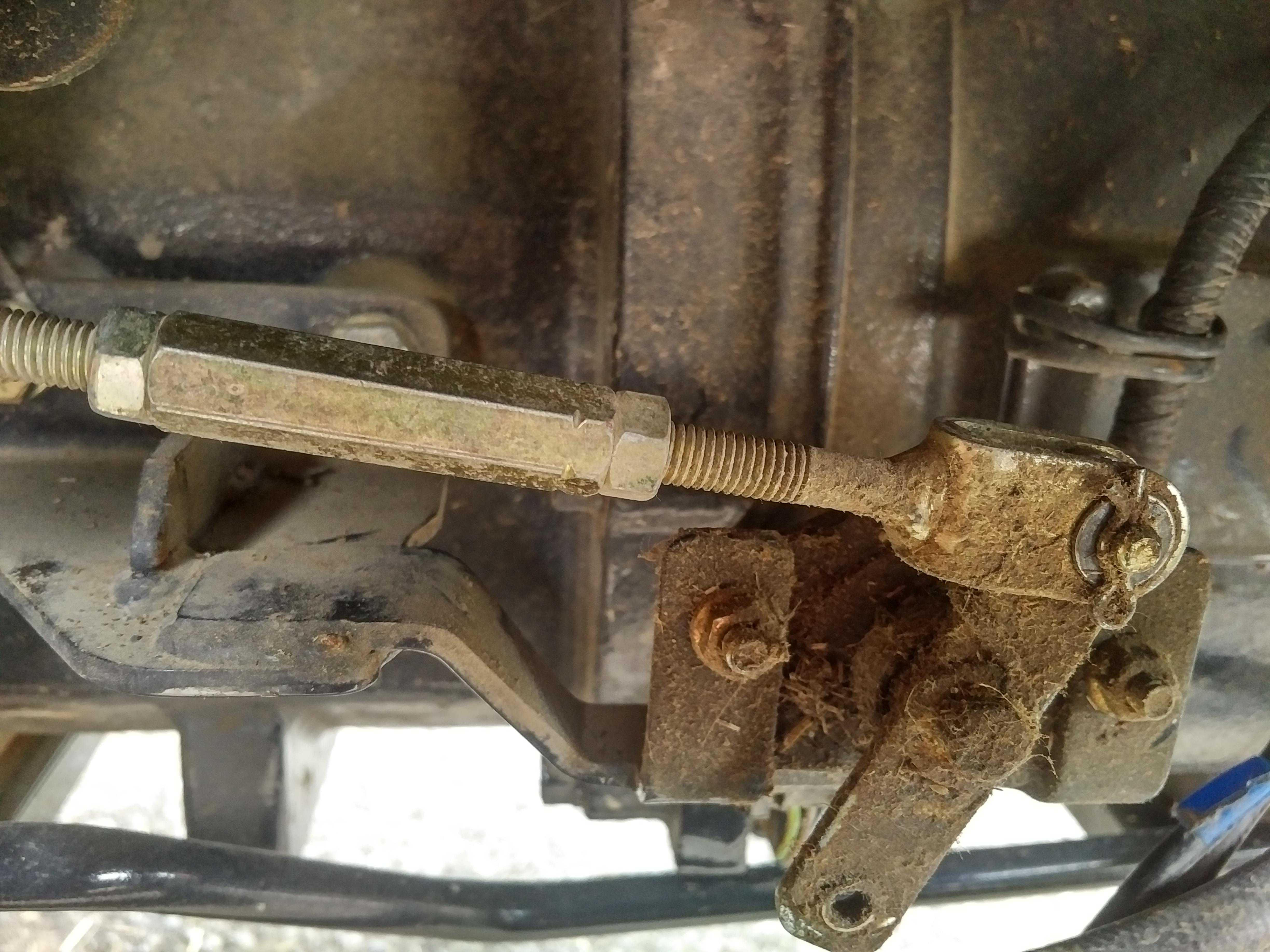

Thanks! Fuse AOK, lots of wires under tractor, not very well protected. Some labelled, many not. Hard to tell which is 4x4. Maybe one with lever in pic? In the end, disconnected and reconnected each wire. Now working - yahoo ! To test, put bucket down on wet grass, lifted front wheels off ground and creeped forward/backward. Front wheels responded. IMG_20190624_0829322.jpg
