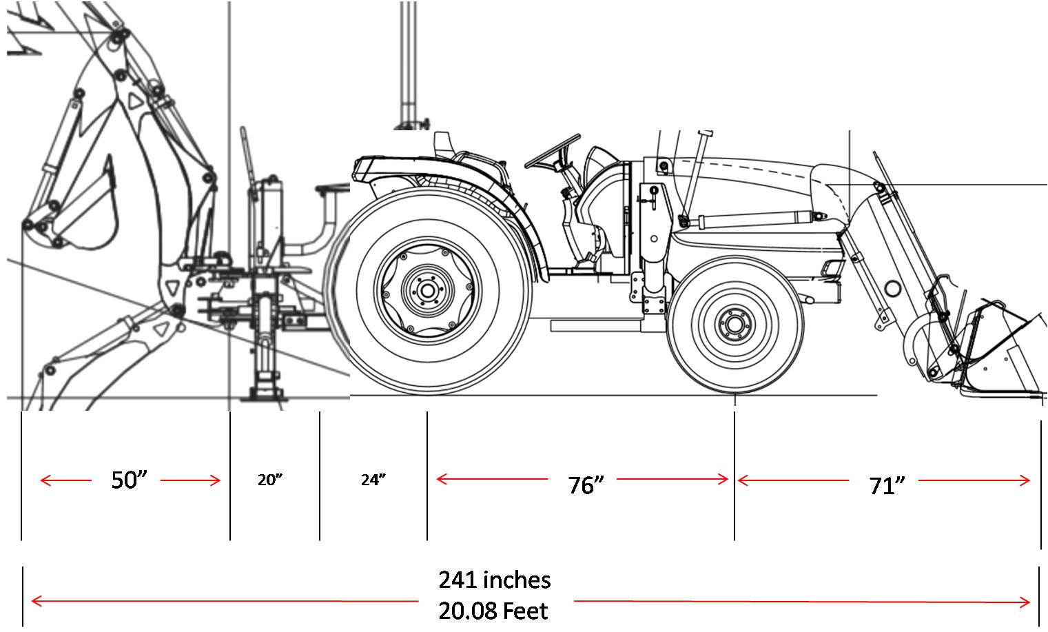

Once in a while someone will ask about the length of the NX series tractors. I drew up (cut and paste) this diagram when I was looking for a trailer. I thought this could be helpful for others. I am guessing that the measurements are close if not exactly the same for the DK series as well.
