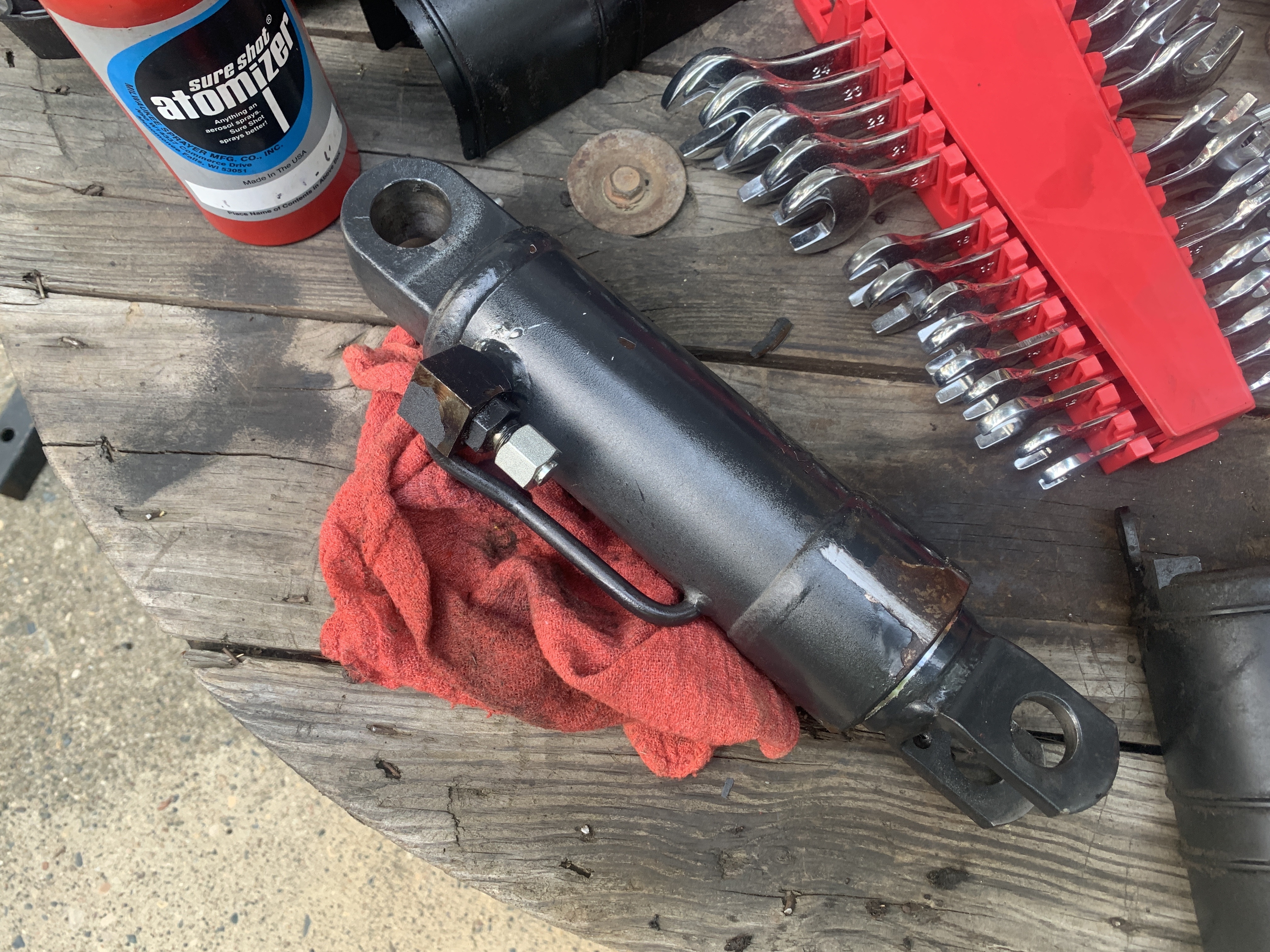

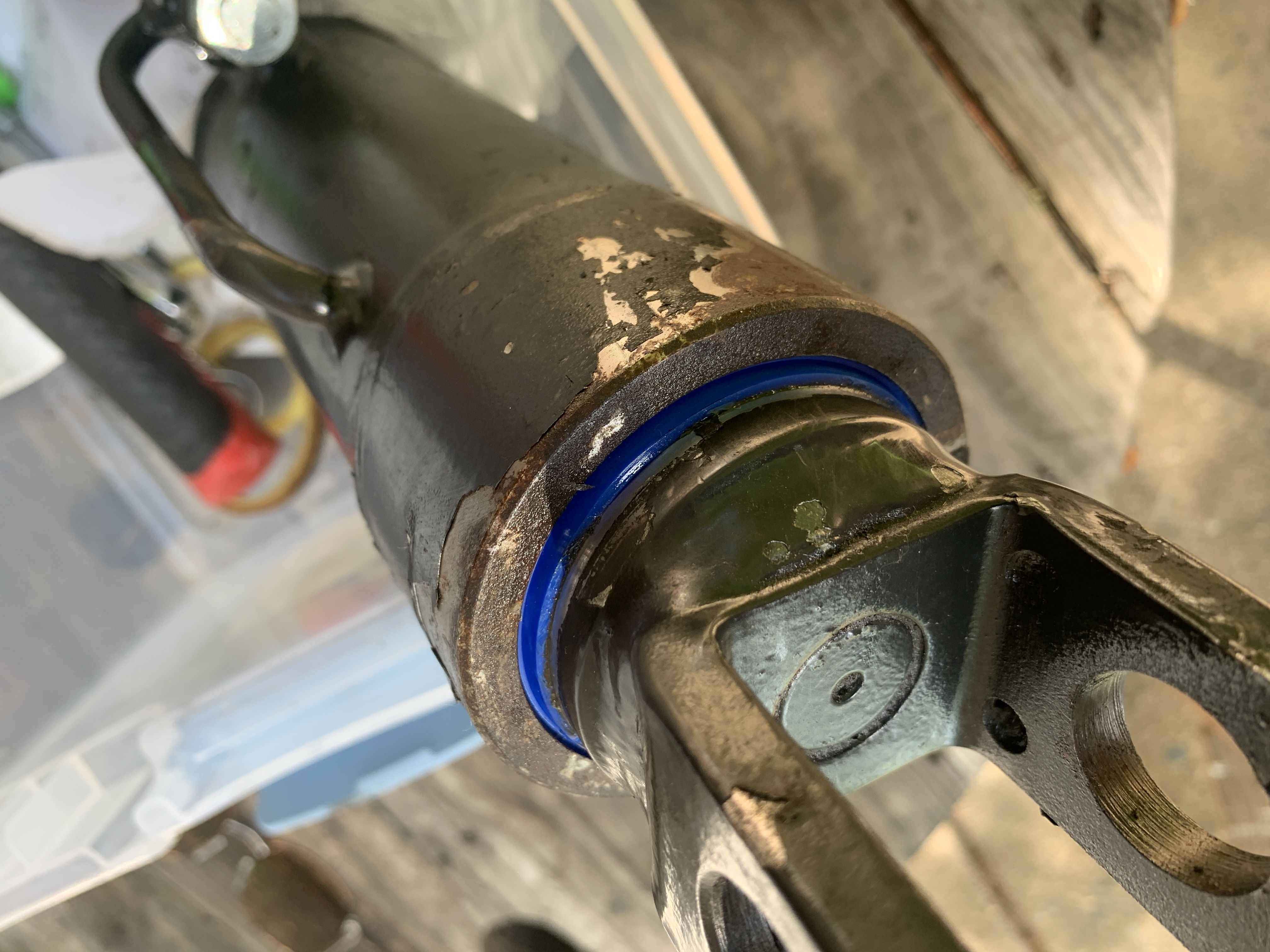

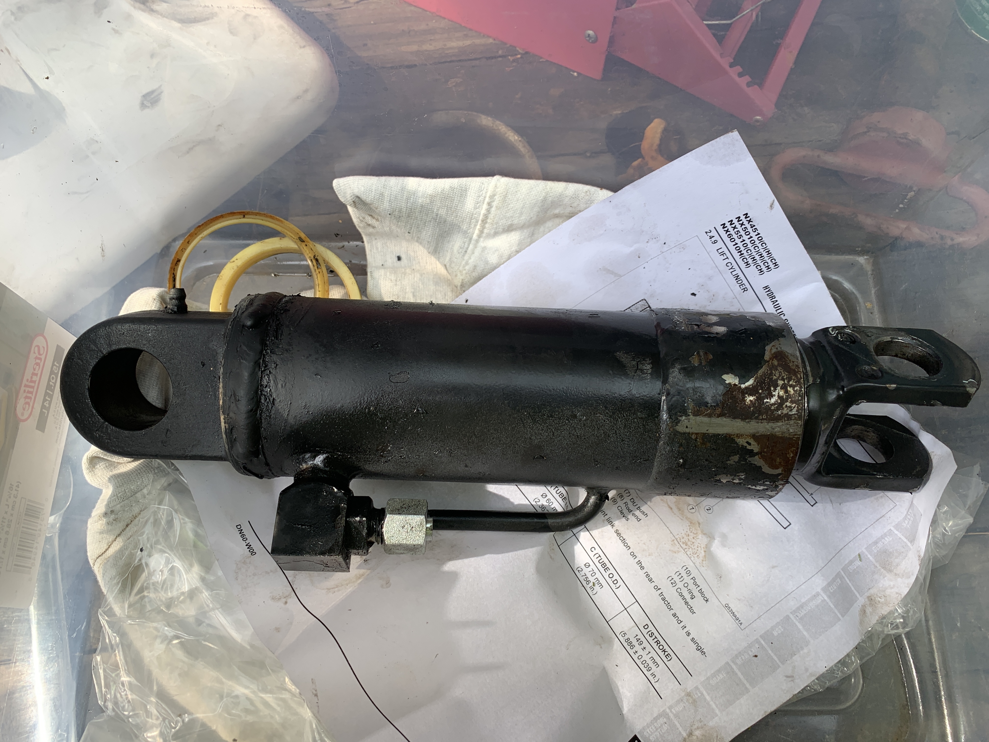

After fixing two major hy-tran leaks last fall and only using my tractor once over an unseasonally no-snow winter, it wasn't until this spring while making slash piles that I noticed that I was going through a few quarts of hy-tran every day and I couldn't find the leak. Well, it turns out that after being exercised, the lefthand three-point lift cylinder leaks like a sieve so my mystery leak has been found.

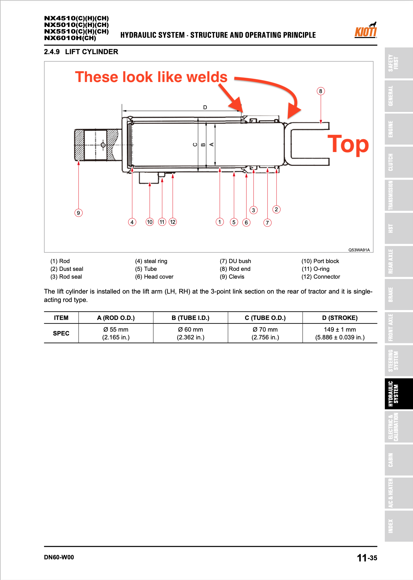

Moving forward toward leak-free paradise, I looked up the lift cylinder in the parts book for a rebuild kit and there isn't one available. Looking in the service manual, I cannot tell if the cap for opening up the cylinder for service is welded on or not. My local machine shop can find any type of seal in the world so a lack of service parts isn't an issue, but if there isn't a way to open up the cylinder, the machine shop would need to chuck up the cylinder on a laith and cut down the weld, replace the guts and then weld up the cap.
Removing the lift cylinder looks like a bit of a hassle to gain access to the hydraulic line in the back of the lift cylinder, and after doing the Hy-tran service my tractor suddenly will not start (but I haven't begun to look into it other than to look at all the safety switches and key on, crank it with a remote starter where the tractor cranks but does not start so something is causing the fuel solenoid to stay off or the ECU to not fire the injectors).
Anyway, does anybody know if the NX-series lift cylinders have their lift cylinder caps welded on or not?
Service manual diagram
The source where a plastic shield is covering up the cylinder's cap so I cannot see if it is welded or not.

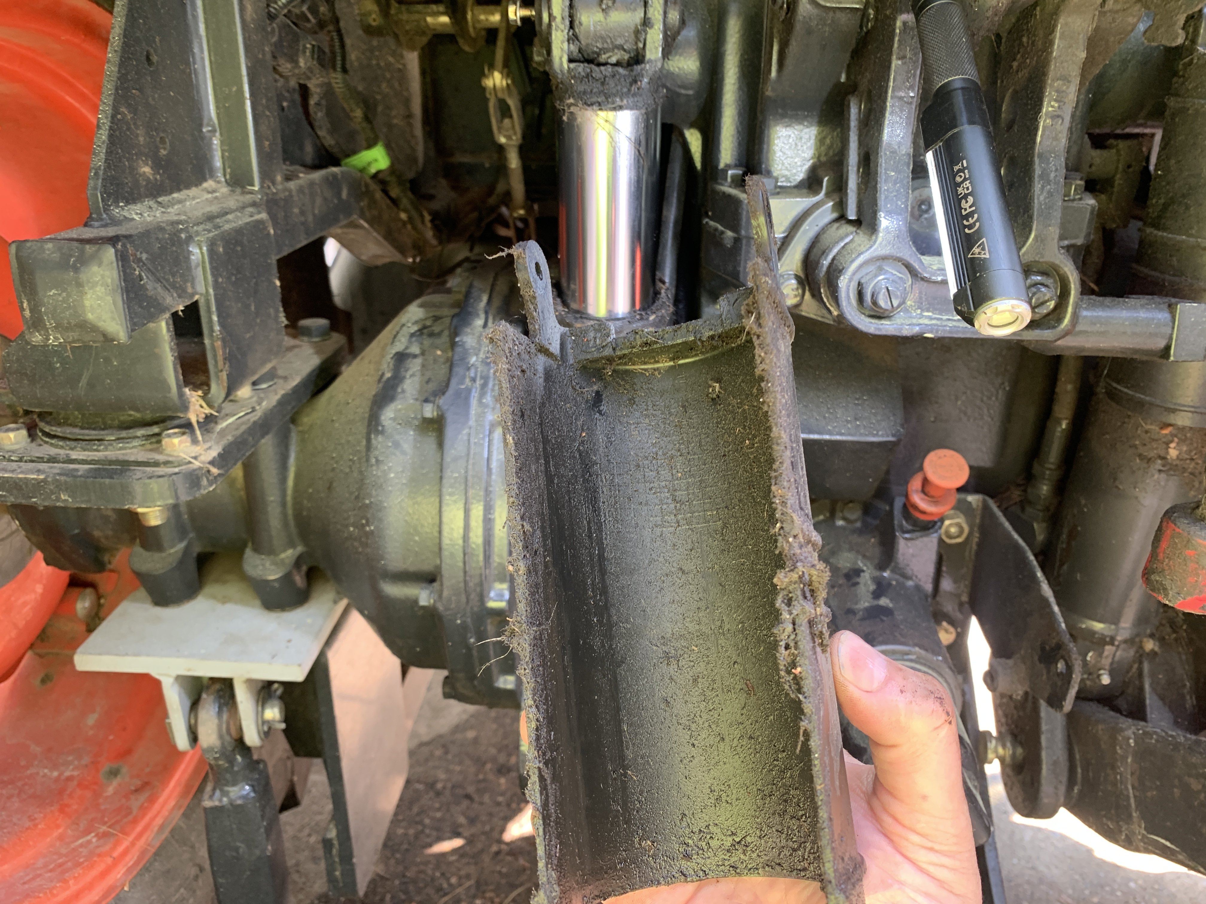

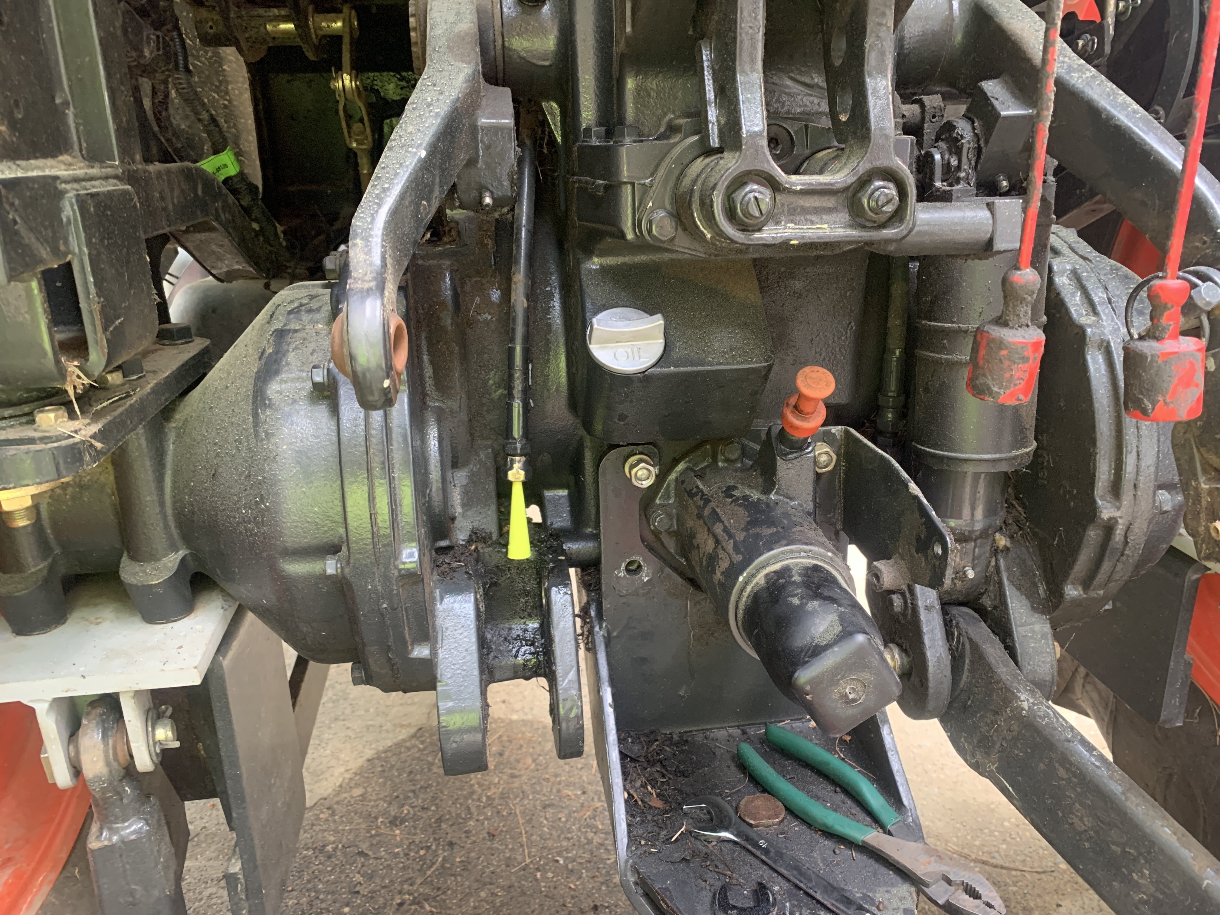

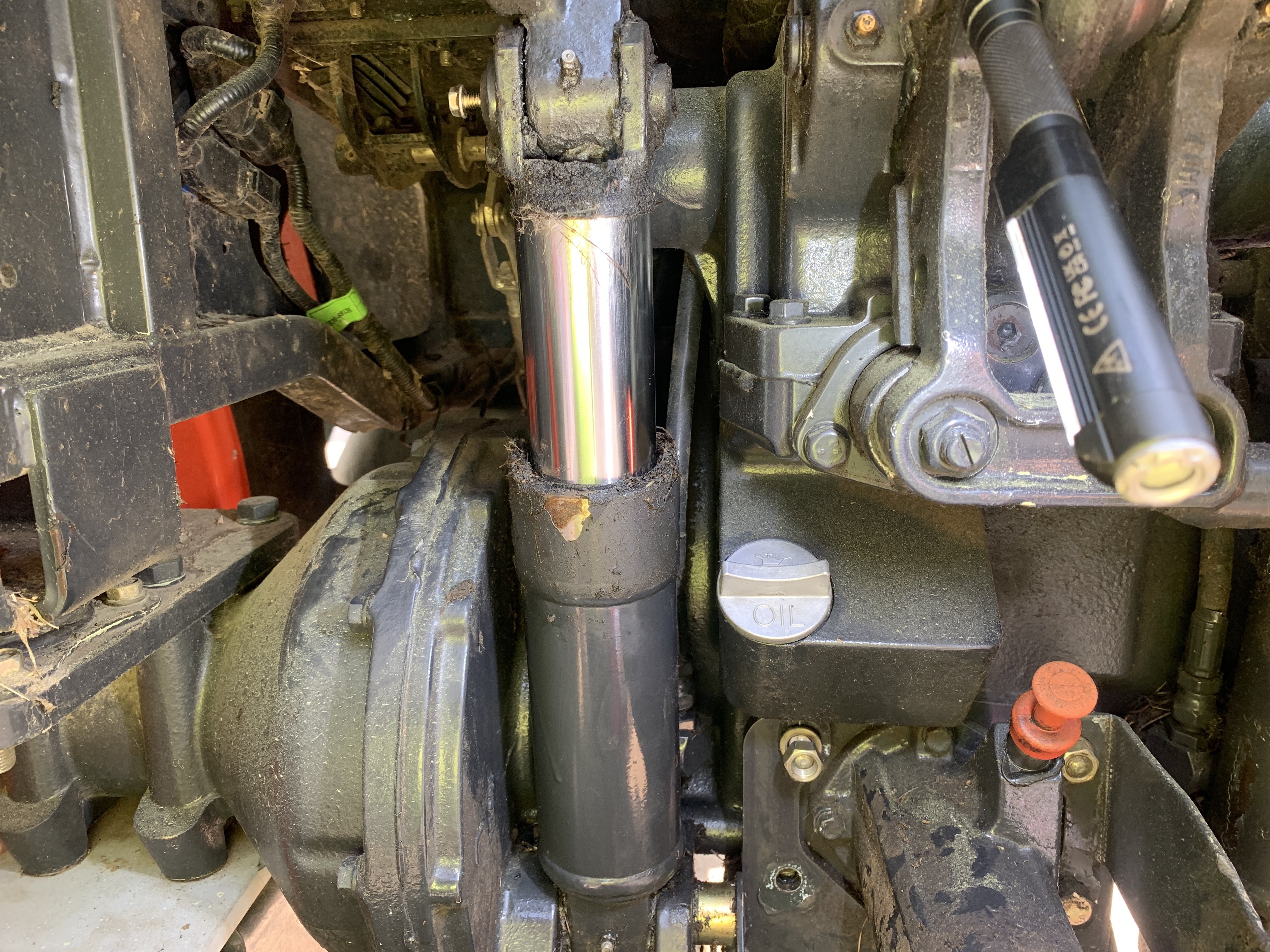

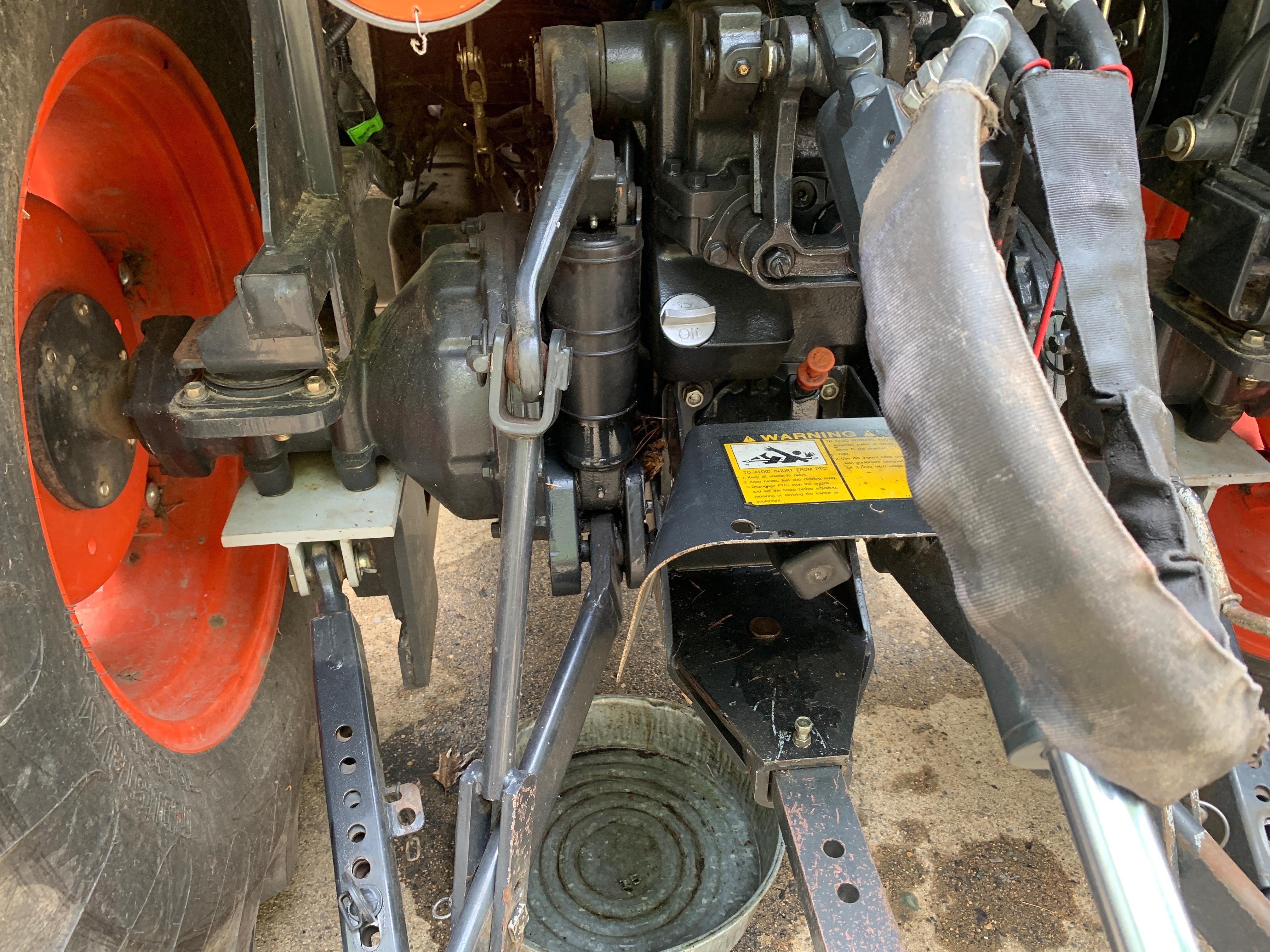

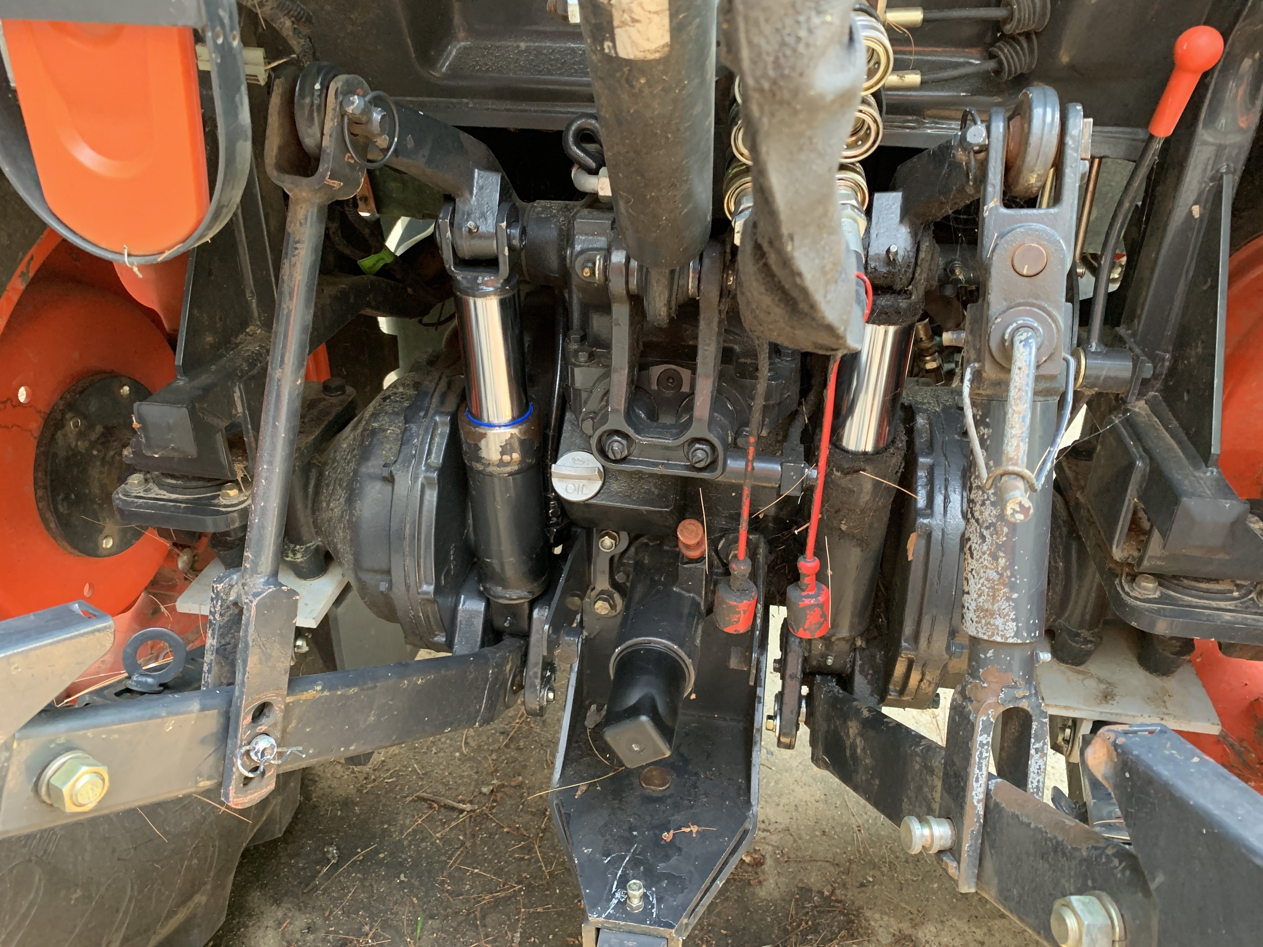

Since my tractor has not been wanting to start, it has taken me a bit to get around to the lift cylinder.
So things to know:
1) the three-point lift cylinder is mounted RAM up and so with the plastic guard in the way, you will not see crap collecting on top of the dust seal. Thankfully, one bolt holds the guard on each lift cylinder and I suggest popping off the lift cylinder guards once a year with the three-point raised to clean up the dust seals on the lift cylinders.
2) it is pretty easy to get the lift cylinders off, just make sure the three-point is all the way down before cracking open the cylinder's hydraulic line.

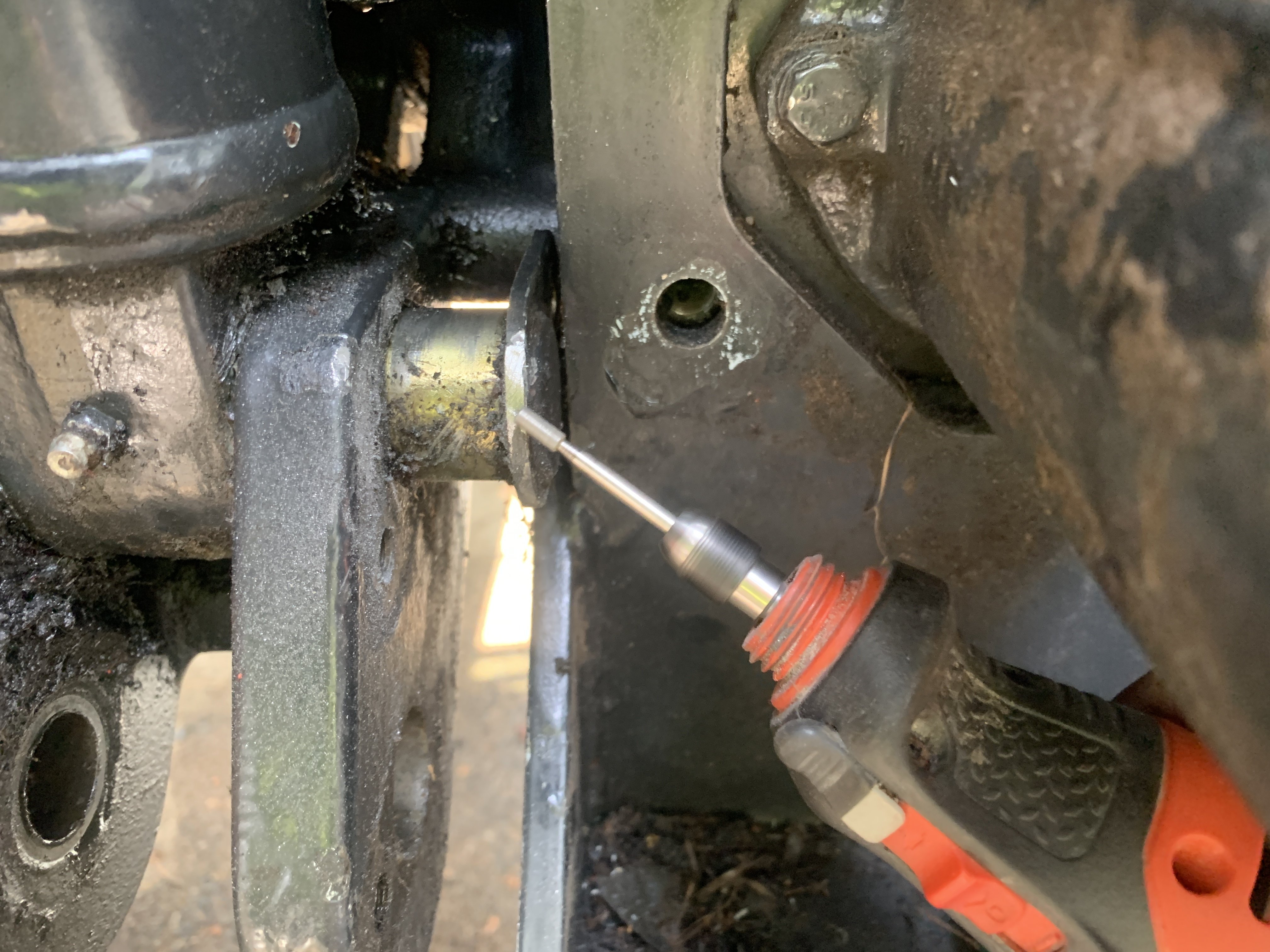

3) to remove the lower pin, I did need to grind on the heel of the lower pin's flag a little to get the clearance to remove the pin as not doing so would require dropping the entire drawbar.

Looking at your diagram I would say item 4, the "steal" ring is the key here. A number of single acting cylinders use that method. The difference here being that the one's I'm familiar with use a straight open port for the oil supply. You can look (and work) through the port to position the rod so you can work the "steal" ring out of its groove. Then the rod slides out and exposes the seals and wiper. With that welded elbow block for the fitting I don't see how you can do that.
I'm bringing the cylinder over to Matt at Boyer Mechanical in Bemidji where he can chuck it up in a laith to cut the weld off of the cap and replace the guts and weld up the cylinder again. What I did remember is years ago the bolt holding the flag for the right side lift arm pin fell out and the lift arm pin did a Peter Pan never to be seen again To get back to work, I shoved whatever pin I had and a snap ring in to get back to work.
Now, I cannot find the part number so I'm bringing the left side liftarm pin with me to Bemidji and popping into the Bobcat dealer to see if they can find it since it is metric.
