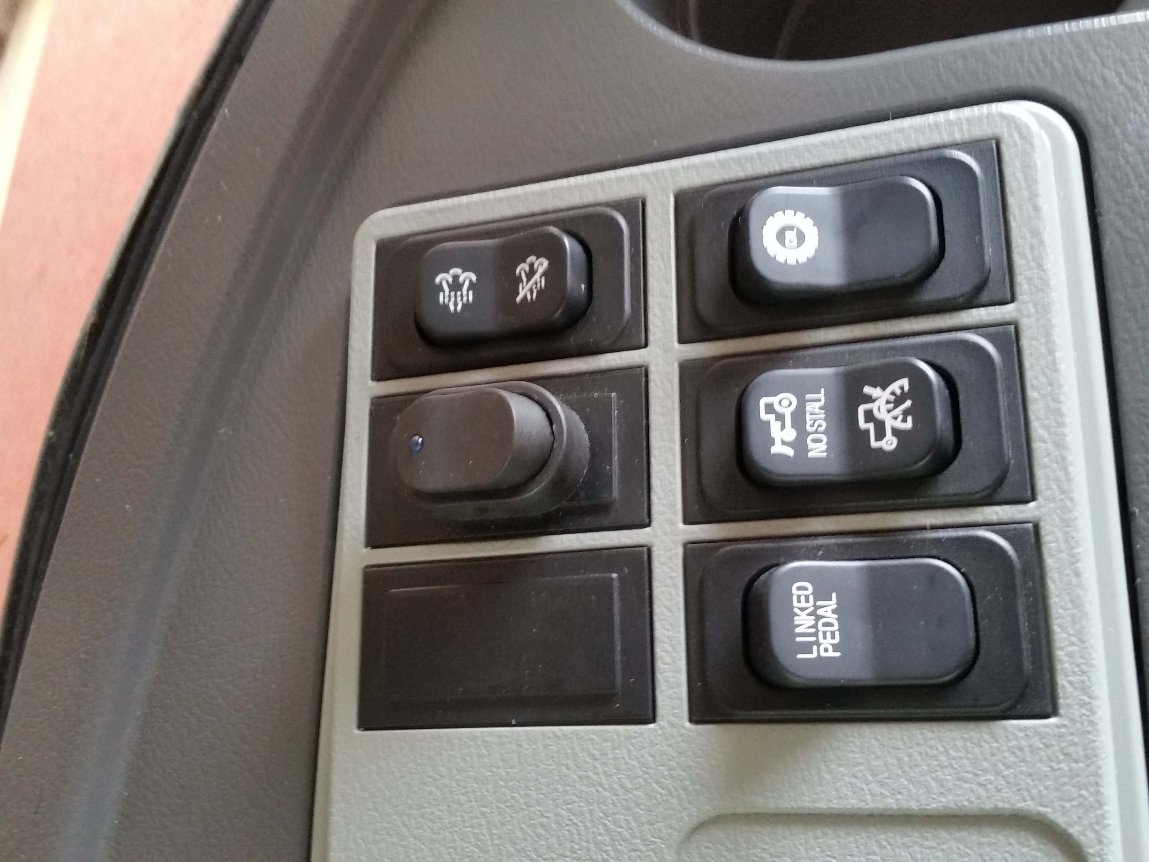

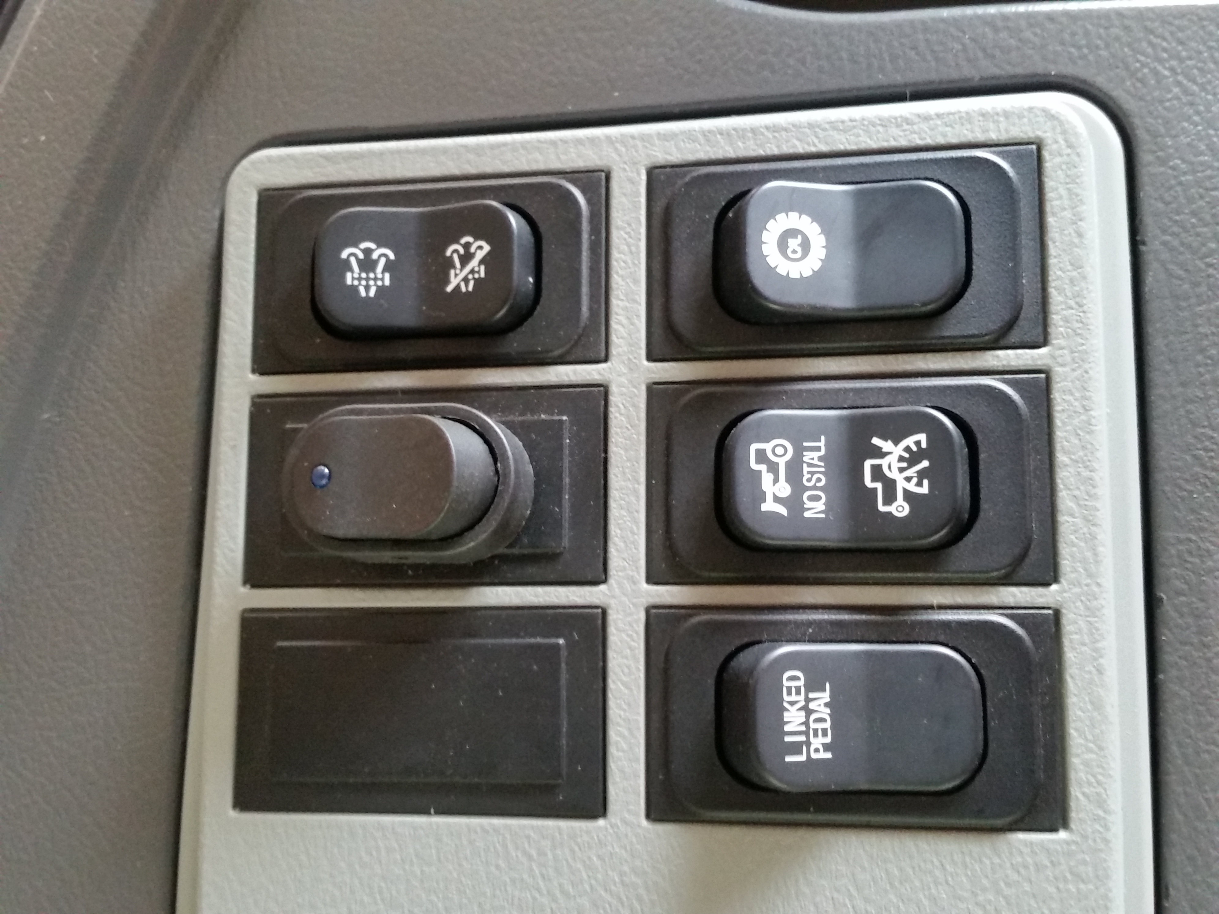

Most will think this is crazy and wonder 'why' but it was raining and I wanted to take a day off and play so I did the seat switch mod for the heck of it.

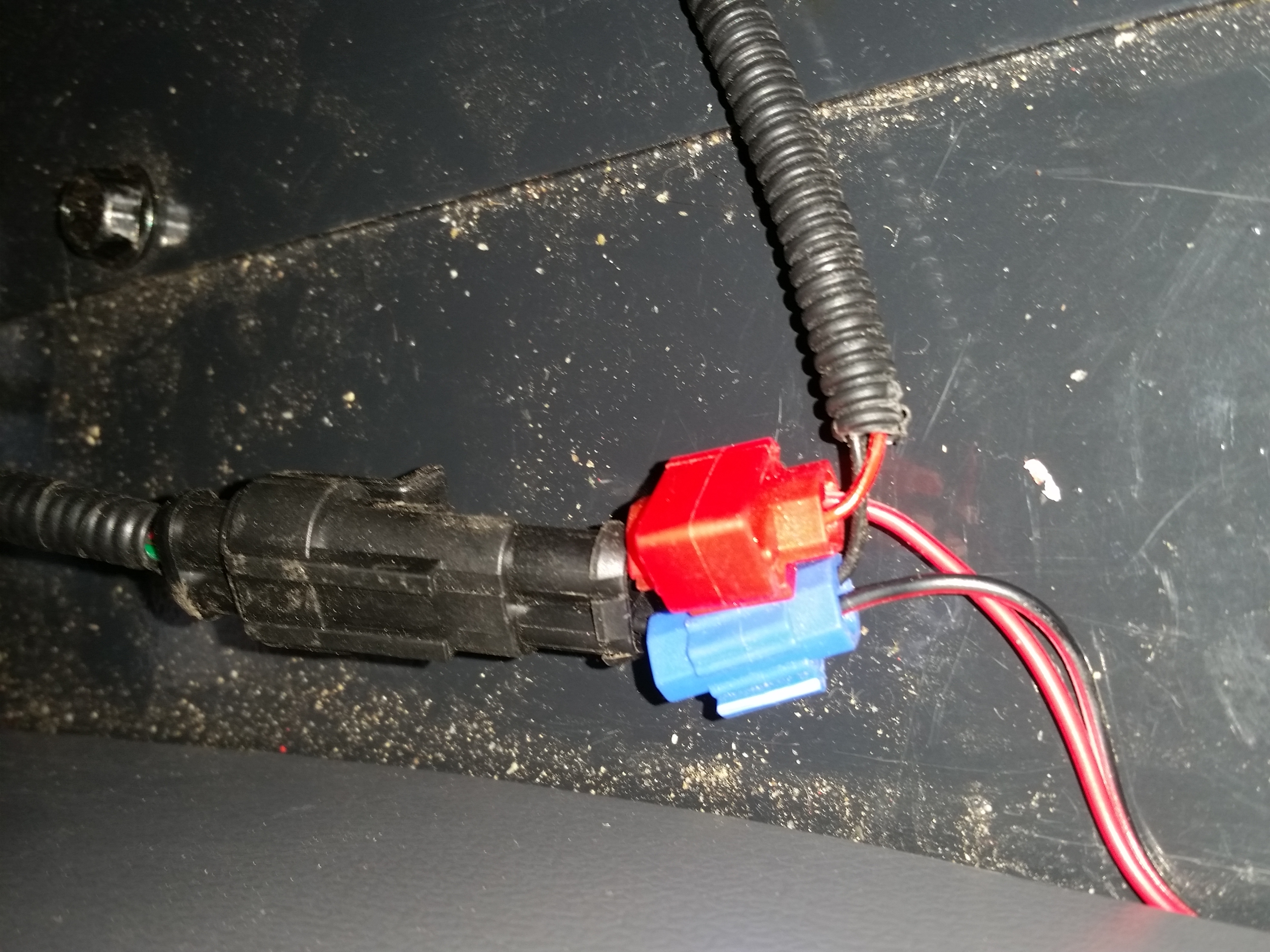

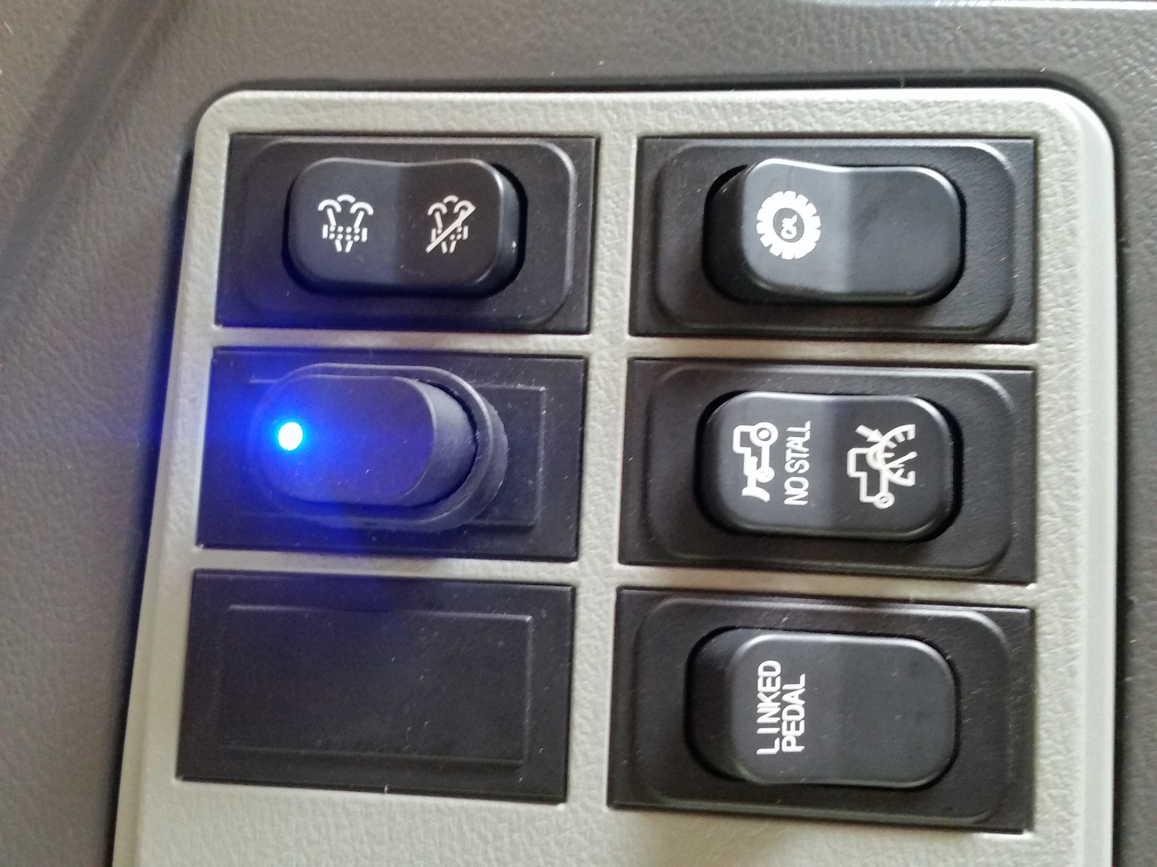

I already put the standard jumper wire in but decided to put it back and make a different mod. So I started by checking the schematic and and verified it is a 12V signal. I measured the current and it is just over 8ma. An LED lighted switch operates just over 8ma so I paralleled wired and ran them to the switch console and installed a blue LED rocker switch. So now, in the off position the seat operates as factory. In the on position it bypasses the switch and when you get off the seat it illuminates blue. Anyway if for some reason I want to put it back to factory I can with the flick of a switch.
Pic 1 - over ride on with butt in seat
Pic 2 - over ride on and butt out of seat.
Note - they make dual LED lights and would be easy to modify this to illuminate green when in factory mode and red when disabled but the switch delivered was almost $20 so I just used this switch.

The seat switch is 12V circuit @ just over 8ma

   / NX safety seat switch mod
Reread my initial post. The circuit is approx 8ma. It is basically a continuity circuit. Bottom line is ANY switch will work. IF you want a lighted switch it MUST be an LED since the current isn't enough to use other light switches (not enough current to lite it up)..
If you don't want a light and you just want a normal/bypass then ANY switch will work and you do not need to concern yourself with current.
No, an in line fuse is not required.
