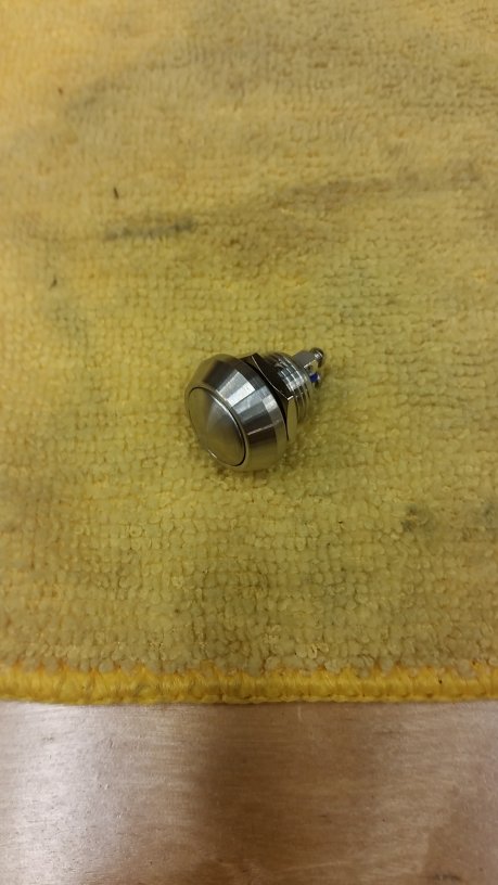

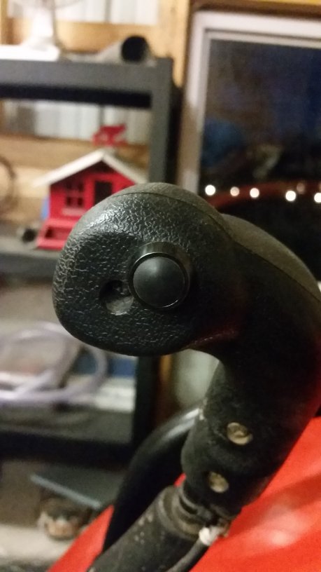

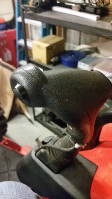

Would you be able to post a pic of that? Love to see what you came up with.
Switch was 12 bucks or something Amazon Prime. Stubby in back and a 1/2" hole accommodates it. Picture of a spare switch in metal. I'm using the diverter so the switch just activates the relay and doesn't need to carry much current. I have used a diverter on my last two tractors. True third function is overkill for what I'm doing. I never need to do all three things at once and that veers off into the realm of sufficient hydraulic flow even if you wanted to. Personal preference. The position of the switch feels very natural there. Don't even think about it any more. I keep a grapple on front most of the time and it gets lots of use.
View attachment 600637View attachment 600638View attachment 600639
That's pretty cool. Thanks for posting!

A lot cheaper too, looks like possibly room for a second button if need be. As he said a diverter is a bit simpler.
