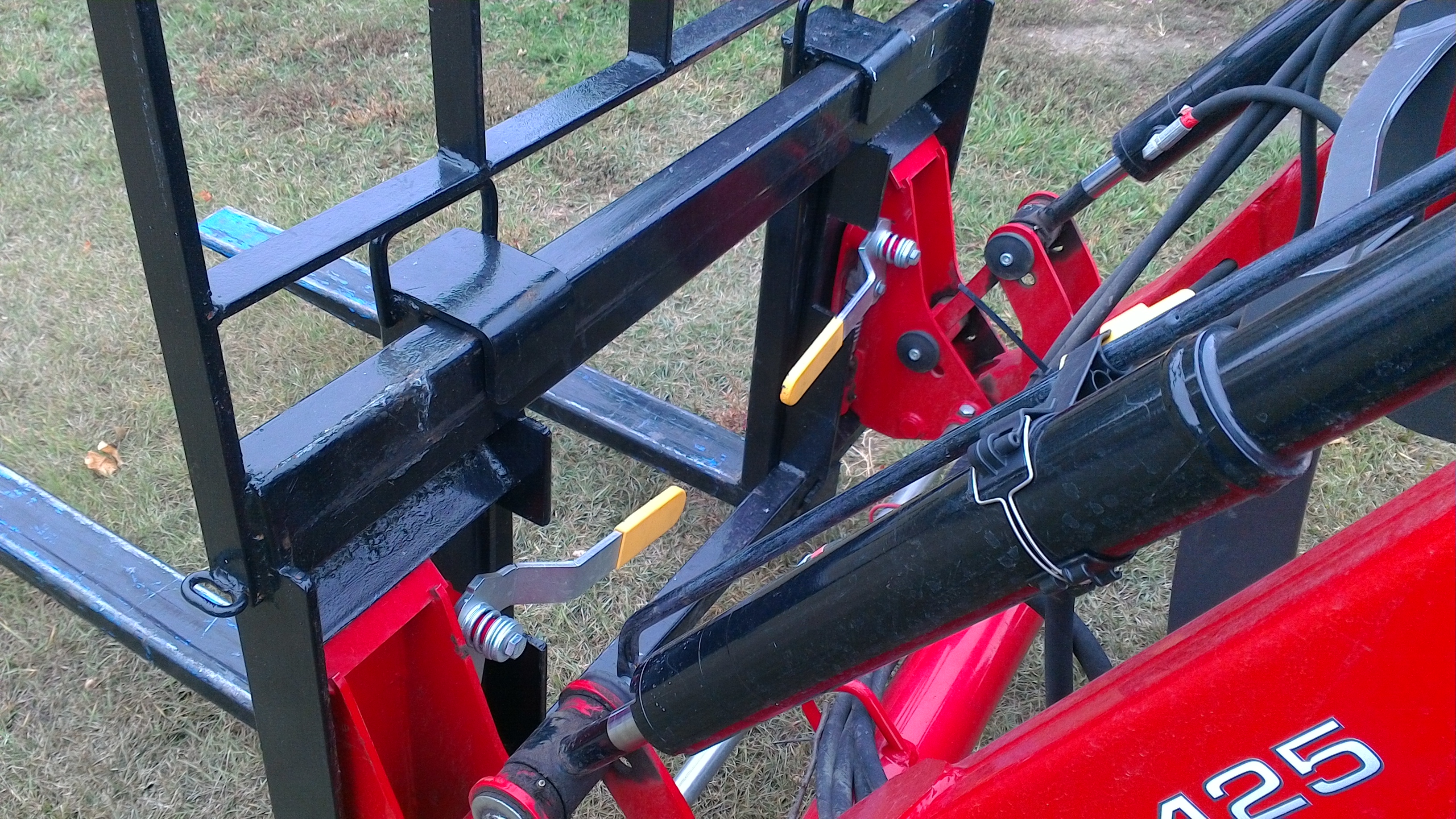

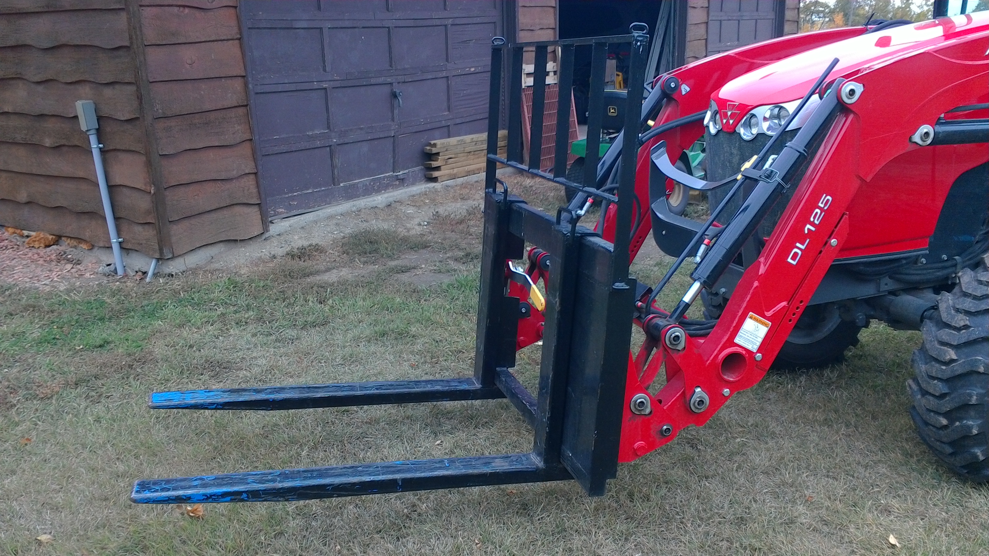

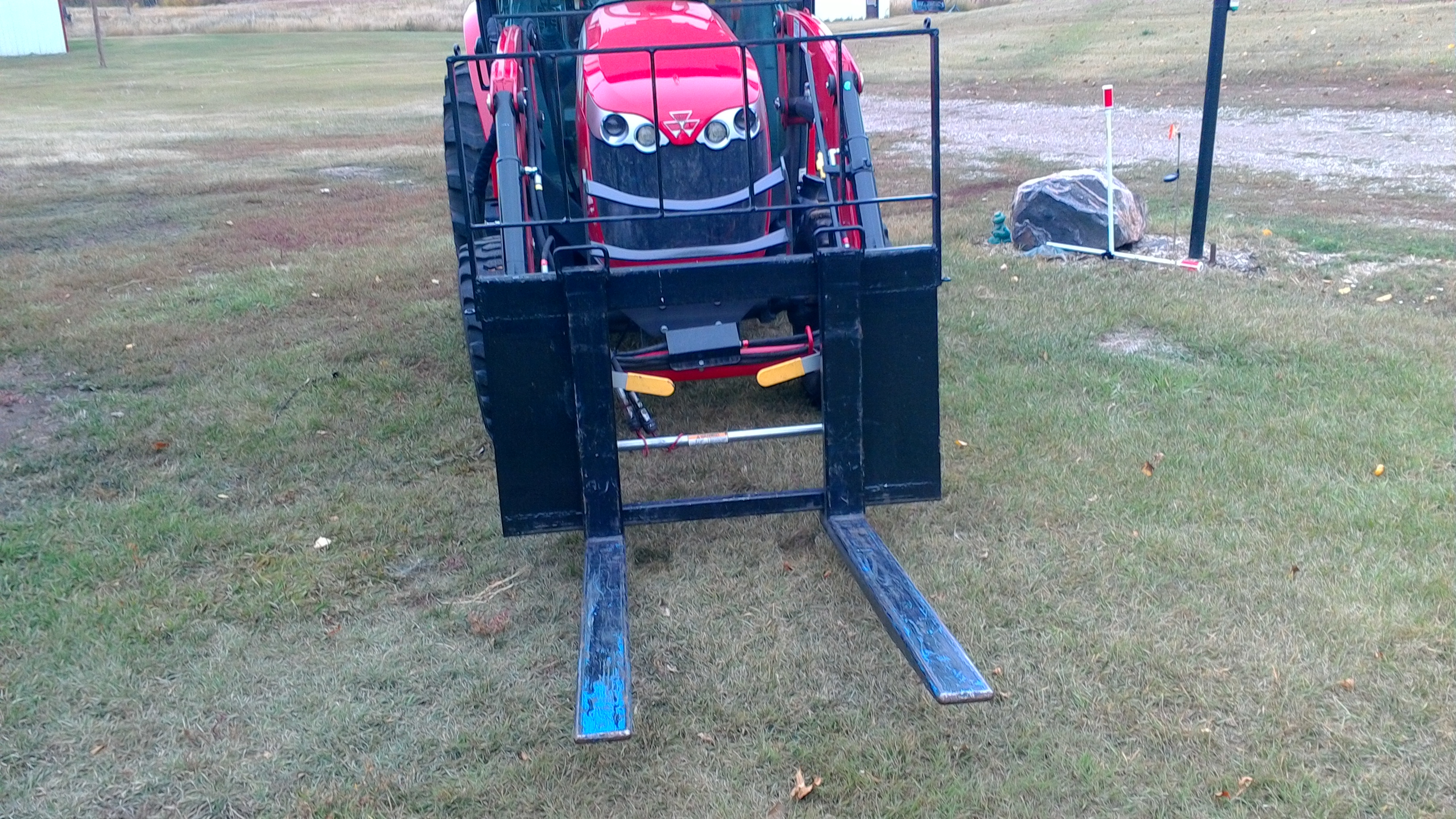

This was the first project for the Massey. Started out as bucket forks for the ford 3000. With the flex in the bucket, marginal at best. Massey has a quick change on the front so a pallet fork attachment was a no brainer. Forks are tapered as per a you tube video, fabricated from 2x4 .188 rectangular tube. Quick change parts were from the same 10 inch I beam as the land plane. Plasma cut but still lots of grinding. The guard is higher to accommodate fridges and pop coolers.

:thumbsup: nice...very nicely done.
