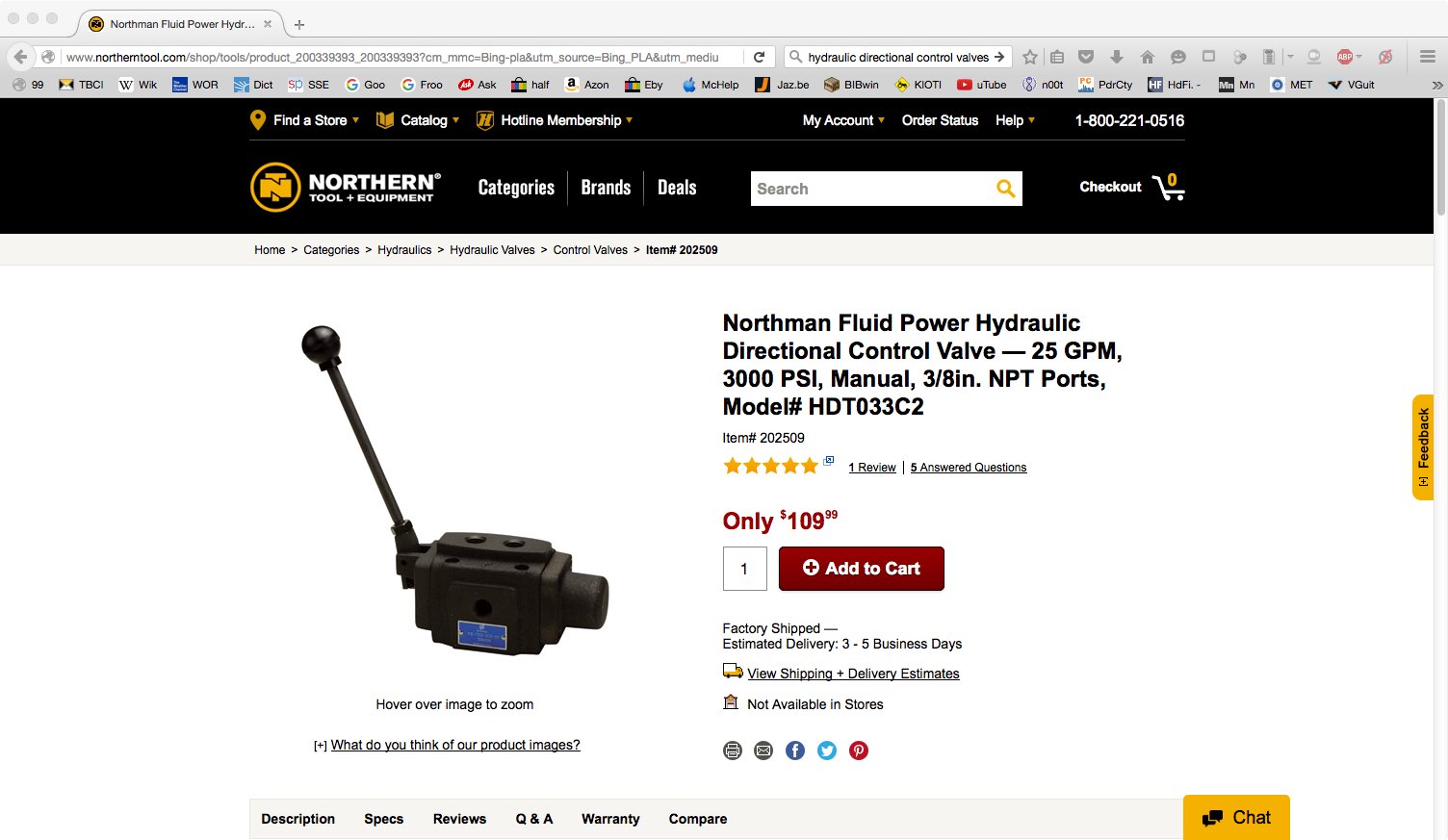

Got the blade today. Looks like they don't mind putting good amounts of steel in the right places. I will trust for now it's the right kind of steel in the right place.
So, I came with one hydraulic cylinder so I need two free hoses to hook up. I am assuming when I remove the back hoe It will become apparent where to hook up the hoses. I am not exactly a seasoned operator so this is all "there be dragons there!" stuff for me. I'm going to drop the BH on three thick flat rocks while I play with the blade. I might be able to find a good ole person to line me out on the 3 pt hitch assembly. I think I have all the parts so perhaps with the picture in the owners manual [that looks like it was taken a dusk thru a dirty set of panty hose]. If said person is not forth coming, are there any gotchas concerning the assembly that I should be aware of?
Thank you for your time.

I'm assuming you bought a back blade and it has a hydraulic cylinder to adjust angle. Was your BH powered through rear remotes? If so, hoses from the cylinder would connect there. 3pt hook ups are fairly straight forward. If you could post some pictures of the blade and the rear of your tractor, I'm sure we can help you get things working.

Will need a control valve to direct oil through appropriate cyl port unless I'm missing something obvious
Oil supply to hoe on my machine is supply line in and out and valve body on hoe is used to direct that oil flow to various cylinder ports

You likely have a cylinder on the rear blade with a rod end fitting and a cap end fitting, each with a hose attached. As stated your backhoe has a control valve to open and close various cylinders as needed. Your blade is missing that valve, so just hooking to the rear remote fittings won't allow you to control the cylinder on the blade, without adding a valve for the fluid to flow through. Pictures and existing equipment are needed for us to tell you what/how to do what you want to do. :confused3:

Yep. You have to have a place to hook to (remote) that has a control valve used to angle the blade

My B26 TLB has no remotes for hydraulics. It simply has a supply and return hose. When the hoe is removed, I have to connect the supply to the return (simple male and female hydraulic coupling). If yours is like mine, then you will need to install some rear remote hydraulic port and valves. This is not a cheap operation either so be prepared for big $$$ to have this done.

Saul at Rivera Machinery in Tx.suggested a possible solution to avoid buying a control valve. With the judicious placement of two pieces of angle iron on the loader cylinders, I could use the joy stick for the loader as the control valve for the blade. I would just have to buy the hoses to make the connection from the blade cylinder to the joy stick. .I do not understand hydraulic systems enough to know if he is correct. Is he? will be sending some pictures later today.

What sort of control valve specs would I need to operate that cylinder on the rear blade if I can find something at northern tool? There is a Brand Directional Control valve rated @3000 psi @ 99 bux. I'd prefer a dedicated valve over swaping hoses from the Joy stick if it's financially possible at a figure WAY under 600.00

I know only that 7 gpm is the flow rate for Kioti why no pressure spec. It might matter when making valve choices. Can anyone tell me please if the valve pictured will do the job of moving the 6ft. blade under load. Or is the cylinder supped the limiting factor in the under load category. I'm talking about possible changing the angle of the blade while the tractor is moving. If this valve is not up to snuff if you can tell me why I may help with other choices. If someone has a suggestion I'd love to hear it [ under 200 if possible ] I know some well off people have tractors. I'm not one of them.
