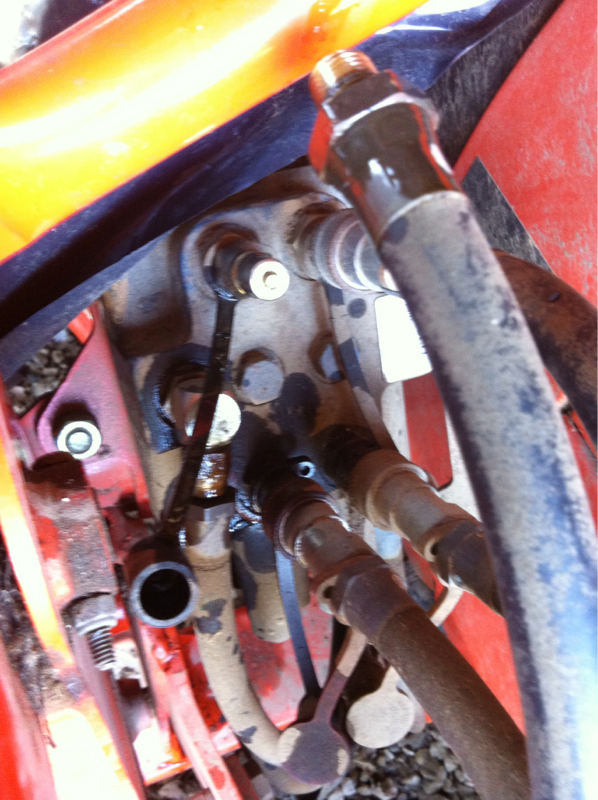

Can you help me identify the curl back cylinder and what the other connection would be? The picture below is looking at the box from the front of the tractor
   / Now that I have my 3 point splitter #7
Easiest is to follow the hydraulic line that connects to the end of the curl cylinder furthest away from the operator. To verify, relieve pressure on the FEL first, then disconnect that line and try to curl the bucket back. If it still works you have the wrong connector, try a different one.
I assume the other connection you're referring to is the return line, probably the easiest thing to do is just plumb it into the filler port on back of tractor since that's where this thing mounts. They make a fitting that pushes into the tank port and seals with an o-ring, connect the return hose to that.
You might consider having the dealer hook this up for you, they can make up the lines and have it all done in one shot. You're going to be going back and forth getting hoses and fittings made up, it can be a hassle if you haven't done it before and one mistake will wipe out whatever you're saving by doing it yourself. If you go to a good hydraulic shop they could also do it for you.

If your loader valve has PB, then make a hose with a male QD and use that for your supply for the log splitter. The return hose goes to tank.
When you are not using the log splitter, connect the PB hose to the 3pt input.

Thanks all for the help. It took a bit of trial and error, but I got it working. It's a bit slow, but I'm not in the wood production business –*this is just for me. Probably a bit safer too.
Thanks again to everyone who chimed in.
