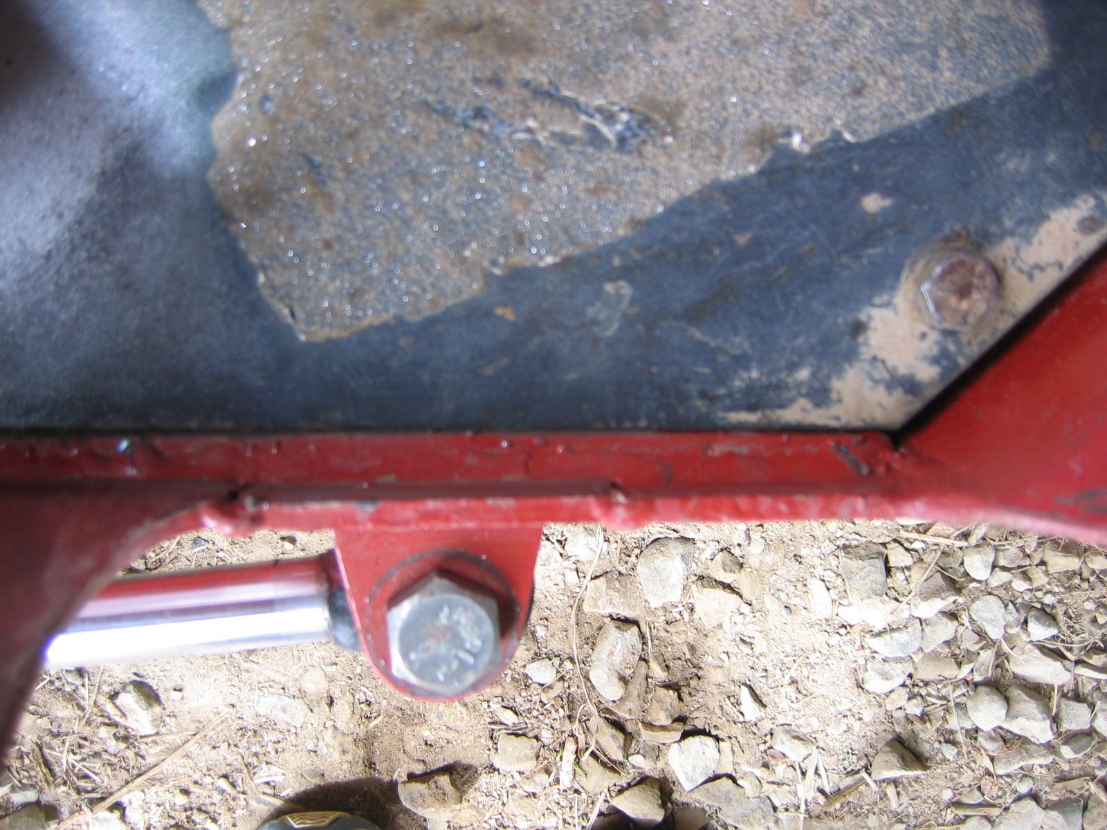

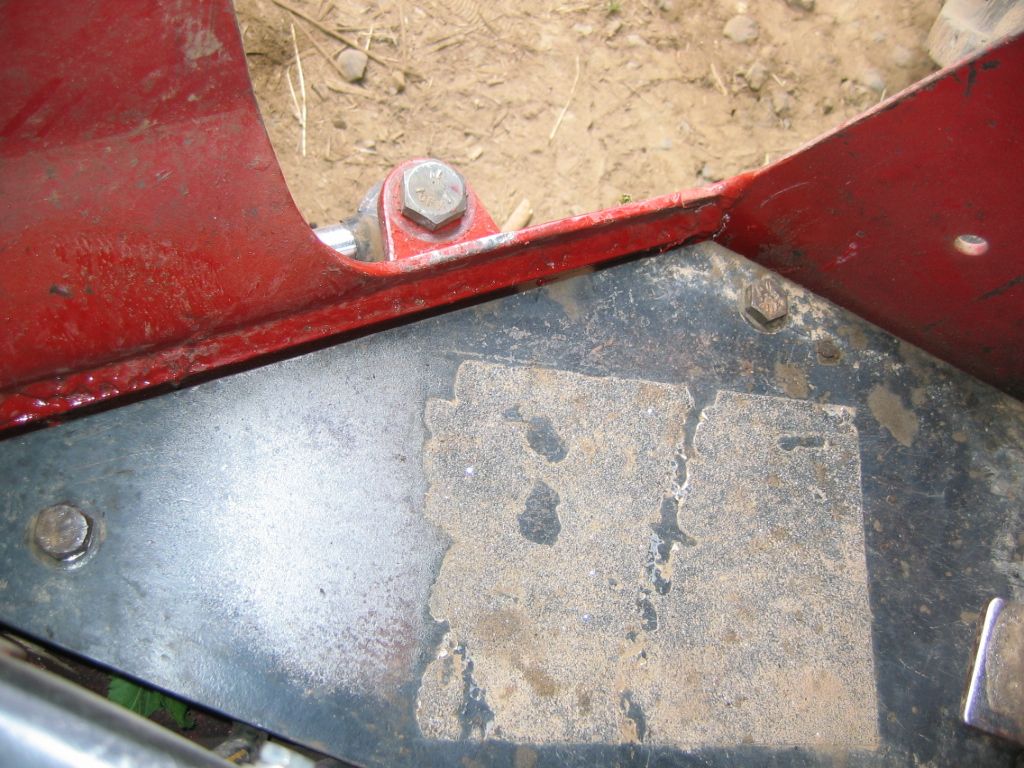

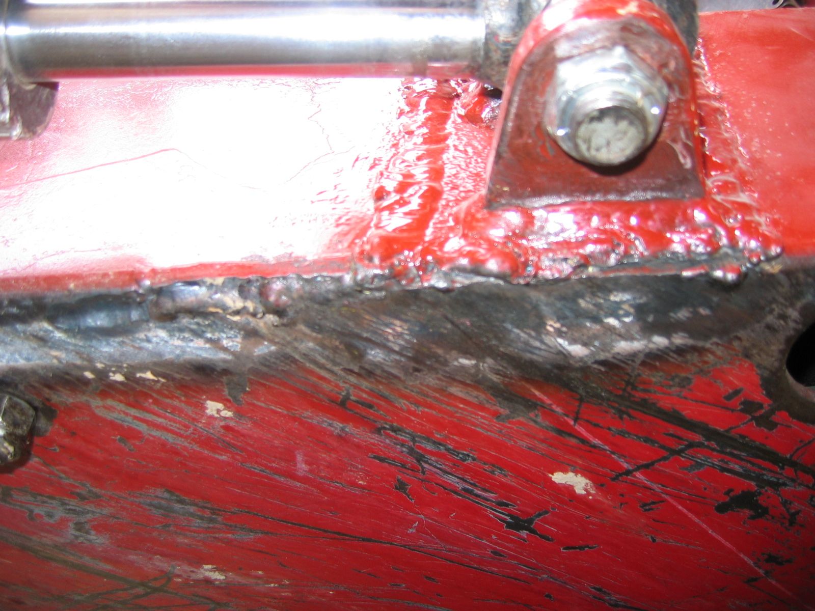

So, as a novice. What is wrong with these welds? Just so I have something to take back to the guys for future stuff....

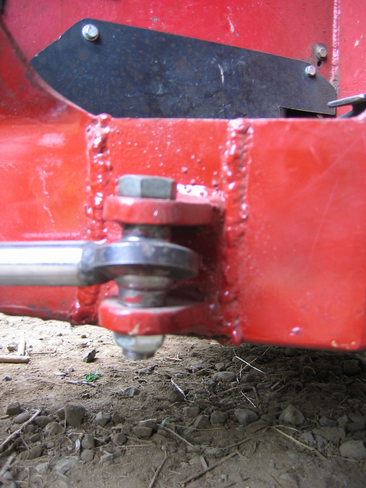

Carl,
They are just basically sloppy welds. I would go back to the owner with either the machine or your pics. I would give him open ended questions like this- "What do you think of these welds?" And, "How would you feel about paying 7+ hours labor for this job?" You can point to some factory welds and tell him that this is what a weld should look like. It looks like they stick welded it and it is obviously an amateur vertical stick weld. If I did a weld that sloppy, I would at least have ground it down so you wouldn't see it thru the paint.
Also, look at your last picture. The steel they welded on looks crooked when you eye it up to the rod on the steering cylinder.

Sloppy weld for sure. Whoever did that weld needs more practise with his 'vertical up'... I second the suggestion to go back to the owner and show him the work his guys are turning out...
I also would prefer to have the welds ground down flush with the surface and painted over. Even considering the resale value of your machine, if I were a prospective buyer, i would steer clear if I saw that weld. Its a bit of a frankenstein job.
If that were my machine and I had to repair it myself, I would have welded in the piece that tore out and then welded a thick plate over that patch to reinforce the mount (on both sides). That seems to be a weak point in the design. No harm in strengthening it up.

Aesthetically, the vertical surface welds leave a lot to be desired; in fact, the one under the clevis looks suspect.
I don't see the plasma cuter holes that were rewelded, but I believe you that they are there.
However, the plate behind it is definitely over the top, and the weld on it looks OK. Provided the plasma cutter holes were rewelded reasonably, I don't see that this is going to fail. It is mega-beefy. I can imagine that they normally do big forestry stuff, and I bet they are used to fixing manufacturing defects.
With all of this added strength, you'll probably rip the hydraulic tank open, now that it is the weak link in the system. :) Seriously, I don't think you will revisit this repair.
