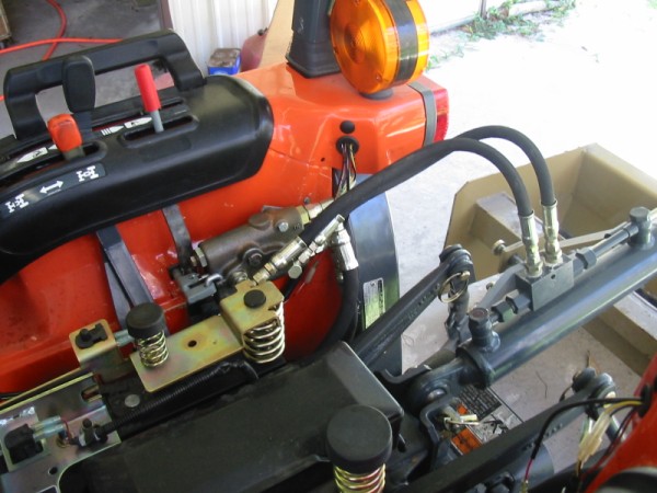

Here's a toptilt I recently installed. I used a real small valve that sits between the seat and fender . This is on a B7610 and it has an extra space in the fender next to the 4WD and 3pt. Really works great

This set up looks interesting.
For what applications would you need to use this setup?
From what source did you connect into to get power to operate the vale?

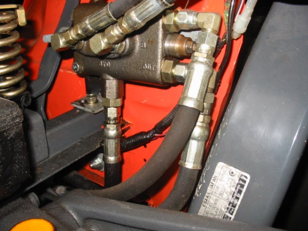

How have you got the valve mounted? It looks like you have it
bolted to the fender.
What brand of valve are you using?

   / nother toptilt
At present I only use it for my toptilt. The poewer comes from my FEL
   / nother toptilt

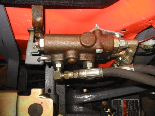

The valve is from Surplus Center # 9-4500 it s monted between the fender and the back cross member for the seat

   / nother toptilt
another shot
