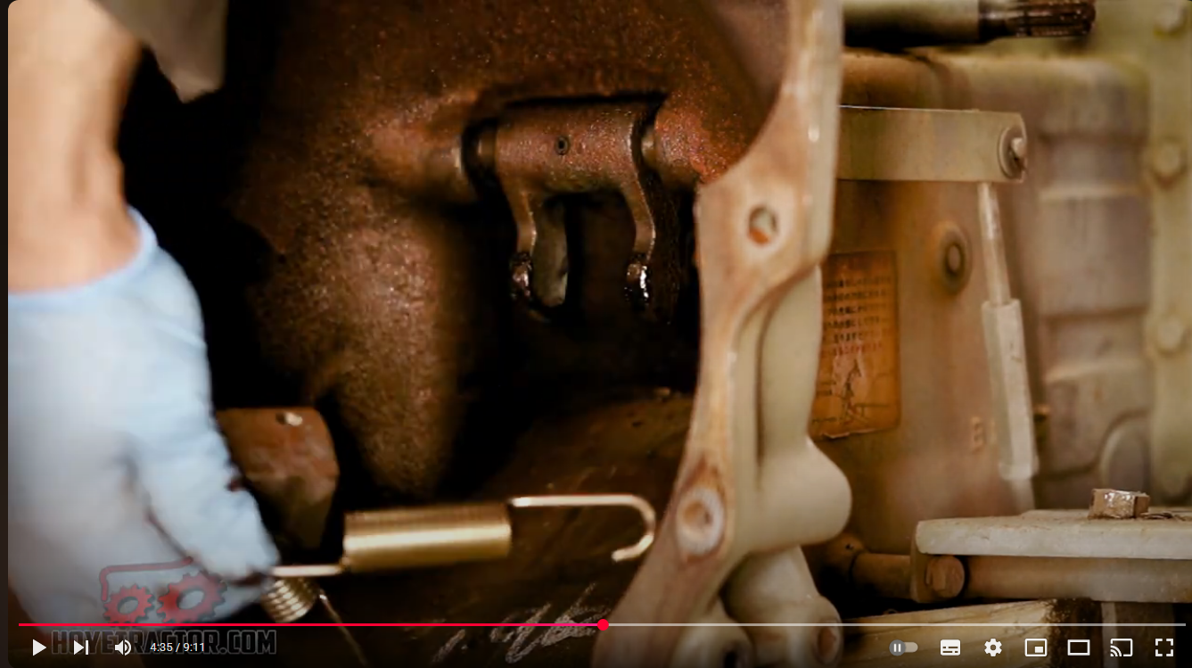

The crank arm attached to cross shaft, does it move up and down with the clutch pedal? I'm not particularly familiar with this tractor, but I assume the crank arm should be moving at least 3-4", measured at the linkage end. If the crank arm is moving in sync with the clutch pedal, then I would be suspicious that the crank arm has somehow spun on the cross shaft. Looking at an old video of a clutch replacement on YouTube, it would appear that the correct orientation of the crank arm is parallel with the roll pin that holds the clutch fork.
