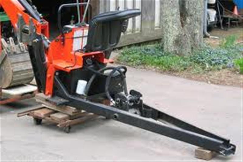

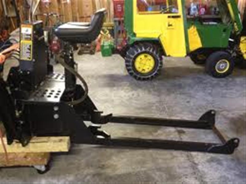

I built dollys for all my implements and park them on the concrete in my pole barn for this reason. Just park the tractor roll the implements into place. Changes a 30 min job to 5.

Lots of us do it on here. I just ger cheap casters at Harbor Freight then usually start out with two 4x4's. Some scraps if 2x6 or 2x4 & some screws and wood glue and go to town.
