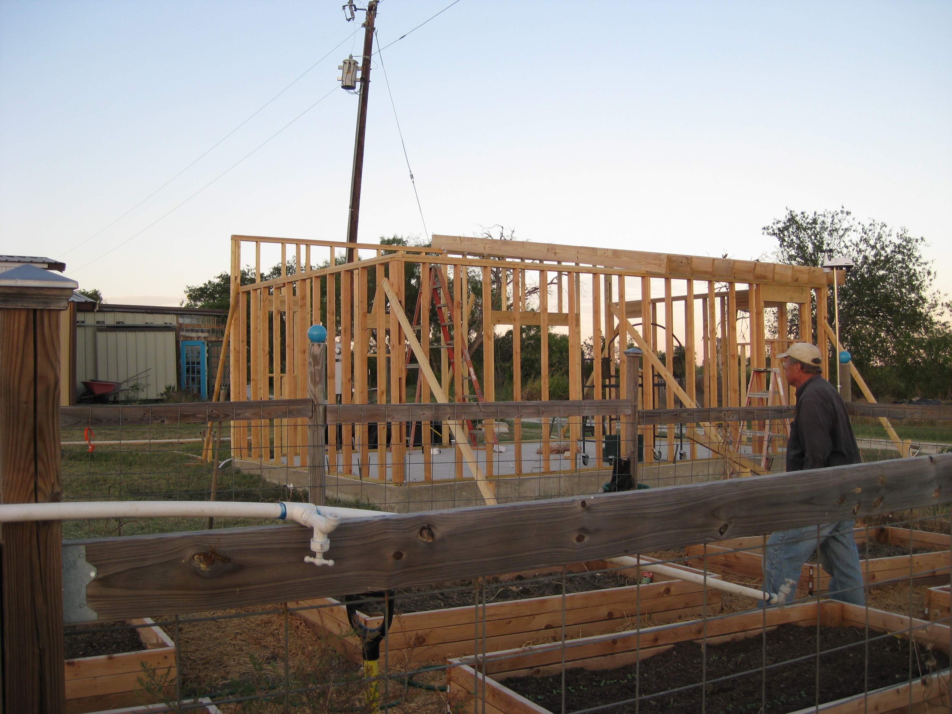

The wife is kicking my workshop out of her barn. So I am building a 16 x 24 shop (or lab as I have taken to calling it).

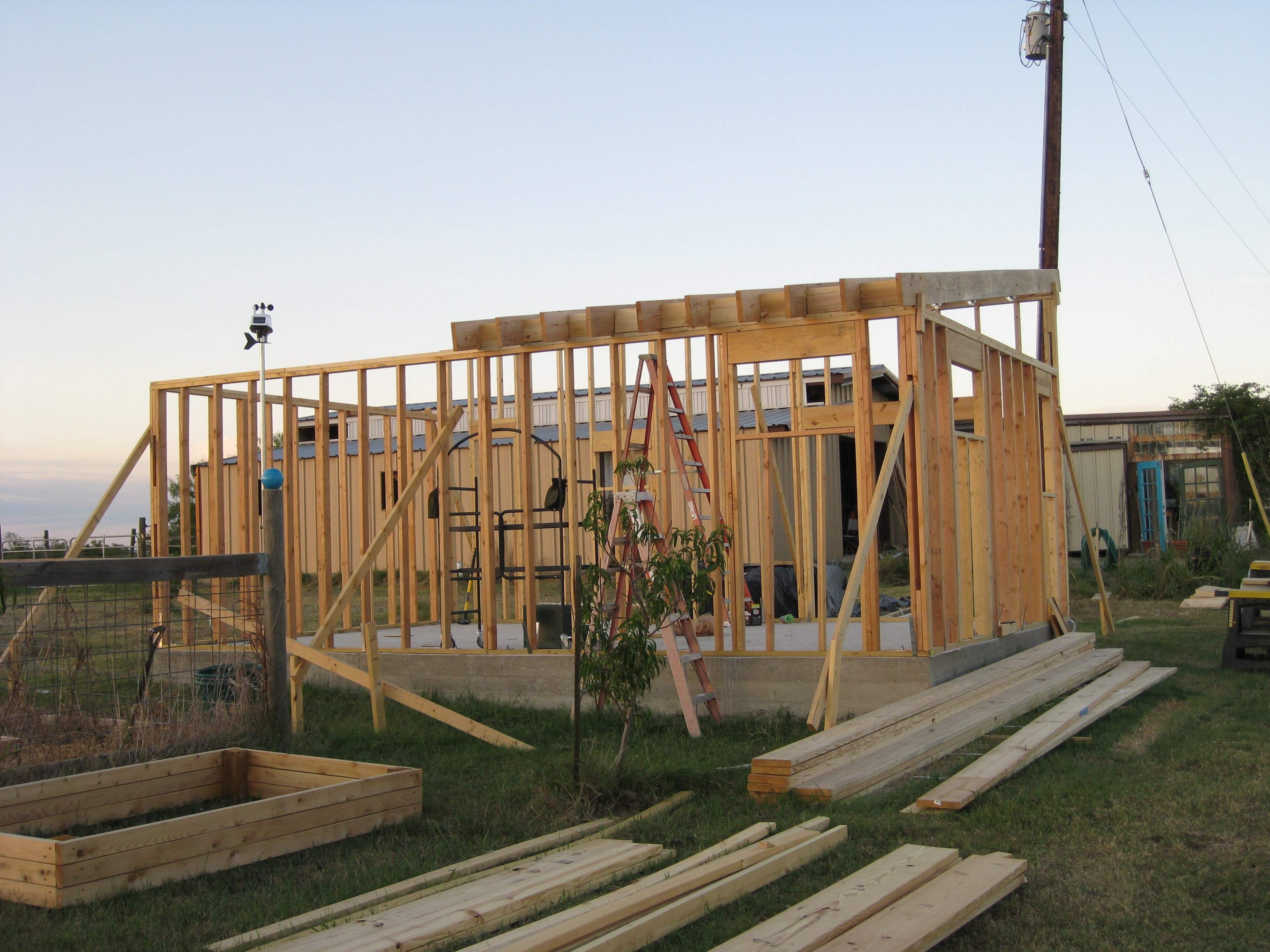

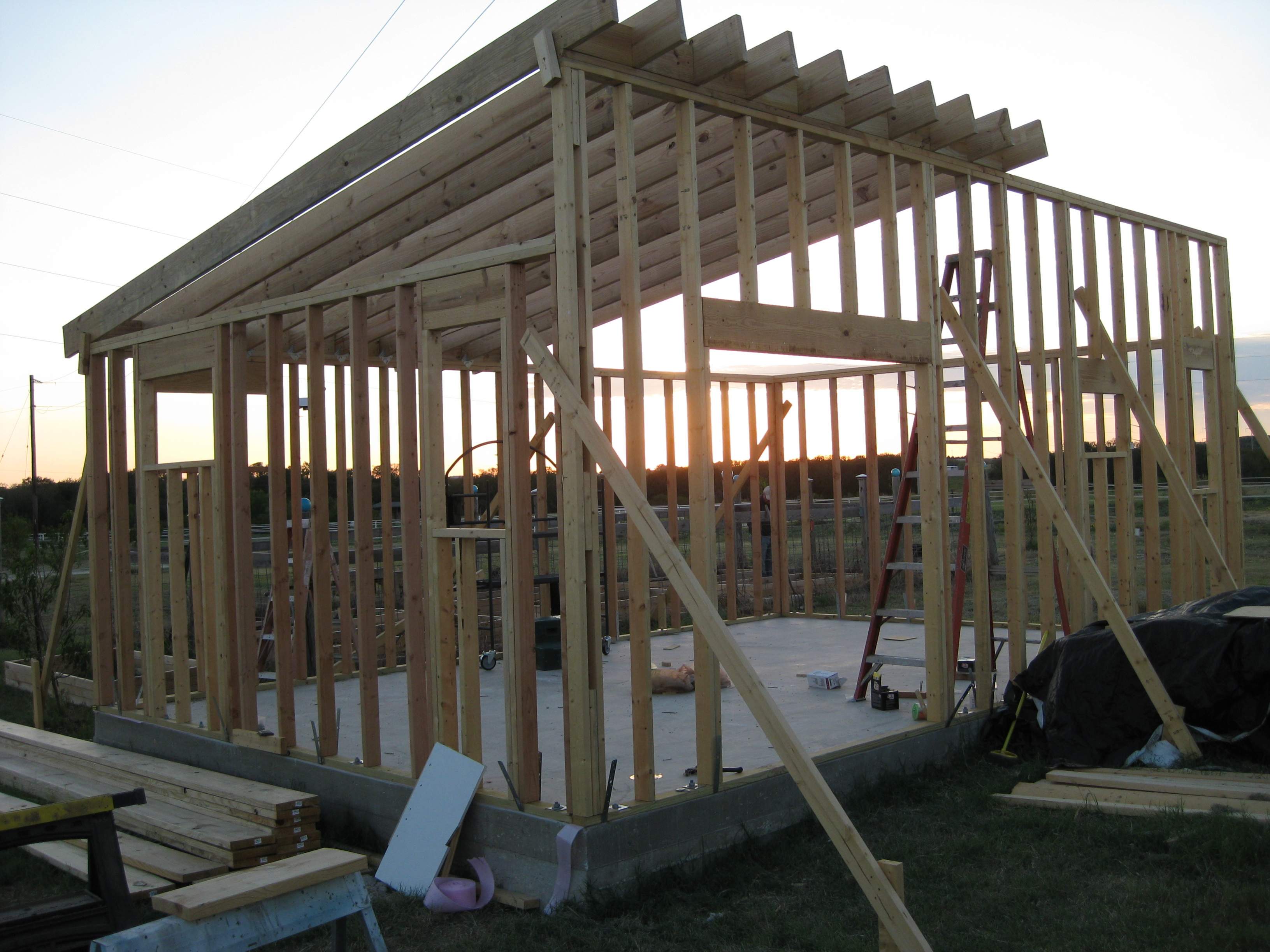

First time building a "building". I have done some light/moderate home remodeling, but I thought I would take the plunge and try going from the ground up--the worst that can happen is that it gets added to the burn pule. I am trying to do as much of the work myself as I can--this morning I had a great lesson in cutting common rafters/birds mouths

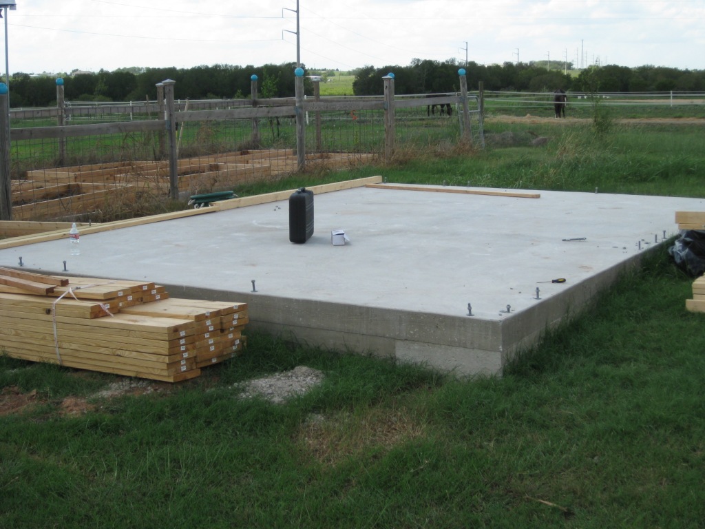

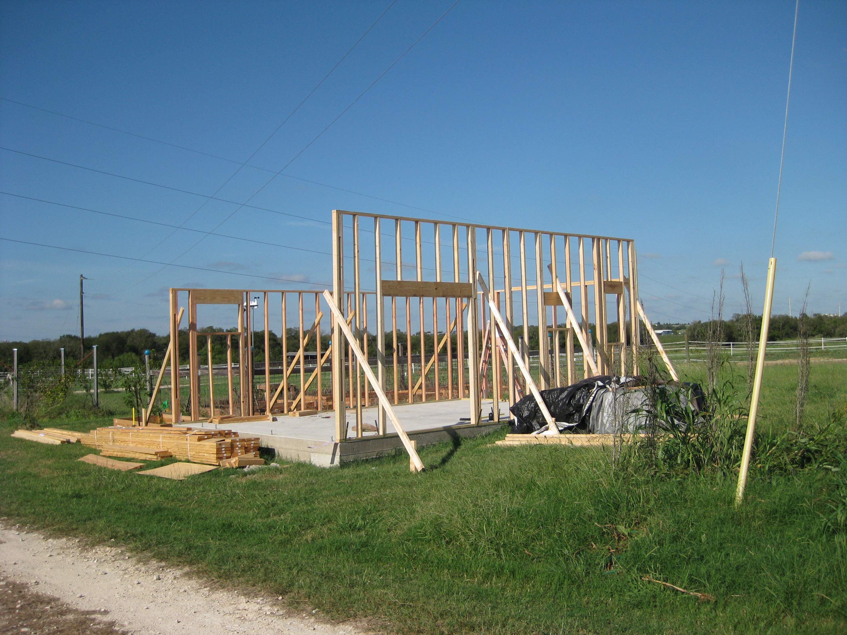

I had the pad poured in August. This week-end, my father in law and I made some progress getting it framed.
Unforunately, the pesky job is going to pull me away from it for another week

You can never build them big enough, leave room to expand.
That is going to be a sturdy building.
Is the building directly below that power line? Most power companies frown on that

Your man cave has a serious foundation! :thumbsup:

Great job ... excellent foundation. 16" o.c. both the walls and the rafters, excellent headers ... nice job and no cutting corners. I also like the straps from the foudation to the stud walls.

Yeah--it is the consequence of living on the balck land prarrie...you either do a serious foundation or plan on having the foundation crack.

Yeah I was concerned about the power lines, but the Co-Op did not have a problem with it since it is not an house or long term residence--that is until my wife kicks me out:laughing:

Nice looking building
Keep us posted on the progress

I have been taking the very conservative route on this building. The straps on the foundation are not required here, but I am putting in anyway, as well as the hurricane ties for each rafter and the 3 inch plates for the anchor bolts. All I know is that Simpson Strong-tie better send me a Christmas card this year:laughing:

What are you using for roofing?

I am going metal panels for the roof. Not only for the durability, but also I am putting a rainwater collection system for the shop and the barn--the garden is nearby.
