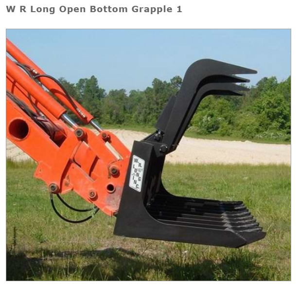

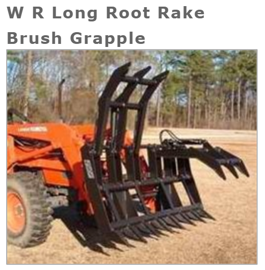

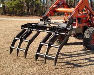

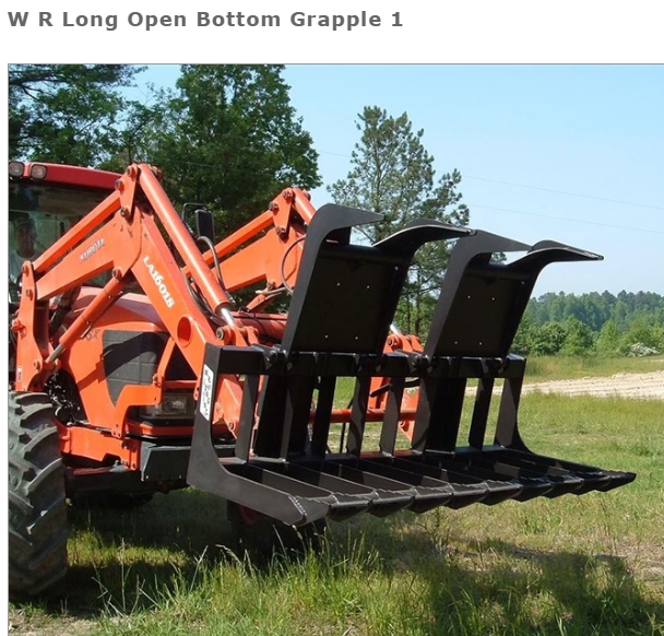

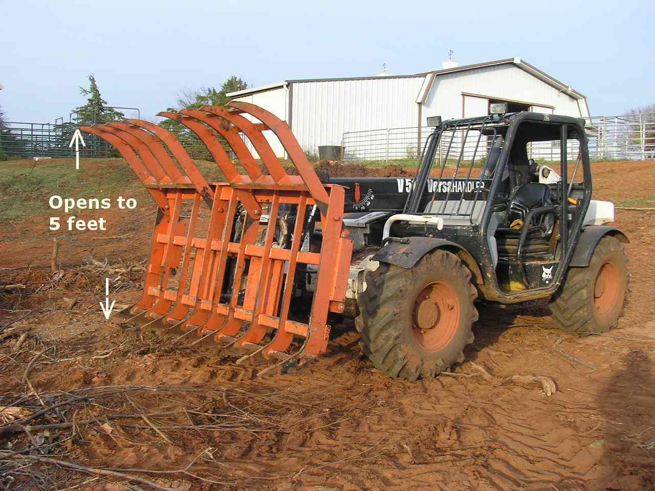

Is this what you are looking for? Root Rake Brush Grapple for compact tractors, up to full size with single lid and dual lids

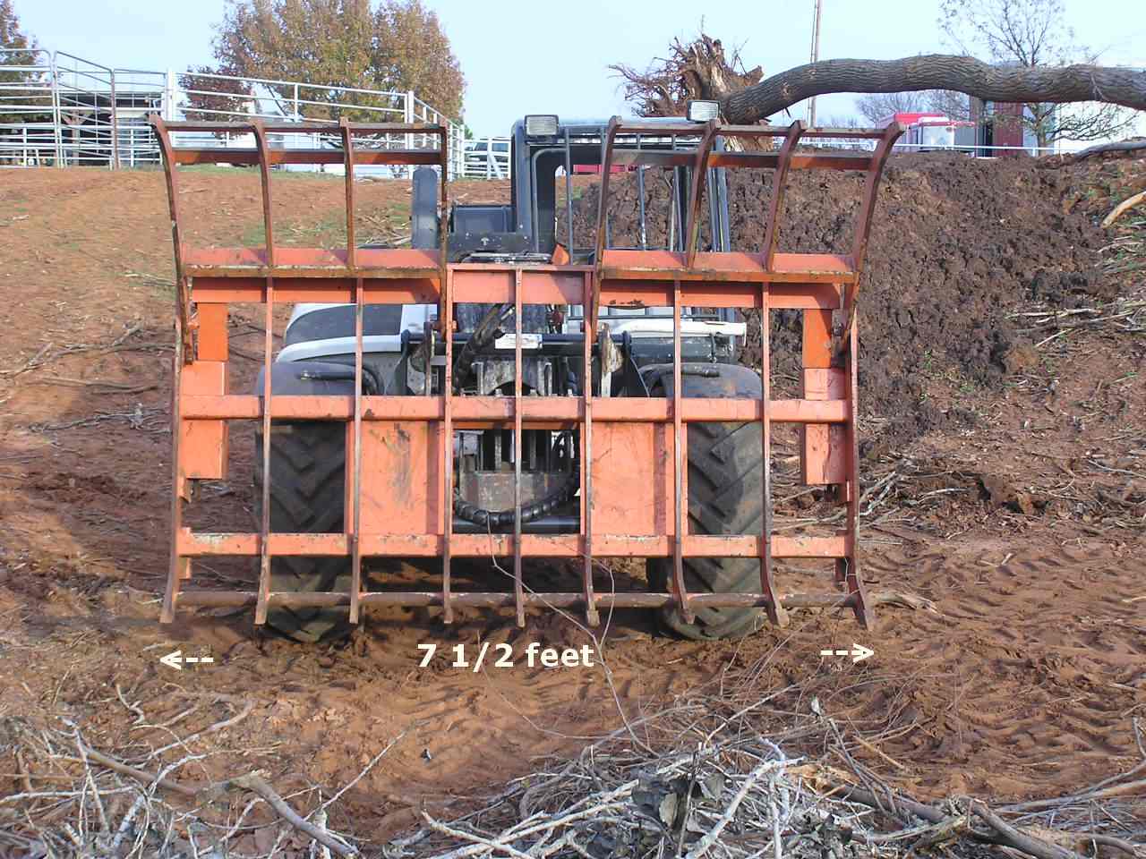

View attachment 578427View attachment 578428 This is my Land Pride SGC1560. 60" wide - 820 pounds. It is one heavy duty, tough, well built grapple. Five years and the worst I've done is chip some of the powder coat off the tips of the tines.
