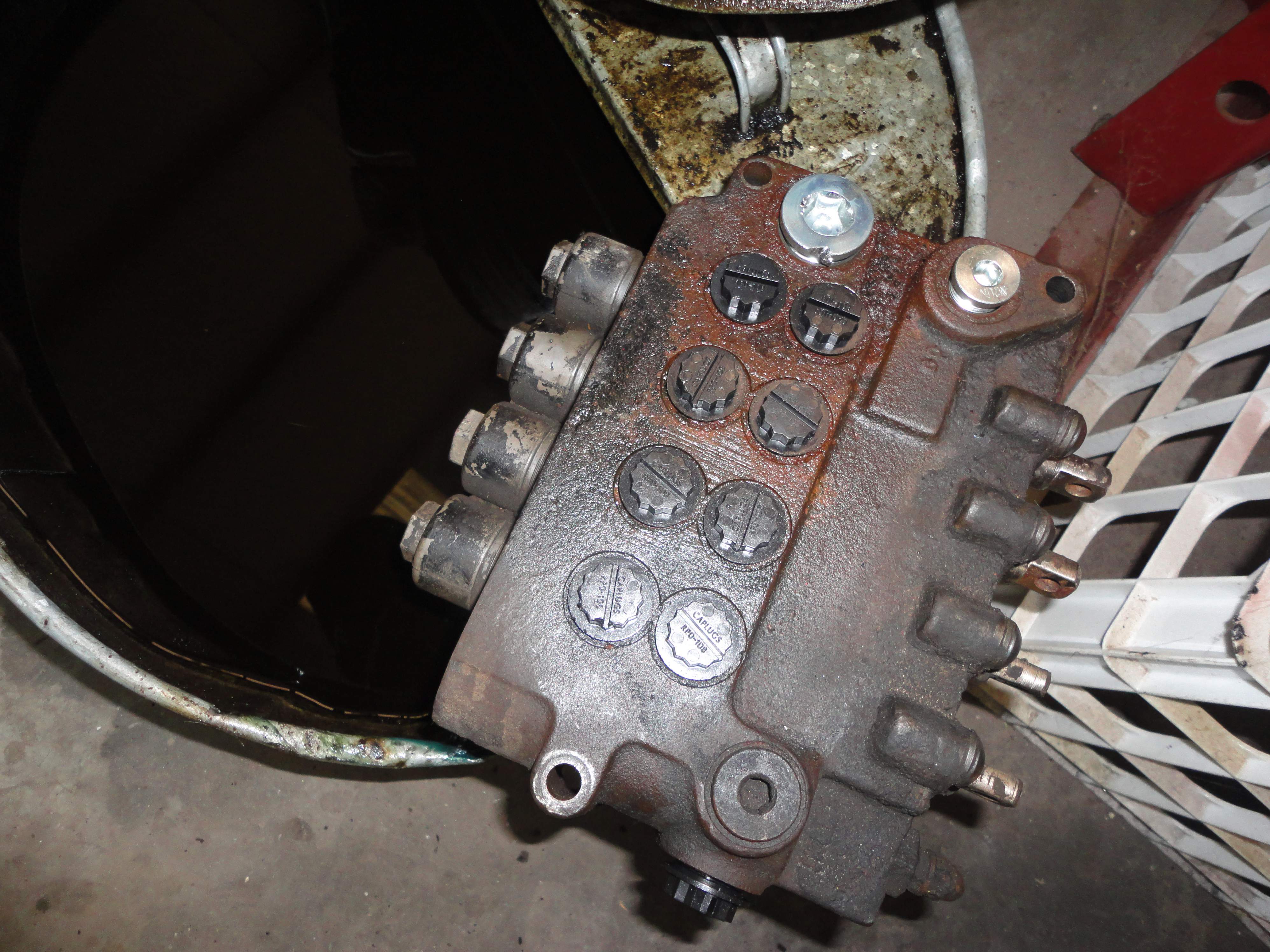

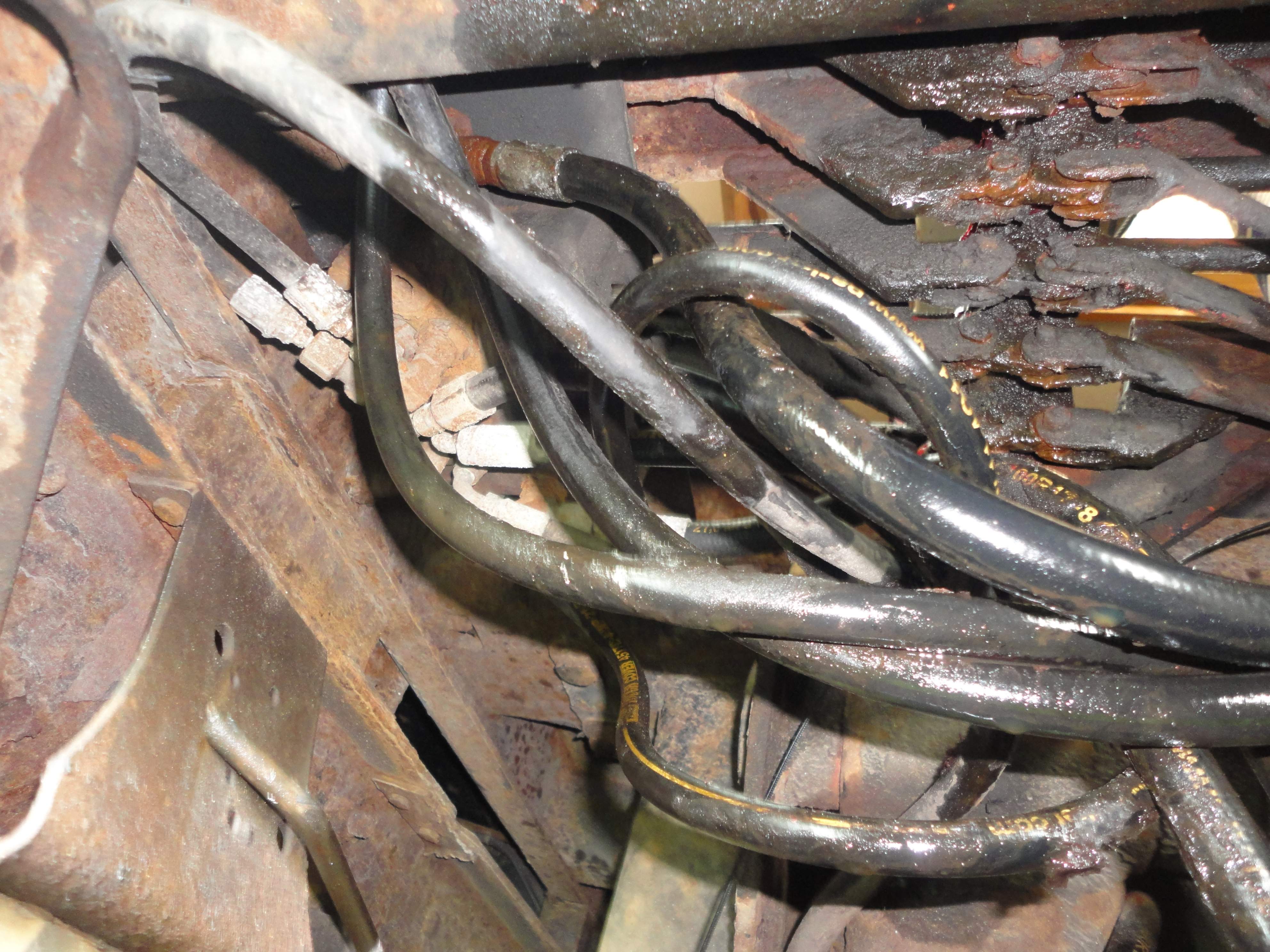

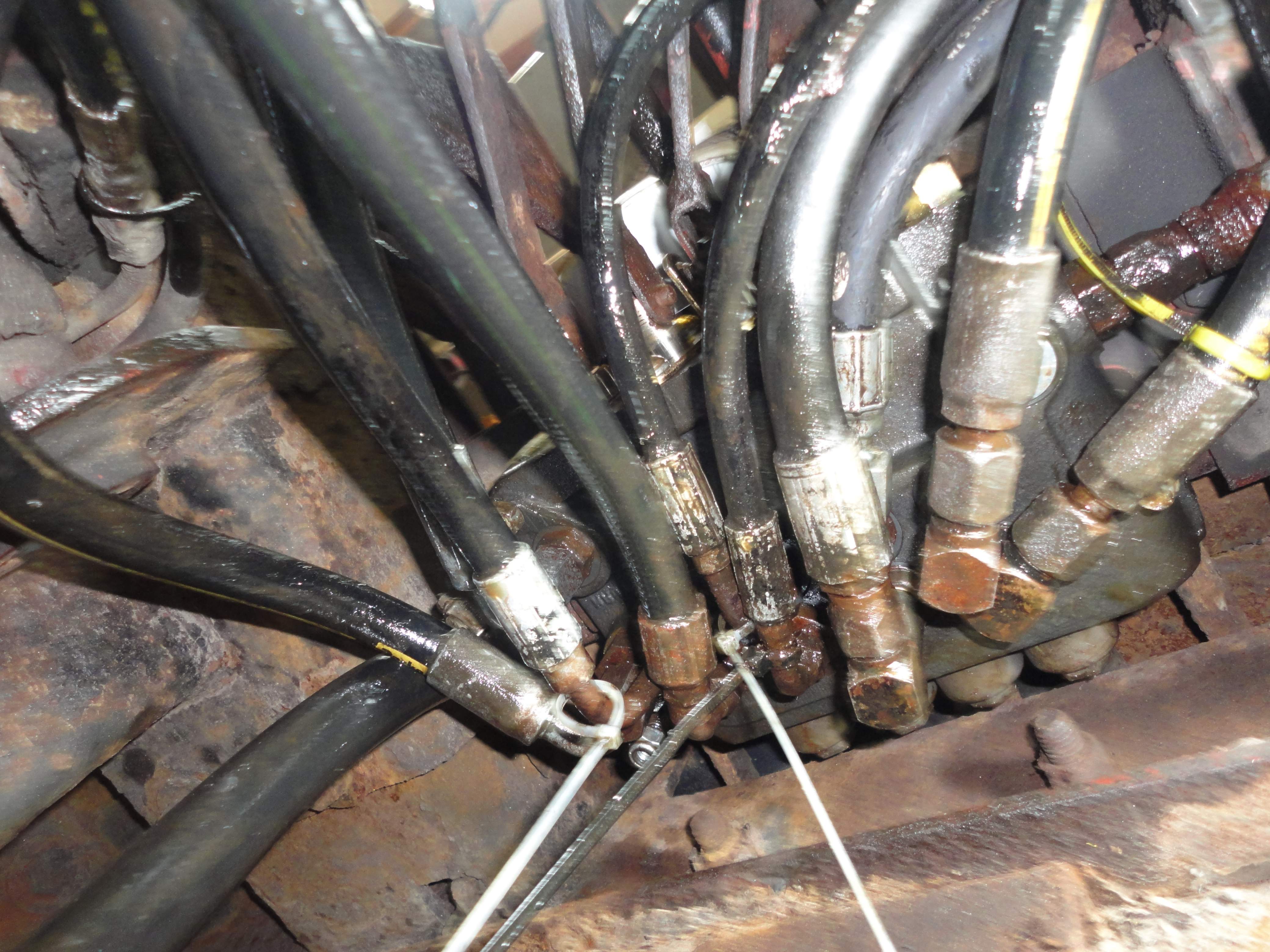

ok here are some pics not sure if you can make heads or tales out of them. i do know that the cylinders on the wheel lift has a valve to keep from droping a vehicle on the road in case you bust a hyd hose while transporting. there are 2 hoses that go to the valve body on the right side that runs the wheel lift, i have switched them around and nothing. JJ i can't use the other lines to test different sizes. DSC00463.jpgDSC00464.jpgDSC00465.jpgDSC00466.jpg
   / not a tractor but it is hyd
oh yeah the pic of the old valve body the 2 crome plugs is where the lines connect and goes to the valve body that runs the lift. the valve body i replced is identical to the old one.

It sounds as if the power beyond port isn't plumbed correctly. Maybe J_J will give his view point.
   / not a tractor but it is hyd #9
I really can't determine from the pictures that the valves have a PB port.
If the inputs and out port are connected correctly. then it is fairly simple to loosen a hose and flip the lever and see if that port is getting fluid.
If it is the same valve, then it has to be hose hookup mistake.
What ever spool does the lift, start the pump and flip the lever, fluid should flow out the work port for that spool.
The valve in the pic has a relief, so it is probably open center hyd, and the valves should be connected in series.
If the relief valve does not come on when all the levers are in neutral, you have flow to tank.
If you then move lever for a certain spool, the flow should be directed to that cyl.

i am going now to make sure the line's are right but there are only 2 line's runs from new valve to the old valve one is connected into each end of old valve. i have switched the line's over on the new valve and makes no diference. no preasure at cylinders on lift just gravity flow of fluid.
