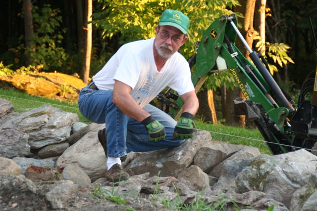

Not intended as a J.D. add, just came out like this as my Dad was snapping pic's after a long day getting close to finishing the "Hillside Retaining Wall" from projects (still can't figure out how to abbreviate the link).
Thought some might enjoy all the "Green". /forums/images/graemlins/smirk.gif

Nice gloves. Free maybe? /forums/images/graemlins/grin.gif
That the beginning of a 'great' wall?
   / Not a J.D. Add
beenthere,
Yup, free gloves, free hat, wish it were a free BH behind me too. BTW, after going through 3 pair of leather gloves, working on the wall, I pulled out the free J.D. gloves. They are actually holding up very well, working with the stone, dirt, getting muddy and drying w/o apparent damage. Pretty good gloves (especially for the price /forums/images/graemlins/smirk.gif).
Hopefully, two more afternoon's work and I can grade it off for the winter. Come Spring, we'll see if it's all still there. I never did find the $'s for a "Thumb" this year but, the FEL was indispensible for lifting the big stones and feathering them into basic position. Fine tuning then done with 6' iron and 18" pry bars. BH was too much power (or my inexperience in fine touch) for tweaking high large stones.
