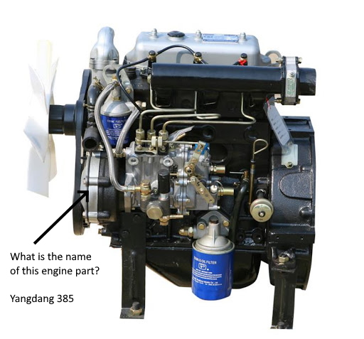

I can't figure out what the part is that has the arrow pointing to it.
The piece to the left of the gasket is bent and the previous owner filled the gap with some kind of glue.
I think this is where I'm getting air into my fuel line but I really don't know exactly what this part does.
The NorTrac manual doesn't show it.
Thanks for any help,
Steve
   / Nortrac 254 with Yangdang 385 engine question about part I cannot identify #2
The cover in the image you posted is the timing gear cover for the fuel injection pump. If you believe you are getting air in your fuel lines this is not going to be a source.
