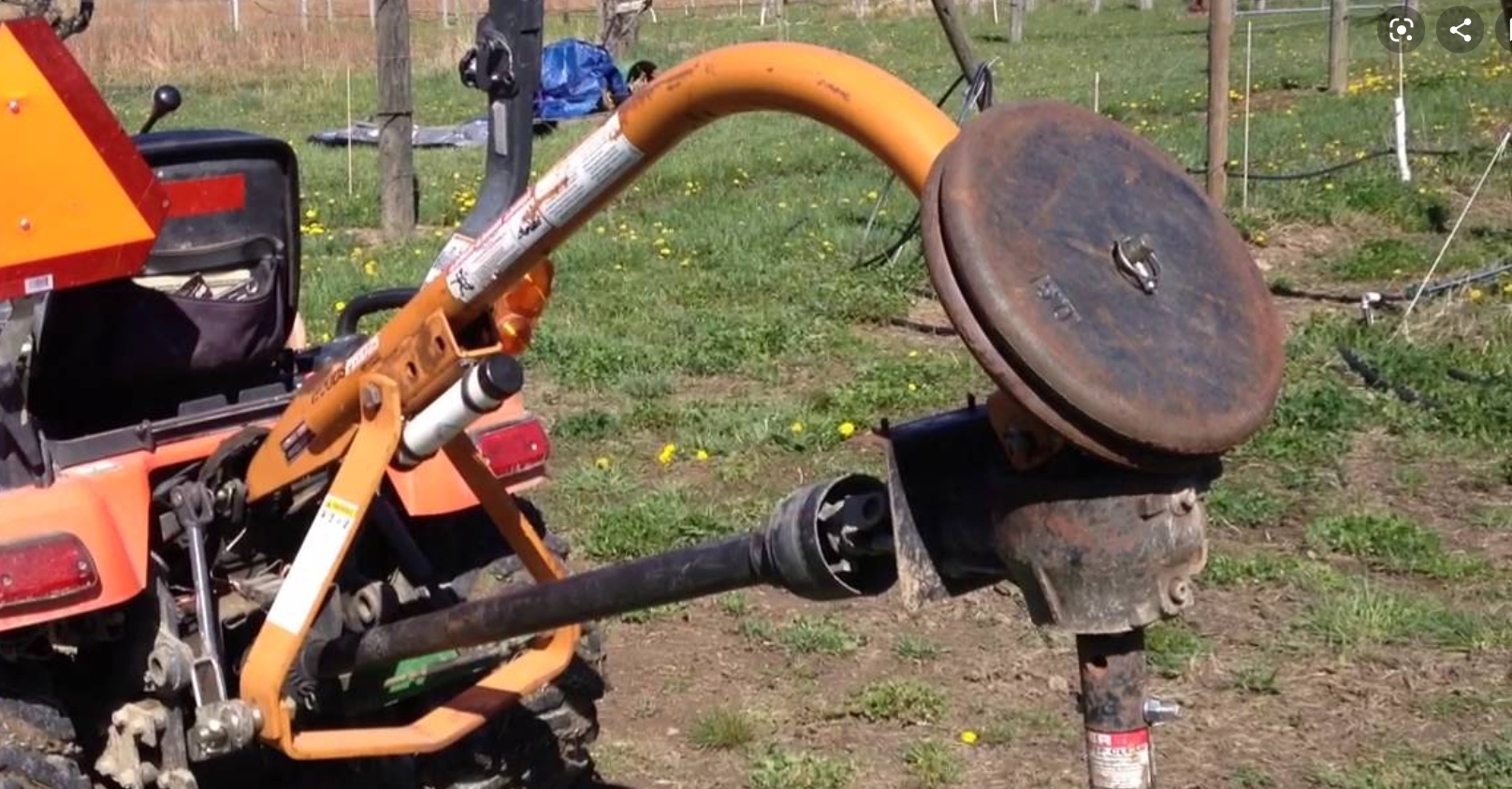

I have an old Cub wheel weight that fits perfectly on the gear head and doesn't interfere. Others use weight lifting plates. Make sure your 3 pt descend valve is open enough. Mine wouldn't cut in some conditions without the added weight. Keep the cutting edge clean from vegetation.
